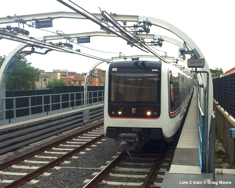

The direction things are actually seem to be going for metros are for more rigid catenary which uses a wire attached to a rail. This is basically as robust as third rail but with all the other benefits of OHLE. I've attached a picture of Rome Line C from urbanrail where you can see what this looks like - spoiler if you thinkoverhead line looks ugly you're really going to dislike this.
