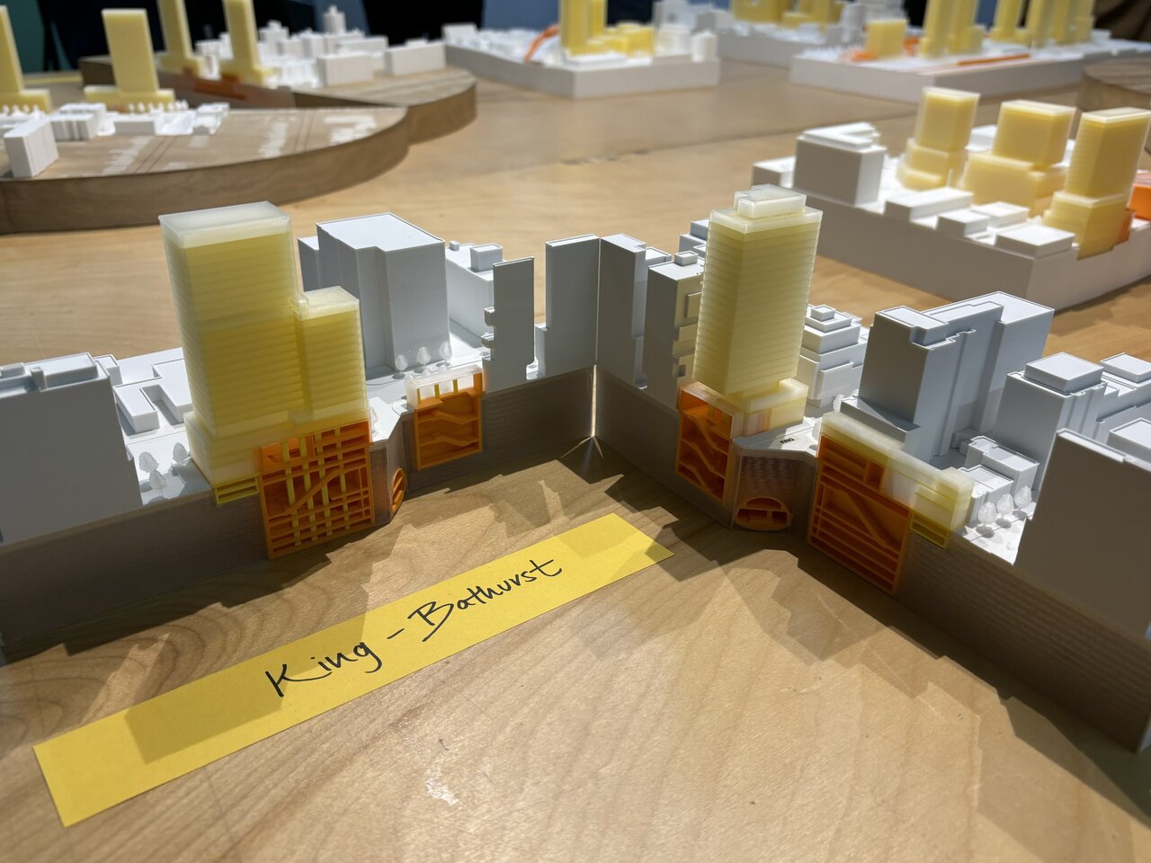

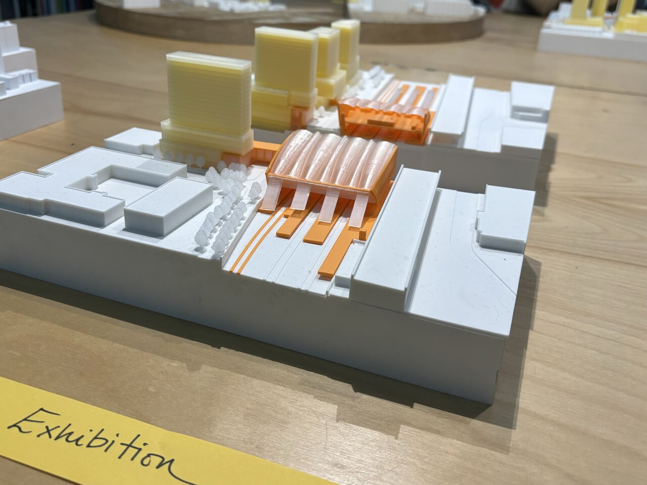

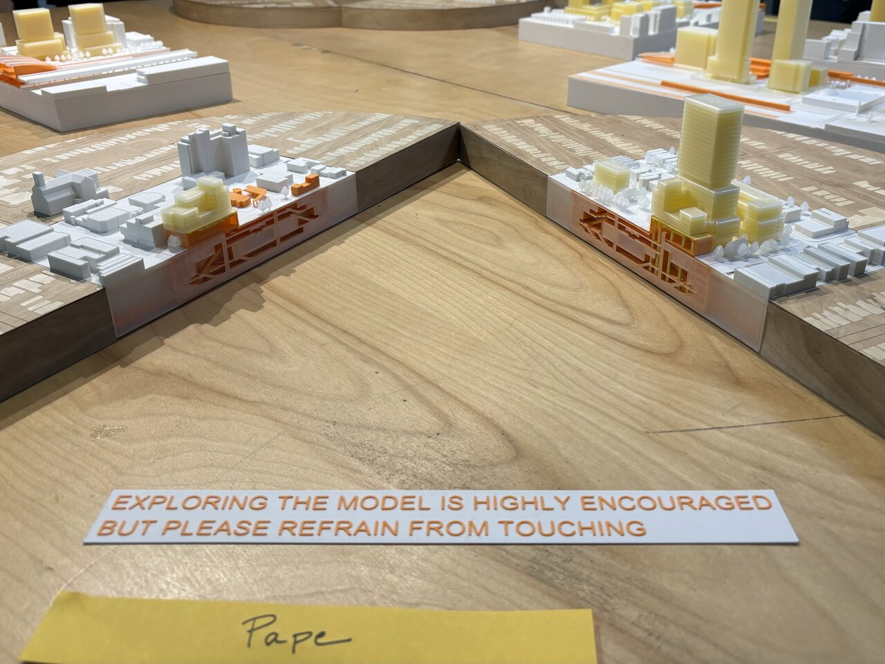

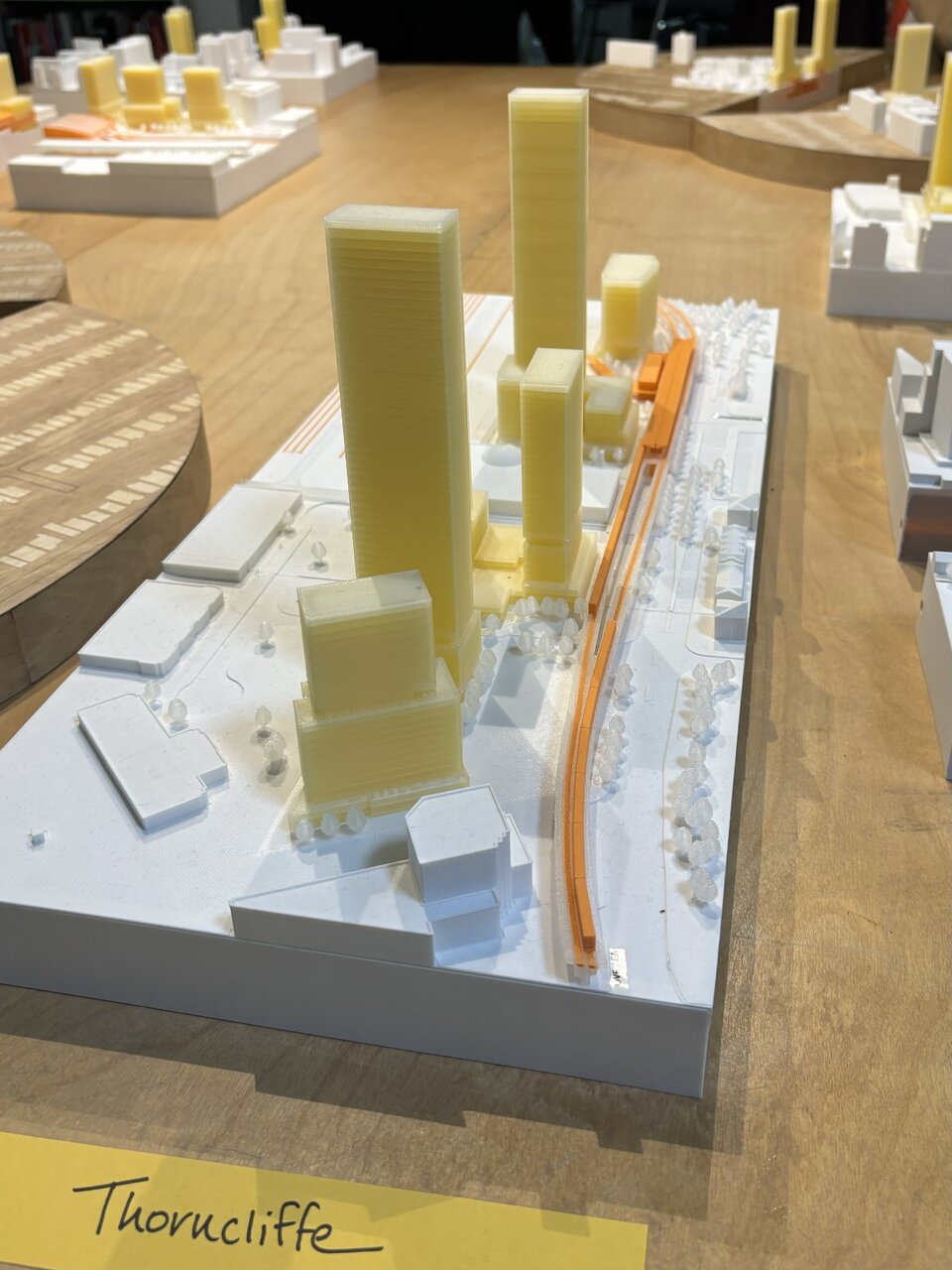

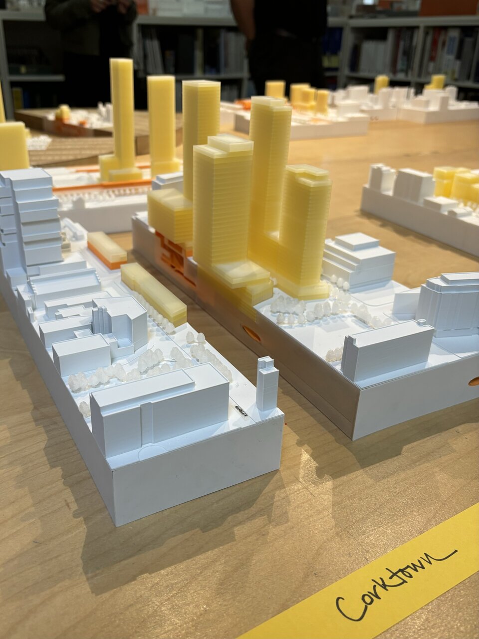

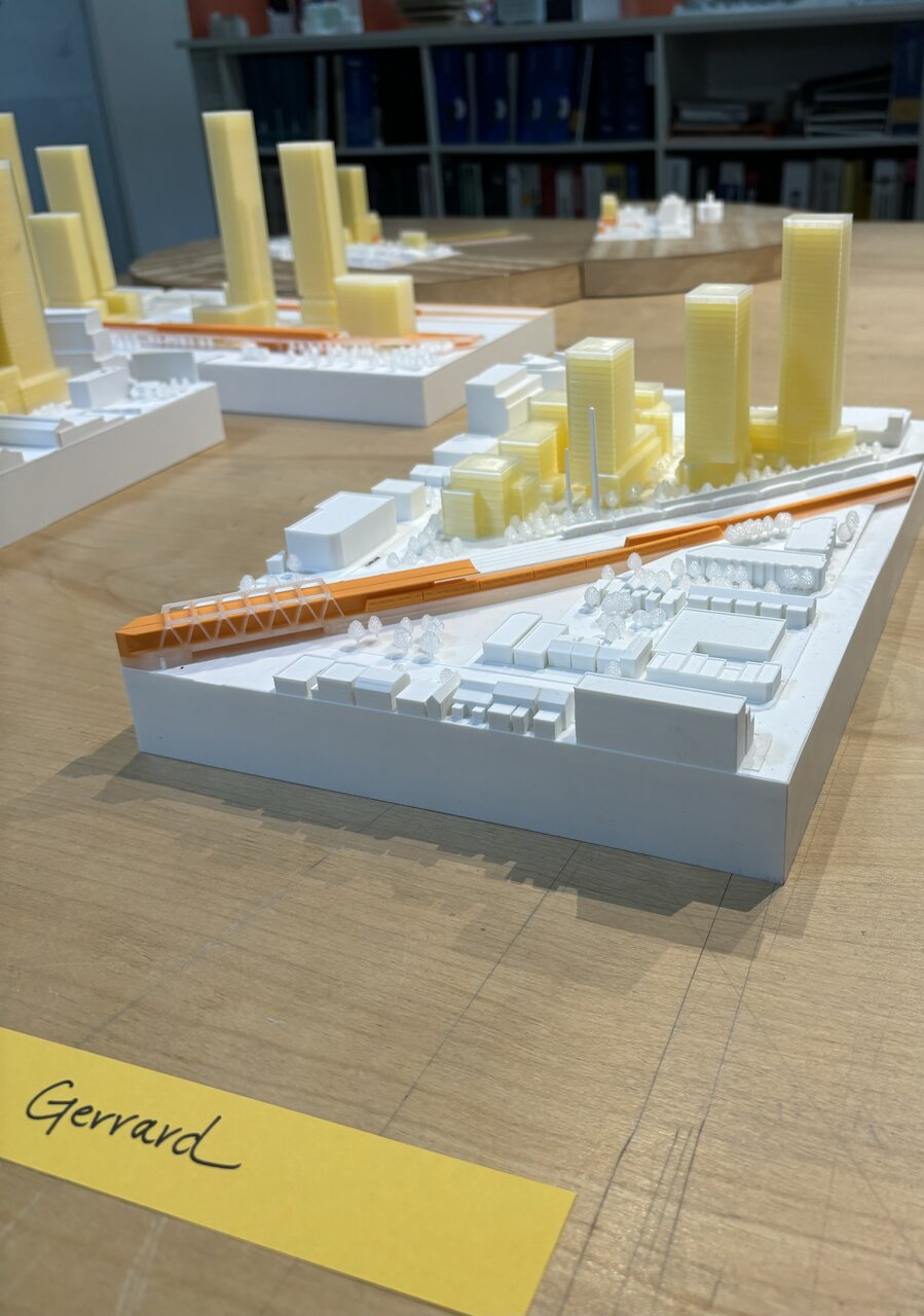

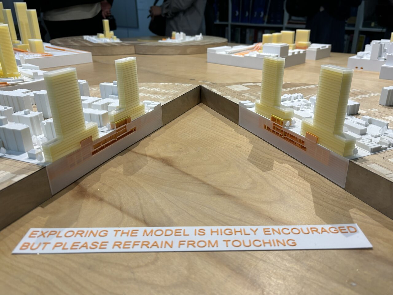

Another dump of Ontario Line content:
SvN Architects office is open for Doors Open TO, they are behind the design for many of the Ontario Line’s TOCs. They have cross-sectioned miniatures of each on display today and tomorrow along with many other projects.
Exhibition:
King-Bathurst:
Corktown:
Gerrard (South):
Pape:
Cosburn:
Thorncliffe:

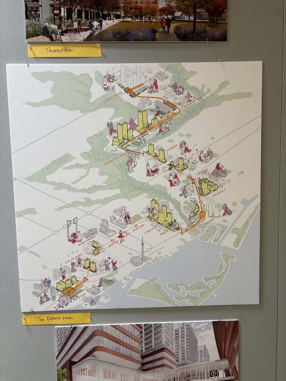

And a neat artistic depiction of the Ontario Line:
I believe they have also designed the Queen-Spadina TOC but it was not displayed.
The office is on Adelaide across from St James park in case anyone is interested tomorrow.

Yes, that's my recollection as well. Thank you too for your photos of the models along the line from Doors Open today. Really neat!
