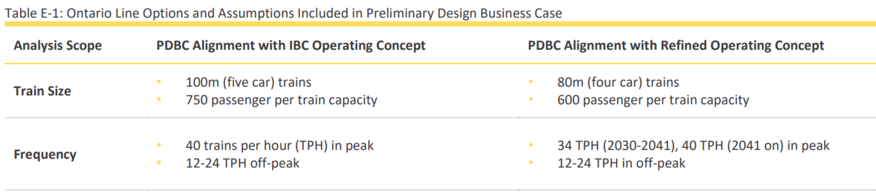

But to add some context, the 600 passengers per train number that @nfitz used is kinda sus. The number that I recall being used is 750 per train, in line with other systems that use similar rolling stock/lengths such as Rome Line C (100m long, 3m Wide Hitachi Vehicles). This gives the Ontario Line a capacity of around 30k.
Edit: To be charitable, my only guess is maybe the 600 number is assuming 80m long trains, which will likely be the initial operating length of the trains, however that's not the ultimate length the line is being built for.
Or... People can read the business case report.
600 people per 4-car train is technically true. If I remember correctly, Metrolinx is going launch the line with the "Refined Operating Concept" that has shorter 80m trains and up to 34 trains/h. But the line will be built to handle 40 5-car trains/h with a capacity of 750 people.
So the Ontario Line will launch with a capacity of up to 24,000 p/h/d but has an ultimate capacity 30,000 p/h/d once they upgrade to 5 car trains in the future.
