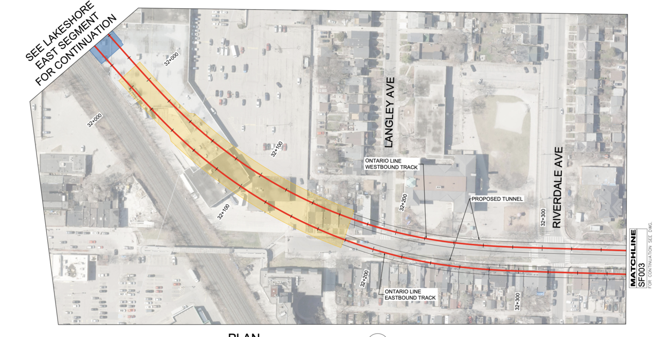

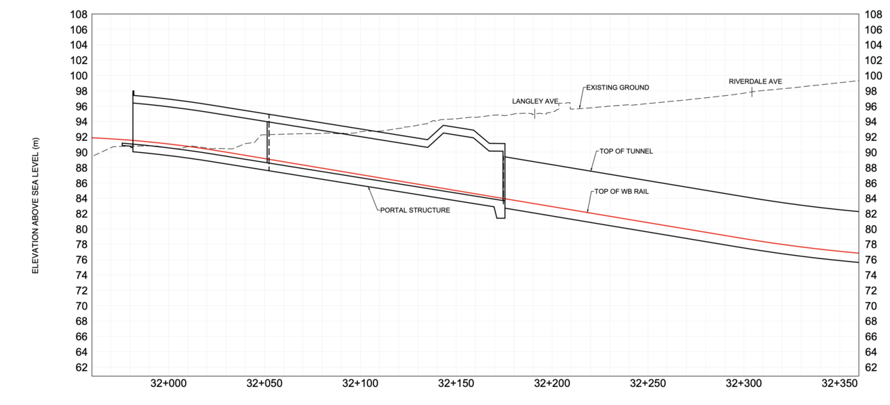

Really need a more detailed drawing. And the depths, as there's obviously some point where they are tunnelling with no issue. Here's a bit further north.

The tunnel drops quite steeply between Langley and Riverdale, while the street actually slopes northwards. One assumes that the clearance between foundations and the tunnel are just not sufficient to ensure the soil doesn't move. (figures from the Ontario Line EA Report)

yea thats around 8m depth there. I can see why they need it. They probably thought they didnt need it until the pape tunnel guys came in and told them otherwise

It's pretty clear from these maps that it wouldn't be safe for someone to be occupying those very old houses (most are +/- 100 years old) while extensive excavation is going on underneath.
