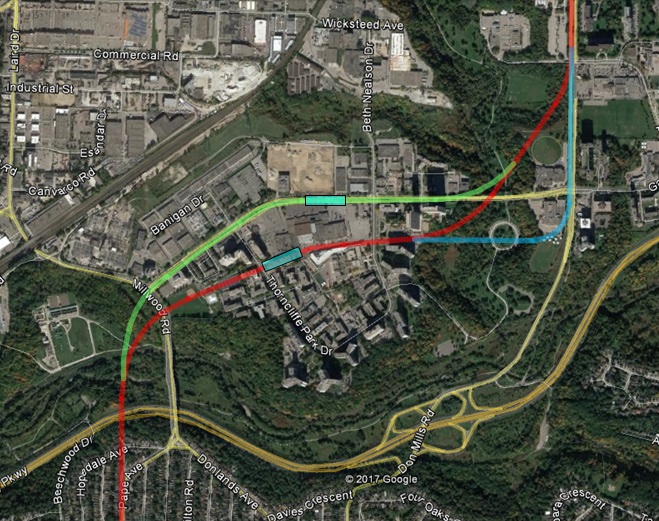

If the DRL north does follow Overlea - how is the curve from Overlea to Don Mills going to work? The curve would start at the half way point of the Don Valley if same size as DRL south's curve.
Yes, the bridge would be curved.
I quickly sketched this with 400m radius curves. In blue is 150m radius - when I was thinking that the DRL would be SkyTrain to be compatible with the Eglinton line and the Scarborough Line :). I was thinking of a slightly more southerly routing to keep the distance to station below 500m for all of Thorncliffe, but it is questionable if it can fit.
I was thinking underground track if the more southerly track - with Cut-and-cover which would be much less disruptive due to the faster construction time. If following Overlea, it may be elevated, although I think it is much easier (from a public acceptance perspective) to elevate a 90m or 100m long SkyTrain/LRT compared to a 150m subway.

Are you sure it won't look like this? Wrong type of bridge in wrong location leads to problems. You don't need a 300m clear span in the Don Valley (existing bridge has 38m spans). You don't need to maximize clearance below the bridge.
The Thorncliffe Park Stn should be oriented more towards TCP East, that's where the density is highest.
There should also be an intermediate stop in Flemingdon Park, situated in the hydro corridor along Don Mills to best be accessible to both north and south legs of Gateway Blvd. In that vane, I vote for the red line to TCP and blue line east of there.
The Blue line can only be done with SkyTrain or LRT. The 150m radius that I drew is too tight for subway.
This is a community without much political power and that definitely won't be complaining about receiving a subway station that would cut their commutes by 3/4. I wouldn't worry about public acceptance perspective.
I don't see a need to create further disturbance in the valley below. Keep the footings, rebuild the bridge deck, and cut some vehicle lanes in favour of a cycle path on this never-congested bridge. Make it truly multi-modal.
