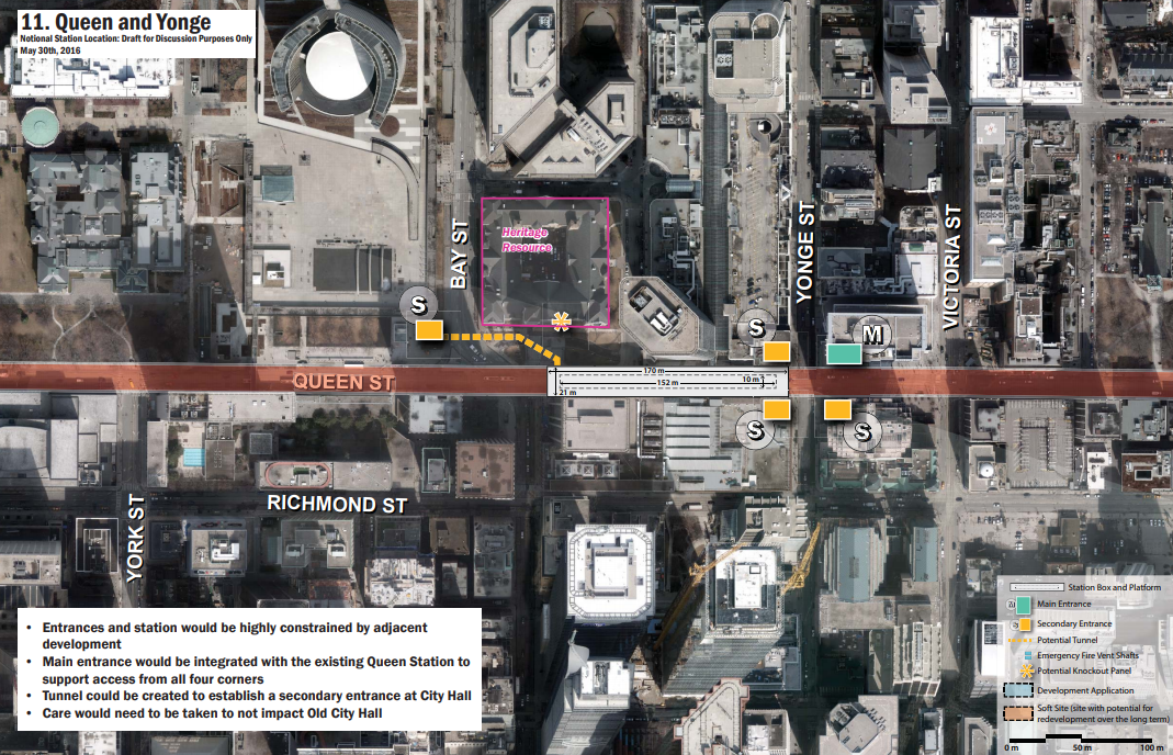

At least they've improved from this:
to this:
To their most recent iteration:
(I can't find photos of the Queen/University station box and I would really appreciate if anyone has them, but I think it also involves the station box exiting at NPS)
Eventually they might realize that not everyone wants to get to City Hall and might put the station boxes somewhere that makes transferring easier. I think there might be a subconscious bias here that the planners happen to work at City Hall and assume that everyone else wants to go there too.

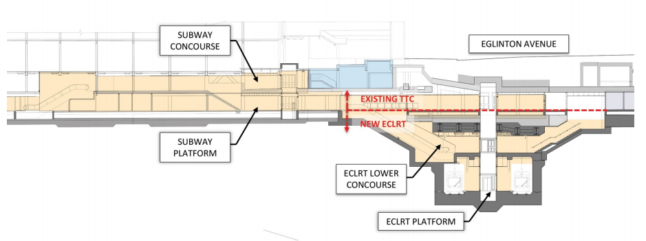

I mean, why is it that every rapid transit line interchange we build has Bloor-Yonge as their inspiration? Cedarvale, Yonge-Eglinton, and now Queen and Osgoode stations all seem to be designed to make passenger flow as much of a bottleneck as possible.

Seems like Queen and Osgoode Stations are going to have the shortest stop spacing distance from each other in the whole system, beating out Osgoode's current close relative distance from St Andrew Stn. of approximately 300 metres.
Begs the question of why we need 2 separate stations. Build 1 "city hall" station, make it connect to BOTH Osgoode and Queen.

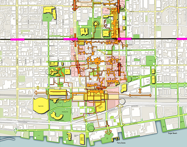

That's some scarily good progression in conceptual plans, but if a subway connection to City Hall is such a big priority, then connection Osgoode Station and Queens Station by a PATH tunnel that intersects with the current N-S PATH connection. And if bottlenecks are wanted are wanted, :D, then have them be skewed to the opposite directions, Queen to the east and Osgoode to the west, increase the station spacing.

What's causing all the trouble at Yonge/Bloor, which is the raison d'être of the DRL, is the T-junction between the Bloor and Yonge lines.
The same problem exists at Eglinton, so the Yonge subway platform was supposed to be shifted north to improve passenger flow.
But then they came out with the station designs, which end up leaving the issues unaddressed.
