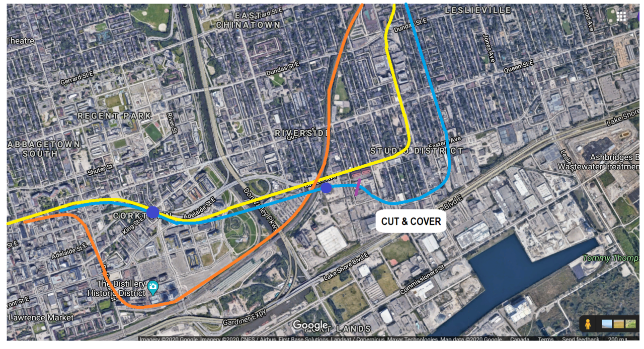

Here's what I've got for the Relief Line (Yellow), Ontario Line (Orange) and Concept Relief Line (Blue).
The bottom of that blue line appears to avoid residential - so I say continue the cut-and-cover all the way down Pape and around to the East Harbour Station (or possibly just east of it). Based on the Relief Line alignment (where I have drawing), the Carlaw Sanitary Sewer is 12m deep. Hopefully, the blue line can pass over it. Then you simply start the TBM from East Harbour and go westward. This adds about 1km to the TBM length, and 1 emergency exit. But it keeps all construction underground. If you are going to add the extra distance and extra curves to avoid residences @ Eastern/Pape, why not just keep everyone happy.

This Preliminary Ontario Line (POL) seems to acknowledge the benefits of building Pape with cut-and-cover. It also recognizes that the Carlaw jog forces the line so deep under that Sanitary sewer (on Carlaw) that it precludes cut-and-cover all the way to Mortimer, which makes the Gerrard and Pape stations, plus the Wye, much more expensive.
Maybe just eliminating the Carlaw jog would have been enough to all the tunnel depth to be greatly reduced, but swinging down and building over a field (after factories demolished) will allow the line to be as shallow as possible (vs. being under Eastern Ave.) to more easily accomplish this.
I think the orange line for the Ontario Line will likely go under Berkeley instead of Parliament. They are doing soil testing under Berkeley.
