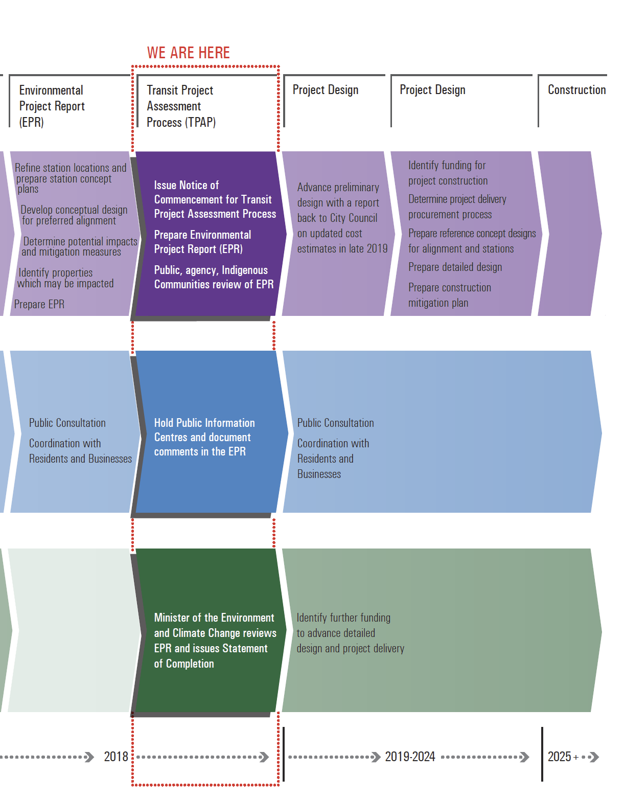

I was clearing my downloads folder on my laptop (as per quarantine induced boredom) and stumbled upon this timeline for the Relief Line.
Really goes to show how much we dropped the ball on the Relief Line. Construction phase pushed out to 2025? I don't think I fully grasped how disappointing that was back in April 2018 when this document was released.
