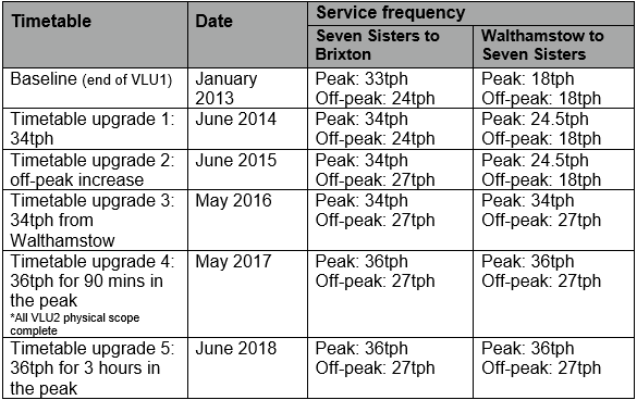

60-year-old lines have been retrofitted to allow for trains every 100 seconds in London. New build lines can easily be built for 90-second headways. I'm not going to write it all over again. I'm linking my old explanation below...
The more flexible and slightly cheaper tech that will be used for the Ontario Line will make it easier to extend the line in the future.( e.g. at grade and elevated in the suburbs Vancouver-style) And dont keep repeating that the capacity will be too low for that. It is not. The capacity for the system (20k on launch, 34K at max frequency) will be higher than what's scheduled for the Bloor line (26K PPHPD now, 33K with signal upgrades). This new line is only 15km which is almost half the Bloor line's length.
I don't want to hear how 90s frequencies are impossible. The half a century old Victoria Line in London can consistently run at 100s/36 trains per hour during the 3h rush hour windows in the morning and evening. Vancouver can also (and does sometimes) go under 90s (to almost 70s in recovery mode) when they have enough trains. and that is all without platform screen doors!
I'm looking forward to automating out TTC's procedurally lax performance standards. It's time for Toronto to get modern metro system.
More about the Victoria Line: THE NINETY SECOND RAILWAY: MAKING THE VICTORIA THE MOST FREQUENT METRO IN THE WORLD

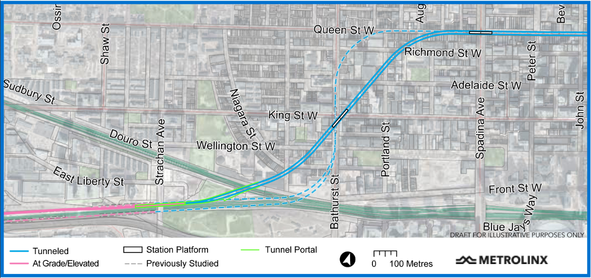

Why do the tracks come above ground and stop right before Dufferin? That would effectively make any kind of westwards expansion impossible. There will be a need for another north-south line to connect here, guaranteed.
The line is stated as being "at-grade" there - at the same level as the GO tracks.
At that point Dufferin is on a bridge over those GO tracks so there would be clearance for Ontario Line trains too.
However, that bridge would probably have to be rebuilt to widen the railway underpass if the Ontario Line were extended to the west.
Glad to see they got rid of the previous concept of "straddling the GO line" with one-way elevated guideways at Exhbition
(shown by the "previously studied" dashed lines).
I'm surprised that Exhibition station is at grade (as opposed to elevated which would allow easier circulation in the station area),
but I suppose that if there is already an underpass for the Go line access, they would piggyback on the use of that for this station as well.
Locations of Exhibition Station, the tunnel portal, King/Bathurst and Queen/Spadina.
