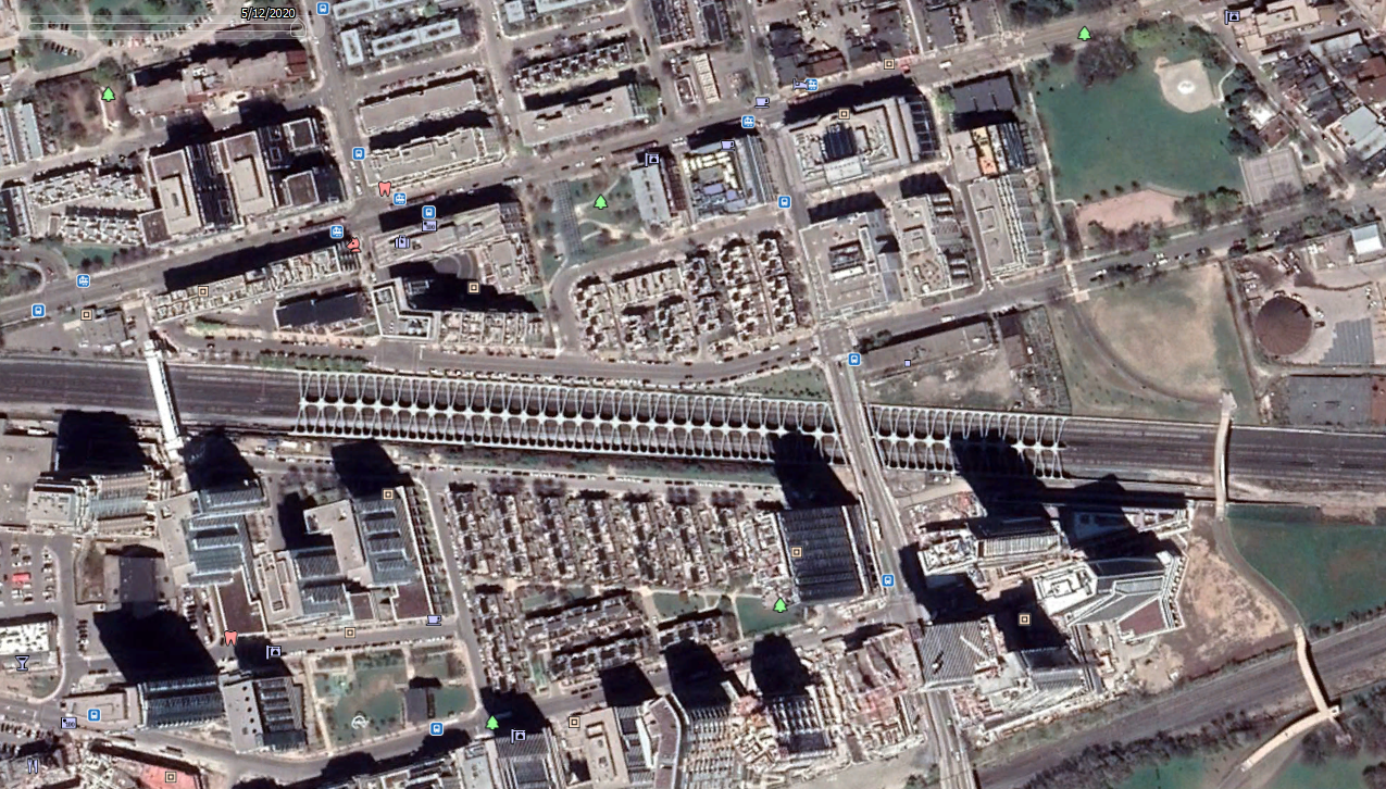

If I had more time (and maybe I'll get to this), I would try to use Google Maps' satellite view to map out the lines on the track plan images that were released this week. The challenge is that the satellite view hasn't been updated in several months or years so it doesn't show the current view of Garrison Crossing/Ordinance Park. Any one know of a more updated satellite view than Google's? Anyone have an interest in doing this? :D
Google Earth has great May 12, 2020 imagery for downtown Toronto.

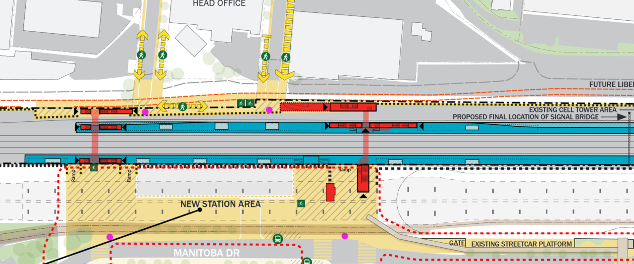

Let's also not forget that Metrolinx already has an expansion plan for Exhibition GO from 2018 that is more or less ready to go.
This design allocates space for an additional north-side track for "future use", but there probably isn't enough space for that, two OL tracks, an OL platform, and "Liberty New Street".... not unless the city & province are willing to partly demolish 1 Atlantic Avenue. (It's not a heritage property, and it's hardly irreplacable, so that's not out of the question, IMO.)

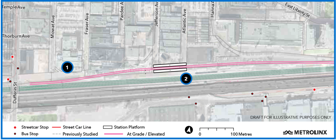

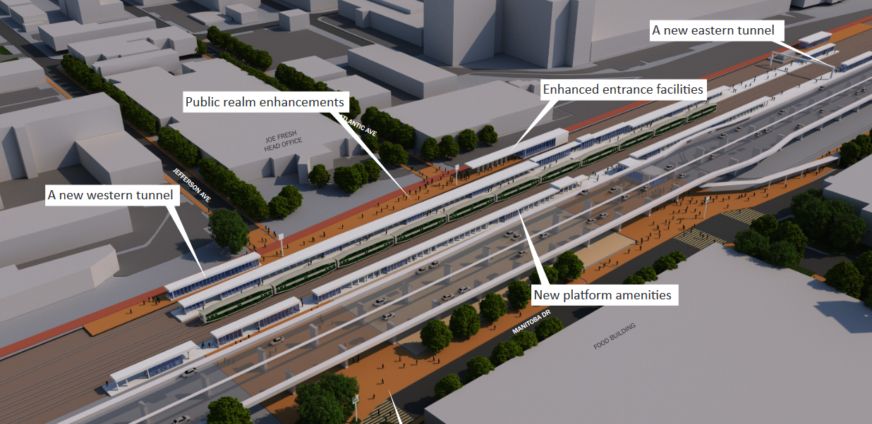

The OL Exchibition Station is supposed to be on the lot just below the Joe Fresh Head Office, so that'll make use of the new GO underpasses, but the entrances will have to be shifted to the north to clear the westbound OL track.
The odd think about the Exhibition Station diagram is that it is shown with outside platforms.
Normally terminus stations - even temporary ones - have centre platforms so passengers can load to either track.
I suppose they could just always use the north platform for incoming and outgoing trains which would provide easier access from Liberty Village (no need to use the underpass) since people from The Ex will always have to use the underpass anyways to walk under the GO tracks. But once the frequency get higher, they'll need to use the tail track to reverse and use both platforms.
Locations of Exhibition Station, ....
