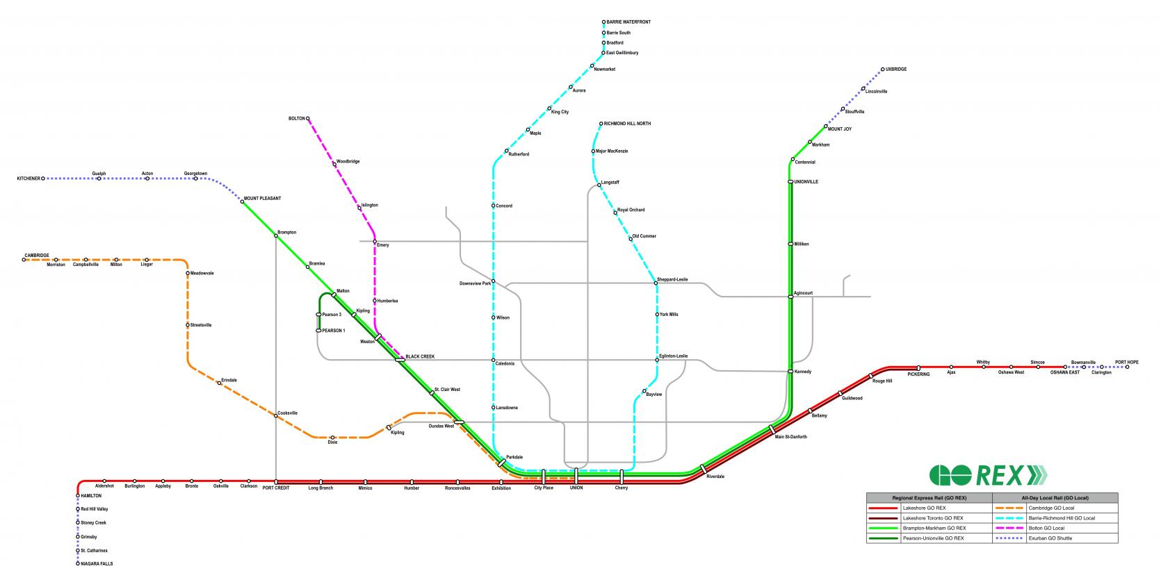

Hey gweed123, that a very impressive map, congrats.
What I do not quite understand is what is the difference between GO REX and the current GO rail commuter lines? Are you proposing that all GO REX be part of the standard subway system with standard subway fares? If so I'm all for it!
Thank you!
What I'm proposing is that GO REX be much like the Berlin S-Bahn. It would be integrated with the subway system, but technically be a separate system (much like the S-Bahn and U-Bahn are interdependent, but are technically separate systems). The non-electrified lines would run either hourly or 30 min service, in the same format as the current GO lines.
Ideally, off-peak GO REX would run 15 min service on each of the 4 lines (Lakeshore, Lakeshore Short Turn, Brampton-Markham, Pearson-Scarborough). That would mean a combined 7.5 min service within the City of Toronto, which is nearly subway level service. In the 905, it would be 15 minute service, which is really all the 905 needs. It would perform a commuter rail function in the 905, and an express subway function in the 416.
Obviously, peak frequencies will be increased so that it would be roughly equivalent to off-peak subway level service.
I will make a new map showing the '2nd Terminal' and how that would look within the downtown system.
Another thing I considered last night is this: If the GO tunnel is built underneath Queen St, it may make sense to build it as a 4-track subway, with the outer 2 tracks being GO REX, and the inner 2 tracks being LRT. That way you can have express and local rapid transit along the same corridor. The local tunnels may extend a bit beyond the GO REX tunnels, but for the enormous cost of tunnelling, it would be nice to get a Queen LRT out of the deal as well (becoming the Waterfront West LRT in the west end).
Yes I'd love for the TTC to approach metrolinx if they ever end up building the queen go tunnel, and get a streetcar tunnel built for the busy part of queen. The streetcar tracks would likely be best for the outside tracks mind you because they would have much more frequent stops.
I figured that the 'local' stations would be a centre island platform with the LRT on either side, and then the GO on the outside of that. For 'express' stops, it would be two island platforms, with LRT on the inside and GO on the outside.
But yes, it certainly does make sense to add an LRT tunnel to whatever Queen tunnel is built. I have no doubt it would be more expensive than just a GO tunnel, but would certainly be significantly less expensive than building both of them independently on separate corridors.
Interesting idea. With my GO REX scheme, it may be possible to do this (NOTE: This map does not include the 'diversion' described below):
Notice how I have the 'short turn' routes that run an abbreviated version of the full route. It may be possible to route all of those short turn routes into a tunnel under King, Queen, or Dundas Sts. The short turn routes would diverge and reconnect to the main Union-bound routes at Bathurst and Riverdale, respectively.
This would in effect route every 2nd train away from Union, while still:
1) Maintaining frequency on the outer parts of the line (in the outer 416 and inner 905)
2) Still have every route serving Union in one form or another.
3) Create a second satellite main station somewhere within downtown, thereby increasing travel options and distributing the load.
Under this scheme, nobody would be 'forced' away from Union, as every station on the overlapping parts of the line (where the short turn and full routes are interlined) would be serviced by routes bound for both main stations, aside from the stops immediately adjacent to downtown.
