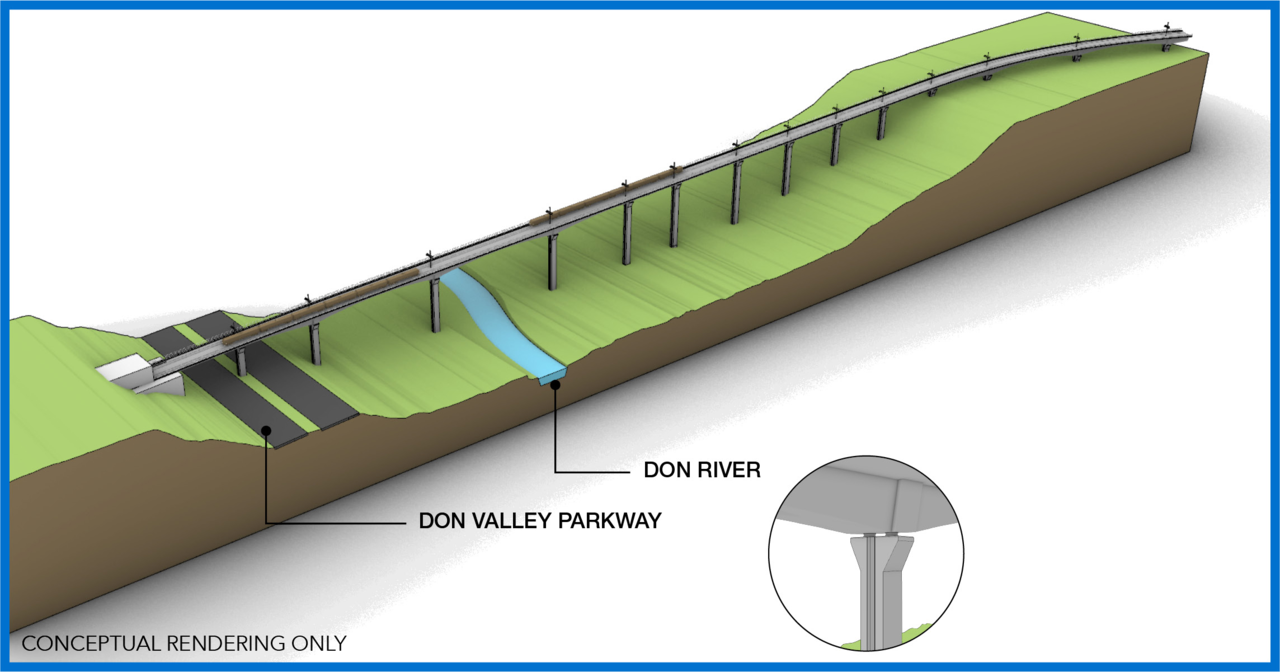

Based on renderings, Metrolinx hints at catenary use for the Ontario Line. Make of that what you will.

As mentioned above, the early designs for the elevated portions showed overhead catenaries. If they went with that, probably won't be the exact same trains as REM (after all, this line won't open for another 8-10 years probably).
However for tunneling it's less than ideal. Most of the underground sections of REM are already existing commuter rail tunnels. I think the only section of new tunnel is under Dorval airport. OL's tunnels will be entirely new tunnels! Boring wider tunnels to accommodate overhead power is expensive.
Then again, Sydney Metro ended up using the same exact trains as REM despite currently boring *entirely new metro tunnels* through the harbour, CBD and southwest Sydney. So I honestly don't know what they will choose, lol. It seems that the type of train REM uses is very popular around the world for new lines, even lines with extensive underground sections.
