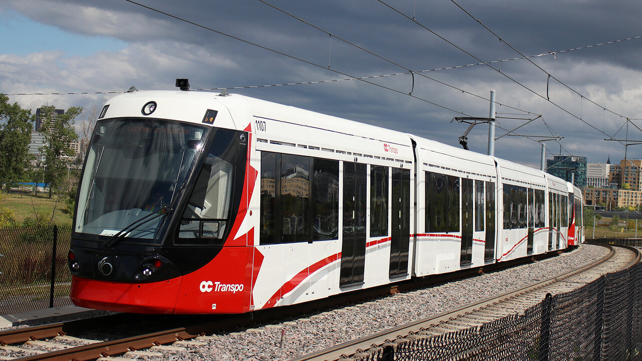

If the line is catenary powered they (Metrolinx) might as well just choose the Alstom Citadis Spirit instead of they really wanted to save money, those trains have a maximum speed of 105km/h and can be configured as long as 60m
That's a tram/streetcar/light rail vehicle that'll probably wibble-wobble sideways at higher speeds/around bends... exactly what you don't want from a ride quality POV.

Also low floor, which means circulation in the train is slower and fewer doors--great for lower capacity/lower cost systems without full grade separation. Anything fully grade separated should be high floor.
Why would they consider a low-flow vehicle for a completely grade-separated line that's going to be stretched on capacity? You'd need longer platforms with narrow and more limited low-floor vehicles.

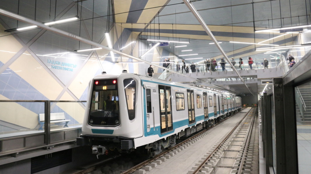

All these examples use 3rd rail though. OL will be pantograph
All of the 'generic models' have used pantographs in other cities - Alstom Metropolis in Sydney or the Singapore North-East line, Siemens Inspiro in Sofia, and the Hitachi Driverless Metro in Rome.
Note the use of a solid conductor overhead rail here in Sofia - very common in tunnels these days.
