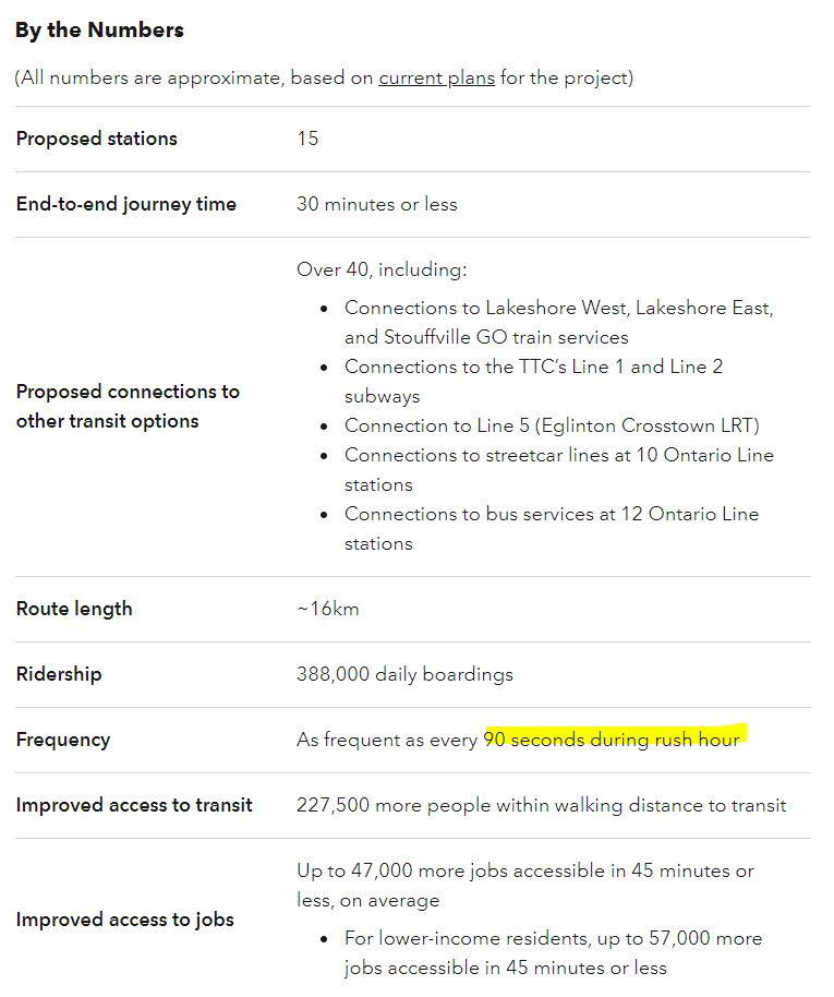

I mean, according to the Ontario Line website by Metrolinx, they are expecting to use 90 minute headways during peak time. Source: Metrolinx: Ontario Line

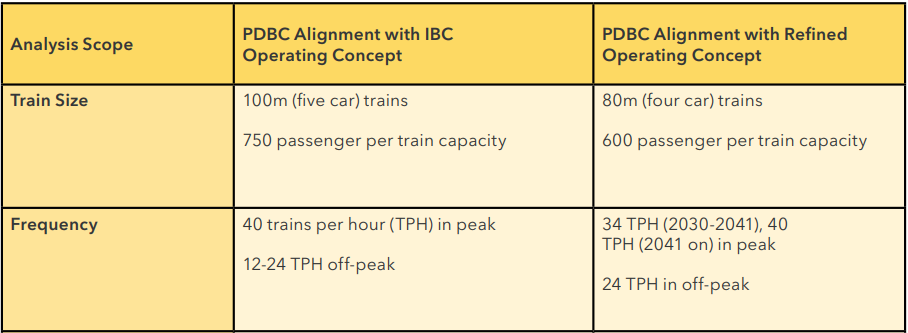

I think the above numbers are for 2041 based on the Ontario Line Preliminary Design Business Case Summary document. Meaning they are already at expecting to be at capacity on the Ontario Line by 2041, unless you know of a method to decrease headways even more from 90 seconds. Additionally, the stations are built 100 m long to fit 80 m long trains at 600 capacity. Even if we increased it to 100 m long trains with 750 capacity, you're only increasing capacity from 24,000 to 30,000 pphpd. An increase of a paltry 25%.

As you have said, the Ontario Line at 750 capacity * 40TPH gives 30k PPHPD.
If we use your 1458 passengers per train, Line 1 at a headway of every 3 minutes (what it was pre ATC) had a capacity of 29360 PPHPD. In other words, what I said is correct, please try to actually do your math correctly.
