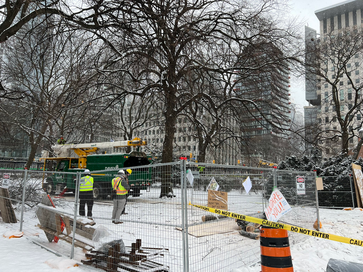

Is there an arborist's report (or some other official study) that confirms all of the trees to be cut down are 200+ years old?
I don't ask to cause trouble but I've never seen anyone mention a report, just the media repeating that some people say the trees are that old.
The tree rings in the truck are the exact identifier of age.
While you can take a core sample from a living tree, potentially, its not very nice to the tree and does pose a risk of killing it. It would, otherwise, be a guess, based on a species typical rate of growth and the size of the specimen.
Obviously you can gather other evidence ( A planting record, and photographs). I commented on a photo of the trees awhile back, I'll see if I can't dig that up.

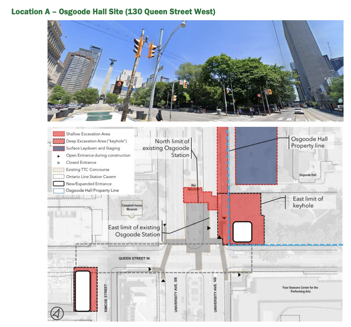

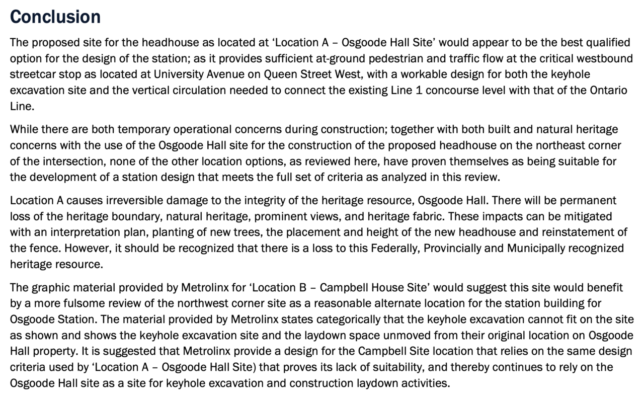

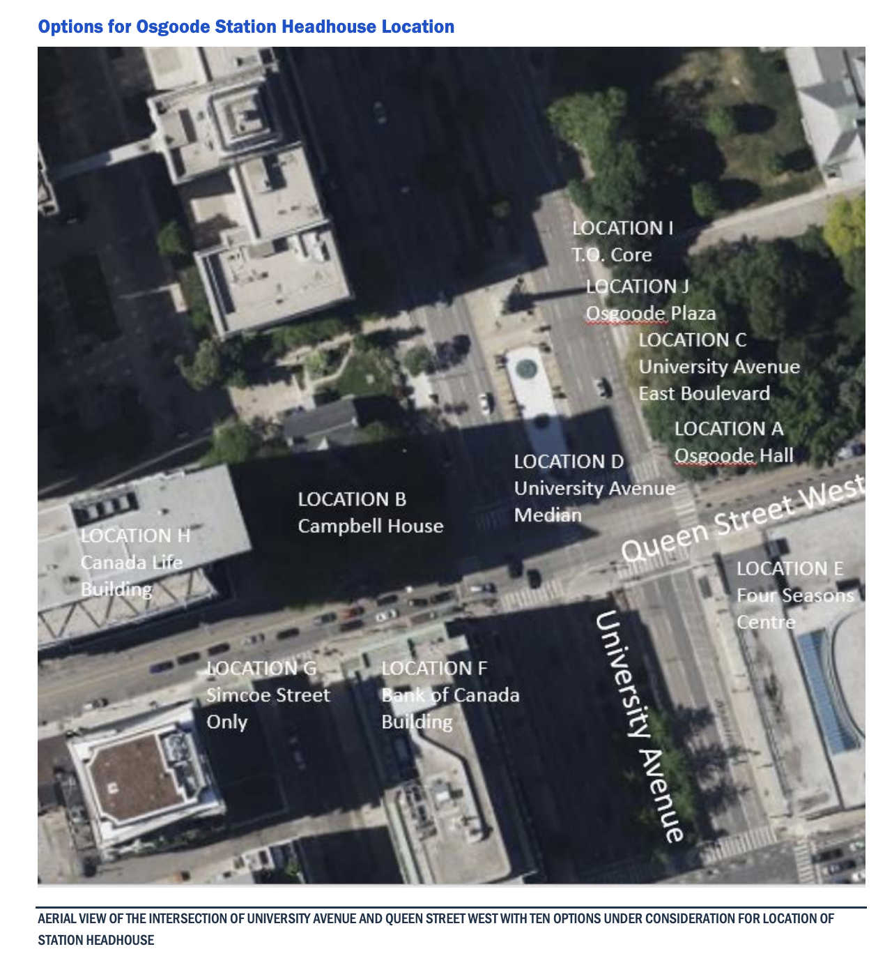

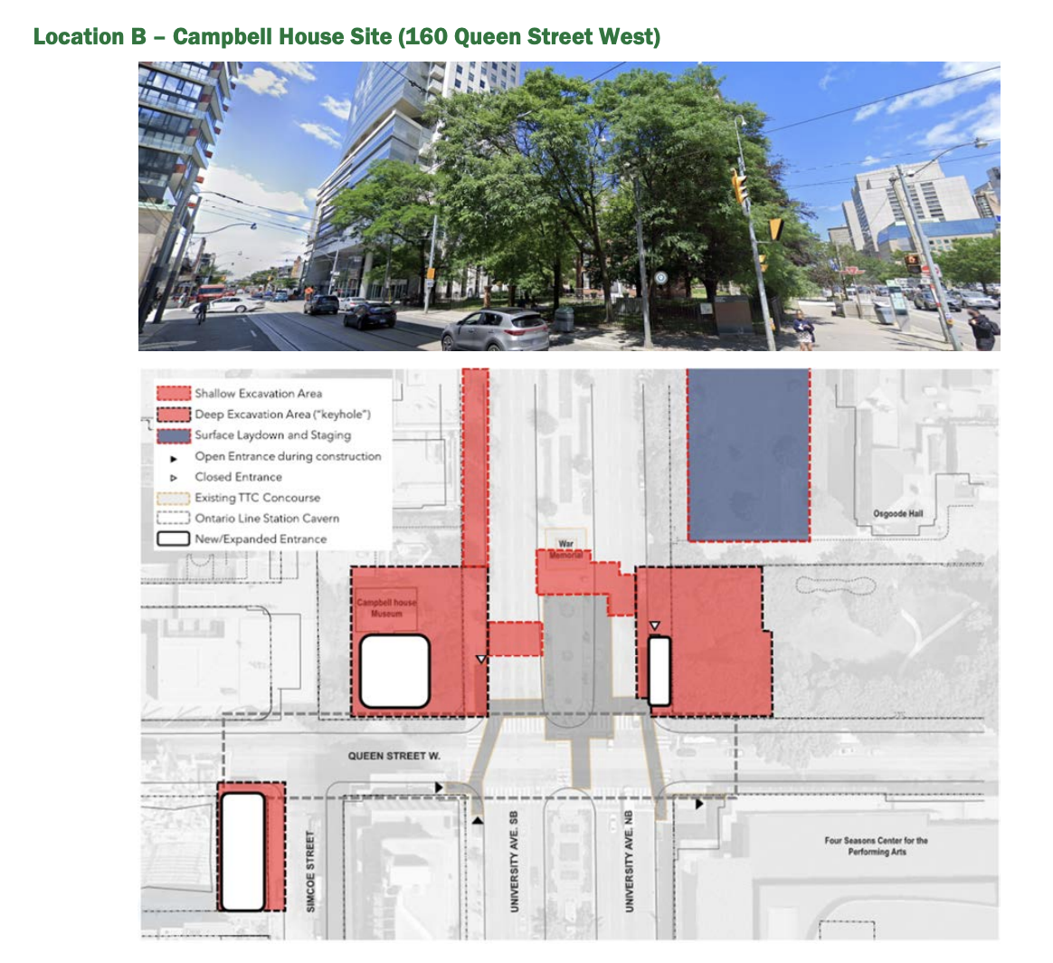

Heres a report from the city on various options for construction. They almost all involve cutting down those trees because the station Entrance is not the only thing that has to be accomplished here. To construct the new station cavern, ML will need a mineshaft. And unless ML is going to be tearing down some of the nearby buildings there is no other open space for them to do this keyhole digging in. University park or not.

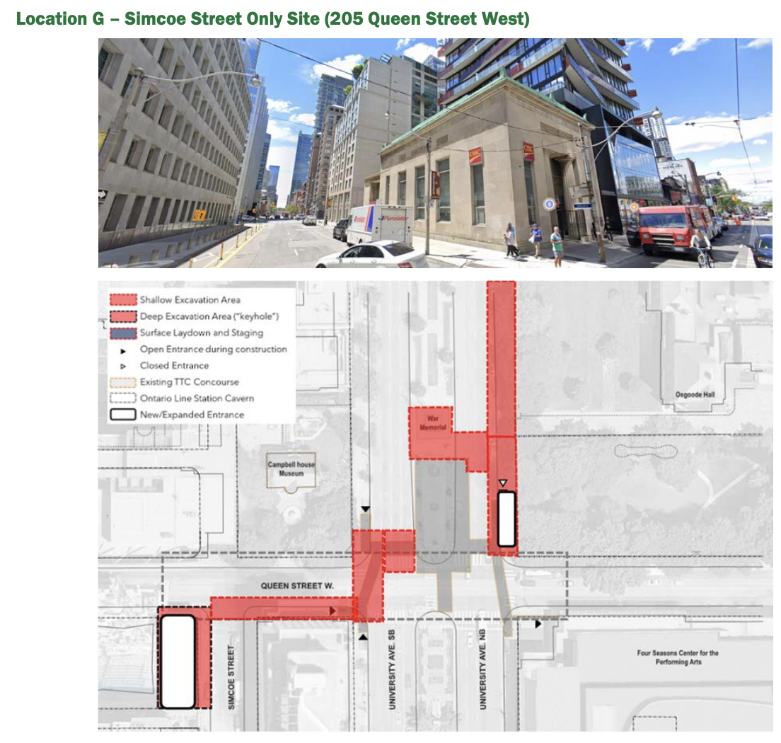

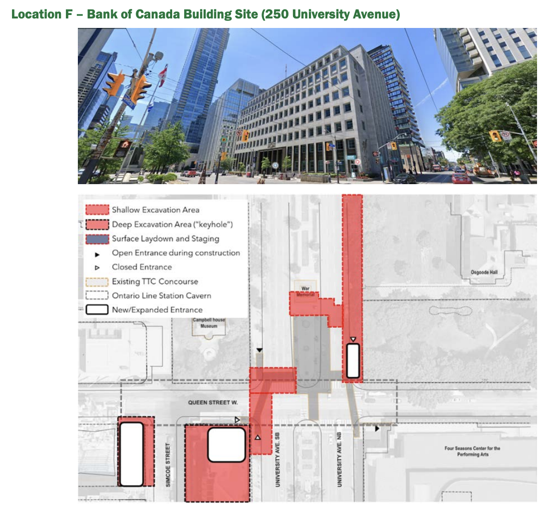

Your statement is contradicted by the evidence you posted.
Both options F and G have only shallow excavation next to Osgoode, and that excavation can be shifted to University Avenue, from the Osgoode Property.
The deep excavations in these two examples are not on that corner. Neither of the above options would impact any material number of mature trees, if any. Option F might impact one mature tree on the Campbell House grounds, based on my assessment of the crown size.
Those trees are

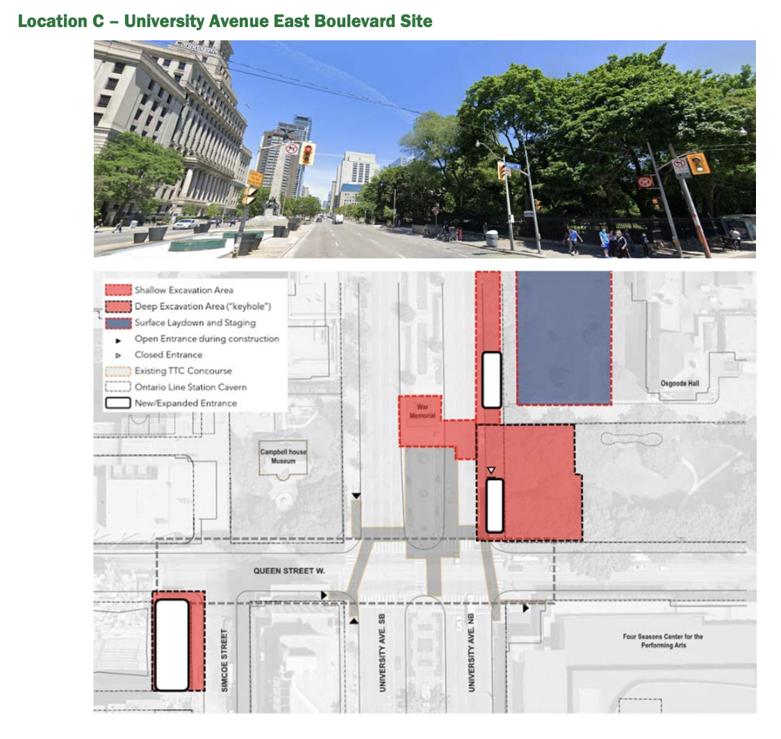

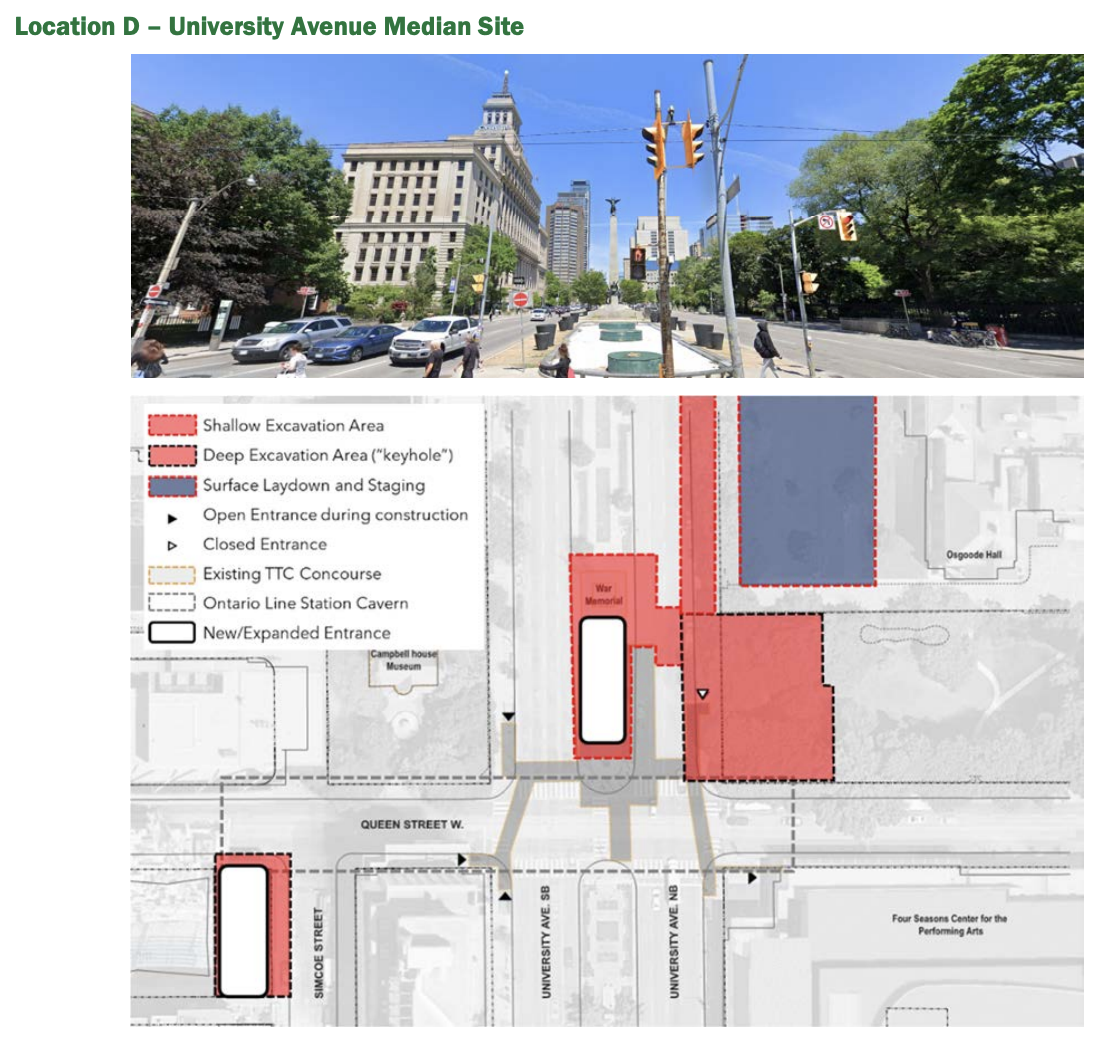

Constructability has only been considered as a fatal flaw if there is insufficient space to physically construct the station. In this analysis, the critical limitation of construction is considered to be the sufficiency of space needed to construct the station itself. Of the options presented, all appear to be constructable with the exception of Option F (Simcoe Site Only), which is an extremely limited site and would present very challenging construction conditions. Just in time delivery and a very high degree of coordination for the spoil removal and material delivery would be needed at all times to avoid significant construction delay
Complexity and duration can be analyzed based on the improved access and laydown areas. The options are listed below
in increasing complexity:
 Tier 1 – Good
 Location A – Osgoode Hall Site
 Location B – Campbell House Site
 Location C – University Avenue East Boulevard Site
 Location I – T.O. Core Site
 Location J – Osgoode Plaza
 Tier 2 – Reasonable
 Location E – Four Seasons Centre Site
 Location F – Bank of Canada Building Site
 Tier 3 - Challenging
 Location D – University Avenue Median Site
 Tier 4 – Very Challenging
 Location G – Simcoe Street Only Site
 Location H – Canada Life Building Site
G is very hard to build and F is also hard to build on.
So yes you can keep the trees. It just makes the project more vulnerable to delays and increases costs
Read the report and you'll find that its either option A or option B and there are many trees that'd have to be cut down in option B as well.
