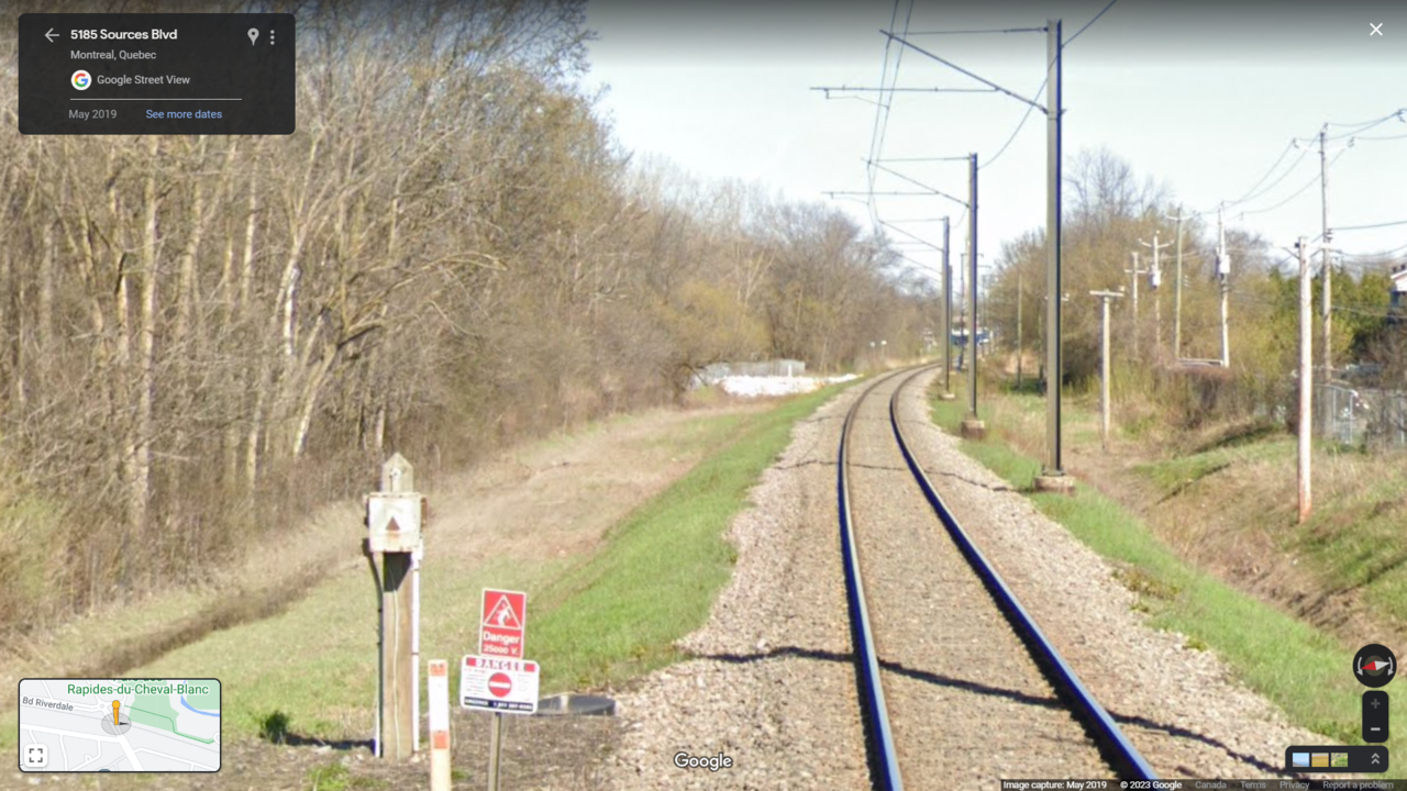

How quaint. A single rail line. A mainline railway at that, so not even relevant. You guys don't need to show Prague, or Montreal. We have tracks and wires all over Toronto. And now we have an elevated guideway, with catenary, it's on Eglinton. Why not show that considering the relevance to the topic at hand?
