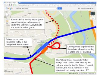

Here are photos of the 2 bridges - and you can see how the one older bridge is a duplicate of the Bloor Street Viaduct/Prince Edward Viaduct.
It has the same ability to accept a lower deck for public transit. The bridge couldn't be used for a subway in the 1960s, and generally the TTC has forgotten about it but with the ability to put in underground LRTs, it is possible to put in transit under the bridge and have it be able to avoid the subway line, and to connect farther east into Castle Frank station.
Castle Frank also has easy access to the DVP - it is really a good place for some TTC express buses or even GO buses to stop, so it becomes a sort of transit node.
The point I have been trying to make is that this bridge which has the capacity to accept LRTs with minimal modifications opens up several opportunities to improve transit in the core by running something underground at least as far as Parliament south of Bloor - it could just be the ability to link streetcars into Castle frank, or it could be something far more ambitious which could be a substitute for the DRL which can be built for less, and therefore built far sooner.

View attachment 33205View attachment 33206
It has the same ability to accept a lower deck for public transit. The bridge couldn't be used for a subway in the 1960s, and generally the tTC has forgotten about it but with the ability to put in underground LRTs, it is possible to put in transit under th ebridge and have it be able to avoid the subway line, and to connect farther east into Castle Frank station.
Using this bridge for this "plan" makes no sense, and would provide minimal overall improvement for a lot of money.
Just because it has capacity for an underground line does not mean there is any value in using it - the alignments make no sense, there would be no ability to extend west (where would it go?) and it doesn't serve to expand the subway network as a whole and serve other parts of the City. This plan would only serve one purpose - to reduce the load at Bloor-Yonge. There would be almost no local demand, I dont really follow the DVP point, and would be a terrible spot for a transit node.
Extending "West" - the idea is that is does go west from this bridge only to Parliament, where it turns south... there is no point in go west of Parlimanet along Bloor as of course it then goes to Sherbourne station.
"Expanding the Subway network" - well, do you consider the buried portions of the "Crosstown" as subways or as LRTs? Traditional "subways" like the YUS are at least twice as expensive per km as LRTs and we lack the funding for even doing somethin glike extending Sheppard or doing the extension of the Bloor Danforth line without raising other proposed lines.
LRTs that run down the middle of a major road are controversial - not very fast, interfere with road traffic (left hand turns, no other vehicles can use the lane unlike HOVs) and are not the way to go in most areas, particularly in the Core. If the idea here is that we need high capacity transit (more than cheaper buses can provide) then we either need to elevate or bury transit lines.
Reusing this bridge would provide a "buried" high capacity means of public transit to link the Bloor Danforth line and the Financial Core, adding in extra capacity, being roughly as fast as the YUS if it was buried, and adding transit capacity in a part of the city that lacks anything other than buses running north-south, and where the Official Plan calls for intensification, as opposed to building transit lines through stable areas where virtually no growth is to occur (with the only exception being that many Avenues are possible intensification areas - that is another debate)
And if we do not do the full underground LRT line to the core, then at the very minimum, streetcar tracks from Parliament and Carlton can be run north, then go underground just south of Bloor (similar to the Spadina LRT) and then provide an extra connection between streetcars and subways that helps to siphon on riders from the stations along Yonge south of Bloor.

Look at Castle Frank - where are you going to put the new platforms?
This should answer that... the current platorms are under the bus terminal - there is space under Bloor Street itself, and space for a loop under the grass in front of the Danforth School for the Arts..
The tricky part is ensuring that if this is ever extended north, that the LRT can go under the subway tunnels just before they go into the Prince Edward Viaduct
