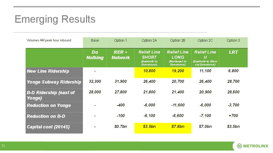

One of the benefits of LONG that Steve mentioned that was missing from YNRS were the substantial reduction in fleet requirements for YUS and the $1 Billion we'll save by not having to rebuild BY Station.
The thing about the reduced fleet requirements perplexes me. Wouldn't the cost benefits of a reduced fleet on YUS be negated by the costs of having to run a new fleet on DRL LONG?

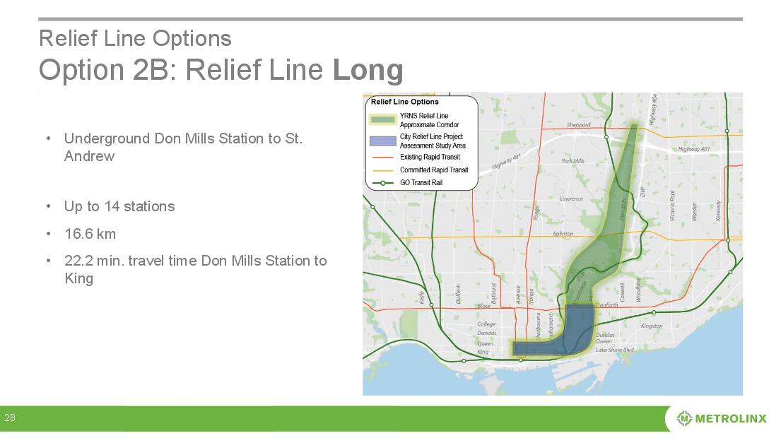

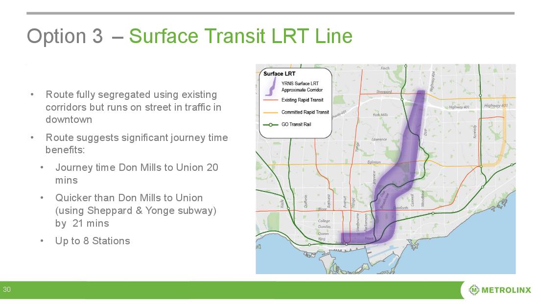

And I didn't see them posted, but here's a couple screenshots of Metrolinx's DRL-Long and LRT routes. To make it easier for people to look up instead of opening up the pdf.

Im kind of confused how a subway running from Don Mills and Sheppard can possibly go 16km with 14 stops and get there within 22 minutes when I commute from Eglinton West to Union about 10km with 10 stops and it takes me 20 minutes.

If anything, I'd expect RL LONG to result in significantly greater fleet costs.
If I've understood correctly, a problem with YRNS and the other studies so far is that they treat current YUS ridership figures as if those figures represent everyone that wants to use the line. The YUS is over capacity, so presumably there are a significant subset of commuters who would take the YUS if they were able to fit on the trains.
All the YRNS tells us is that of 31,200 pphpd using the YUS today, 11,600 of them would be diverted to DRL LONG (this brings YUS usage to down to 20,700). It gives us no indication at all of how many new riders we can expect to fill the 15,300 pphpd of available YUS capacity that will be made available because of LONG.
Obviously, this has very serious implications for fleet requirements. Say that 5,000 new riders are generated on YUS because of the capacity freed up by LONG - this would mean that the YUS fleet would have to be 25% larger than indicated in YRNS. Hopefully the next stage of the study will examine how many new YUS riders will be generated on YUS because of LONG.
You've overestimated the travel time and distance. The run time between Eglinton West and Union is 16 minutes and the track distance traveled is about 8.5 km. That is an average speed of 32 km/h.
Assuming thee DRL numbers you gave us are correct, the average speed of DRL LONG is 44 km/h. That's 12 km/h or 35% faster than Eglinton West to Union. This can be attributed to the wider stop spacing on DRL LONG. Eglinton West to Union has spacing of 1 stop every 850 meters, while DRL LONG has spacing of 1 stop every 1,114 meters. That's 31% wider spacing.

Interesting what this concept for the LRT could be... 8 stations, I'm thinking:
- Don Mills (Fairview Mall)
- York Mills
- Lawrence (Shops @ Don Mills)
- Eglinton (Science Centre)
- Thornecliffe Park
- Danforth
- Queen East
- King-Yonge
This is really the stop spacing we should've seen on Eglinton East and Sheppard to make them true rapid transit vs local service.
Not really. The LRT you would build up valleys and rail corridors for a radial route is not the LRT you would build on a dense suburban residential and mixed use corridor. Stops every 2 kilometres would have meant hitting every second or even third arterial road, skipping a lot of bus routes and walk on customers.

This is roughly what I'm imagining as well. But what I have trouble wrapping my head around is how a line would get from "Queen East" area to "King-Yonge" without any stops/stations in between. If it's run on the roads, it'd only make sense to create a few stops considering the line would hit a traffic light every 20sec and people would be demanding to be let off/on. Unless it's somehow either underground, or using USRC.
