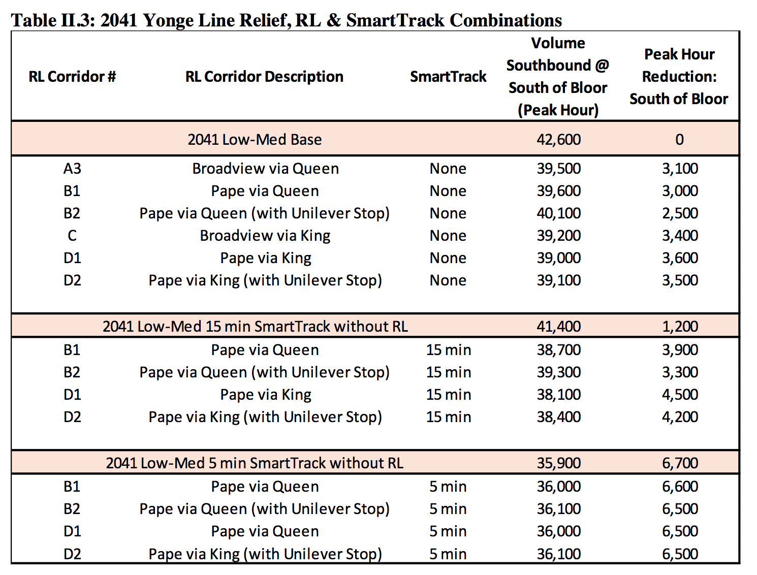

Well it's true that if you believe the report mentioned before, you can manage to keep Yonge line to capacity at peak times without the relief line... but only if you have the SmartTrack running every 5 minutes and no YSE.

SmartTrack doesn't intercept riders heading to the Yonge line, so even if it were working at ideal frequency and fare scenario, how can it provide real Yonge line relief?
SmartTrack's 'relief' in the ideal scenarios stems exclusively from picking up riders that would otherwise be boarding the Scarborough subway (Line 2). It does not pick up any of the bus routes north of Danforth bound for Yonge.
The dirty little secret of Toronto transit is that the relief line short is completely ineffective at relieving Yonge line crowding. Anybody expecting to be able to fit into Yonge line trains when the Releif Line Short opens will be disappointed. It's primary benefit is relieving Bloor-Yonge crowding. 3,600 pphpd in Yonge line ridership reduction will be negated in 5 years or less with our expected population and ridership growths. Also note that 3,600 pphpd reduction is not enough to ever get Yonge operating below capacity. The Relief Line is only effective when it's north of Eglinton; everything else is a stopgap. We need to move forward with this now.
To put this all in perspective, automatic train control is twice as effective as the relief line short at reducing Yonge crowding

^TTC has stopped pretending it can achieve 90 second headways on the subway, the more recent ATC capacity numbers are reflective of reality. ATC will allow for 105-110 second frequencies, which will shave around 30 seconds off of todays 135-140 second peak frequencies. They will essentially be able to run 33 trains an hour instead of today's 28. Original claims had ATC running 40 trains an hour, which is clearly not possible.
So reducing the number of people at Yonge-Bloor would allow 7 more trains an hour. Increasing capacity by 7,000 passengers an hour - in addition to moving 3,500 or so people off the Yonge line.
That sounds like an extra 10,000 passengers who can use the Yonge line. As opposed to the fiction that Region of York (ROY) are peddling.
