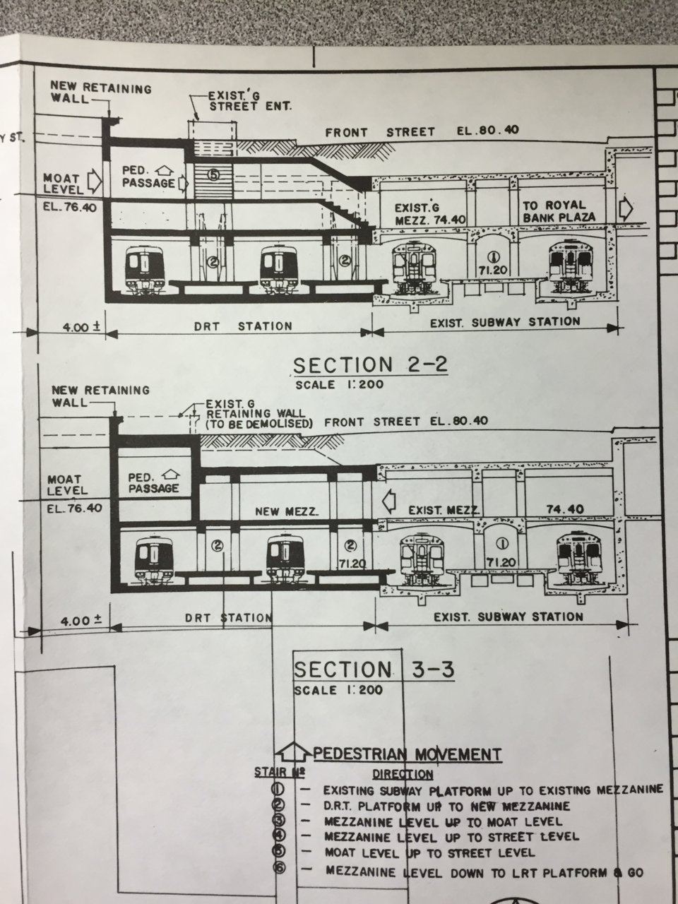

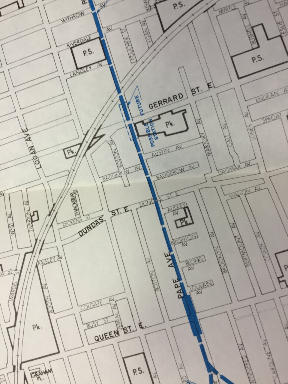

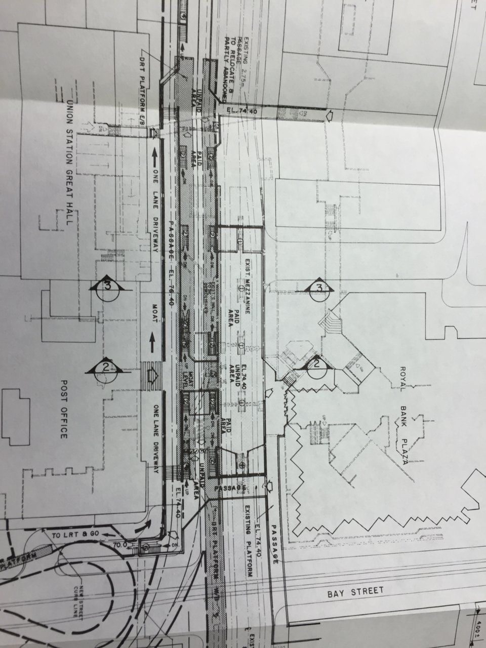

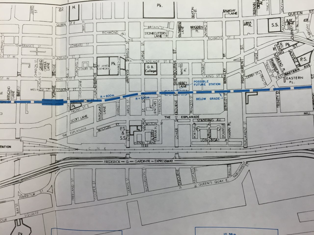

I do have some images of the plans:
Note they are different schemes from the same "Downtown Rapid Transit Study" dated 1985 - and the alignment varies.

Nice to platform less than 30' (9.1m) below road level. Not only less costly, but more convenient for riders. Hopefully the design team smartens up and takes not of this.
(SSE team too).
