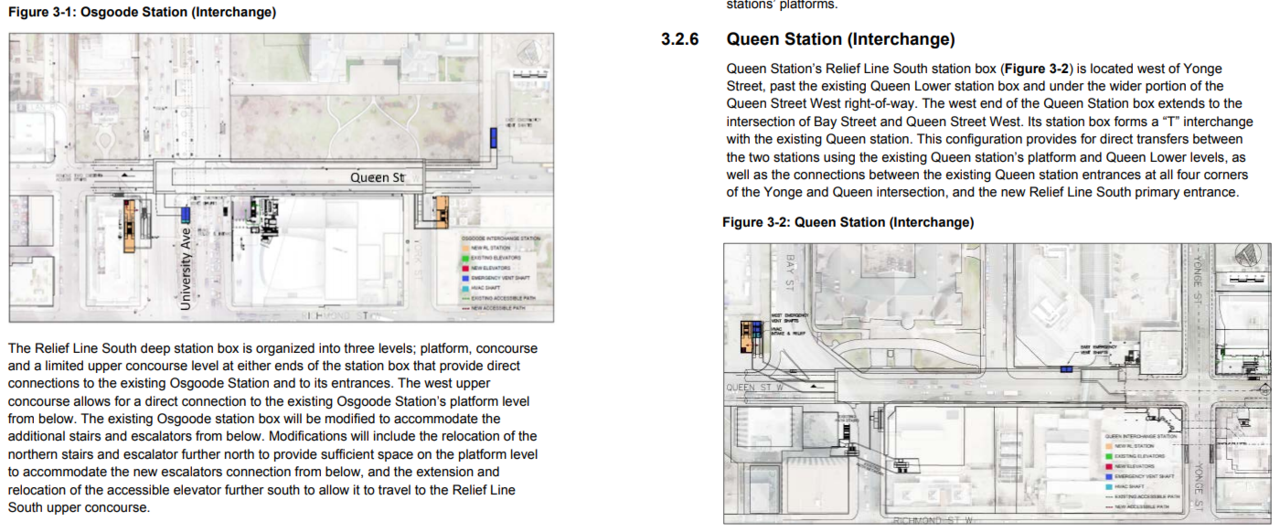

Argh. I still can't believe Osgoode and Queen platforms are east of University and west of Yonge, respectively. ~425m. I guess both of them connecting directly to NPS isn't so bad though.
That's ~250 meters from the end of one platform to the beginning of the next. Compare with the next adjacent stations: ~850 meters to Sherbourne and ~820 meters to Spadina.
This is still an improvement over having a single station at the "psychological heart" of Toronto, but still seems like they're sacrificing transportation objectives for placemaking. Nathan Philips Square is a popular destination several days of the year but not enough to merit four subway stops, especially not compared to all the other potential destinations downtown.
I guess it's just coincidental that the people planning this subway placed entrances right at the doorsteps of where they work.
Also, do we really need all these concourse levels? There's a lot of vertical circulation which seems unnecessary, it would be much more convenient (and cheaper to construct) to only have a single flight between the DRL platforms and the line 1 platforms.
I also teased out this gem:
Amazing how the planning department has placed a subway in the same place that they've designated a surface transit route as a "heritage attribute" without seeing a contradiction.
