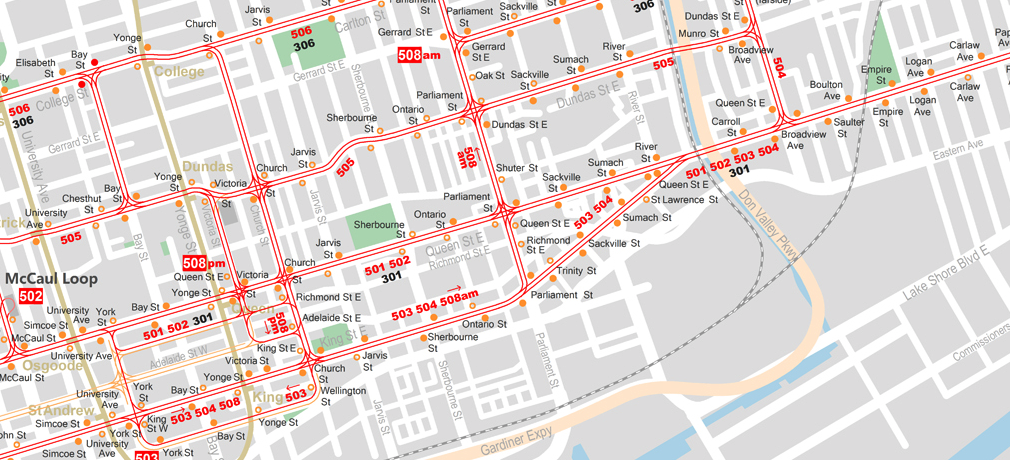

Current streetcar track layout from link.

Wild speculation time: I'm looking at the map WK.Lis just posted: #10,934
After the opening of the DRL South, it might be possible to segment the 501 into two different routes. The western route would run between Long Branch and McCaul Loop (at Queen and McCaul). The eastern route would run on Queen Street between Victoria Park and King Street East, where it would then turn south to follow the current route of the 504 King.
McCaul Street is just 250 metres west of University, which would be close enough to be served by an additional entrance to University Station. So customers would have to make the 250ish metre underground walk from the subway to McCaul Street to transfer to the streetcar.
Now I personally think it would be a bad idea, BUT I suppose it would be feasible. Don't let Doug Ford see this post.
