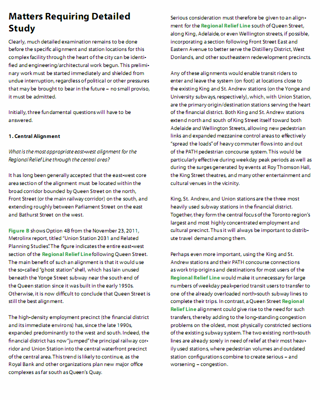

What Alvin describes here is still the sticking point for me.
At the end of the day, it doesn't matter what technology it is, which track gauge is used, or how it looks. What matters is if it achieves the goals of the Relief Line.
Which are to recap in no particular order: (1) to provide relief to Bloor-Yonge Station; (2) to provide relief to the downtown streetcar network from the east; (3) to provide access to the east-end of the Old City of Toronto and East York, including some priority neighbourhoods along Overlea; (4) to provide relief to the Yonge Line by intersecting the Eglinton Crosstown and the major arterial bus routes feeding Yonge from the east; (5) to reduce commute times to the major downtown job centre and economy for North York east and Scarborough commuters; (6) to free up the necessary capacity to enable the construction of the Yonge North extension.
This line is projected at 20,000 pphd. We can't screw this up with a bad alignment (ala Spadina Line).
I suspect the present work done on alignment and route will be retained, albeit some of the curves might have to be of a greater radius and platforms lengthened. The southern "Don Valley alignment" is valuable not as the prime route, but as an adjunct to it, even as single track, as a by-pass for double-decker 'express' from Don Mills south non-stop to Union in peak to allow a more direct connection to other GO routes. Off peak, RER single deck EMUs off of the northern reaches in Markham would take the Relief Line route to the core, with a transfer at Gerrard or the subway to continue to Union if wanted. The line would still head to Osgoode and then later, west to rejoin extant RER corridors.
I always thought the jog on Carlaw was a waste put in by City Planning to make the public happy, but adding great expense. As I recall the drawings, there was a major sewer main along Carlaw, and it force the line to be 6m+ deeper to avoid this. Maybe this is the opportunity to remove it.
