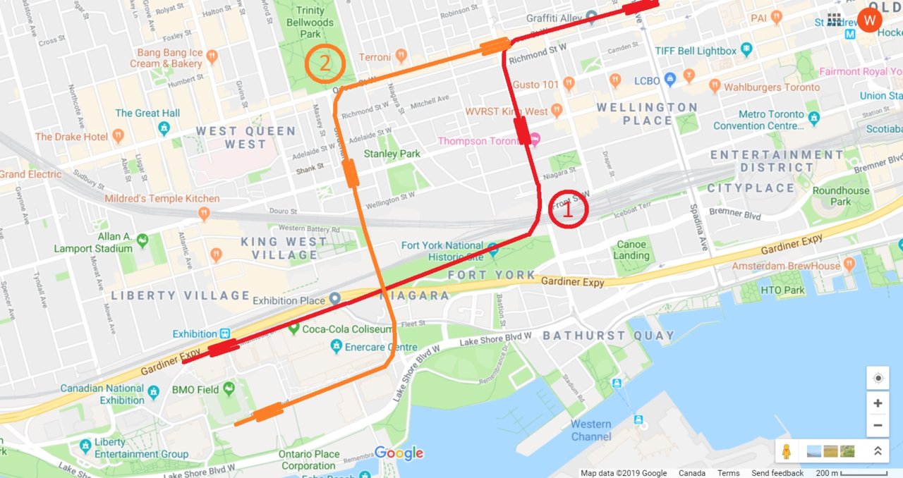

I suspect the Province is eyeing something like #1 (red). Queen to Bathurst to Front under Fort York to station at CNE streetcar loop.
An alternative I could conceive of is #2 (orange). Quuen to Strachan to Fleet to Princes' to station near BMO Field.
The desire to not cut transit lines under building would preclude a lot of other choices.
Is a tunnel boring machine capable of making such tight turns?

If I understand this right, curves of radius above 300m can likely be bored. I was imagining a radius of about 100m (something that TTC subways can't handle, but these REM type trains can). Do they basically dig up the curve from above and built it cut and cover? The TBM then passes through this and continues on it's way on a tangent. It's work from above, but it's still faster than a station because it's just the tunnel that's poured and the rest just back-filled. The TBM also doesn't need to be dismantled to cross this space.

[...]The tunnels will level out then take a sharp right turn (R 137 m) towards the north at Market Street, where they will pass under two other operational subway lines. In order to ensure the safety of those lines during boring operations, a liquid level system working in concert with longitudinal and transverse strain gauges and other instrumentation will be used to monitor ground disruption. The system will be used under the live tracks and determine if settlement mitigation measures must be executed
Due to the complex geometry of the alignment, steering the TBMs accurately through the tight curves (min R 137 m) is one of the key challenges of the project. To accomplish this it was necessary to articulate the TBM shields. An active articulation system was integrated as it allows the thrust cylinders to remain parallel to the tail skin and react evenly with the segments. This feature mitigates the risk of segment damage, ring deformation, or settlement during boring.

You weren't far off with "100m" Burl, but 137 was the best they could do, and with *many* accommodations, expensive ones, to do it.
The long and short of this is that all those squiggles proposed for the O-Line on the map that come from peoples' imaginations are fantasy. Can it be done? Sure, at many multiples and complications of the price people are assuming. It's just not how you build a metro unless you go back to using a Greathead Shield:
