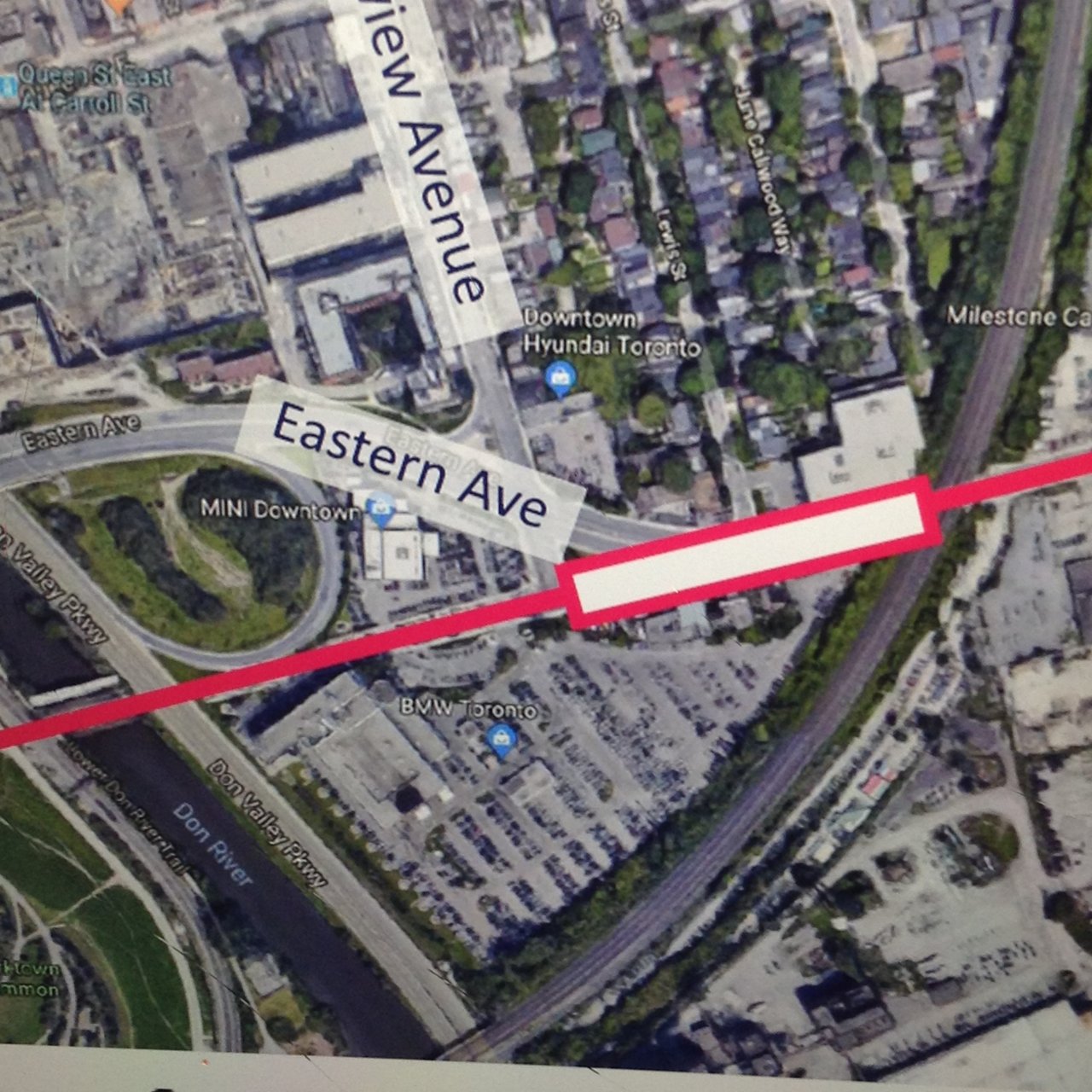

https://www.google.com/maps/@43.6546519,-79.3520389,666m/data=!3m1!1e3
  • The vertical clearance to the railway must be 7.2m (passenger rail may be about 0.3m less), while the clearance to the DVP must be 5.0m (or possibly 4.8m, depending on the structure type). Thus, the high point of the bridge would be above the Richmond Hill GO. Assume you also need 2.5m for the depth of the bridge strcuture, plus deck and rail. That is good for a span of 50 to 60m, which could span the Don with no in-river piers.
  • Depending on the route you take, it's about 200m from the RH-GO to Bayview @ Lawren Harris Square. At 5% grade, this means the track level would be at grade at Bayview - which also means that Bayview would have to be shut down. It the Ontario Line (OL) crosses RH-GO as close to the LSE-GO bridge, that distance can be increased to maybe 240m. Then, you have to take the entire length of Lawren Harris Square to increase this length by another 90m. Now, at 5%, this means that the OL would be fully below grade, with the portal being somewhere near the east end of Lawren Harris Square.
  • Bayview would have to be rerouted. One part of Bayview would likely go up Lawren Harris Square to Lower River Street. The other part of Bayview would continue following the RH-GO tracks.
  • In the East, you have much more space an this is not critical. I suspect the station would be at-grade (at the level of Eastern Ave.), which is below the elevation of the LSE-GO. The tracks would go underground east of here.
No matter how I cut it, it seems to be a tight fit that will involve some surface reconfiguration. But by making the adjacent lines and stations shallower, I imagine there is money to be saved. Which I think was the big problem with the City plan - it was designed to minimize disruption of NIMBYs, with no regard for cost.
steveintoronto has brought up tunnelling and geotechnical challenges with having the line cross above the Don and DVP but I contend there are simpler geometry issues that make this essentially impossible (nothing is "impossible" but the scale of impacts do not make it feasible).

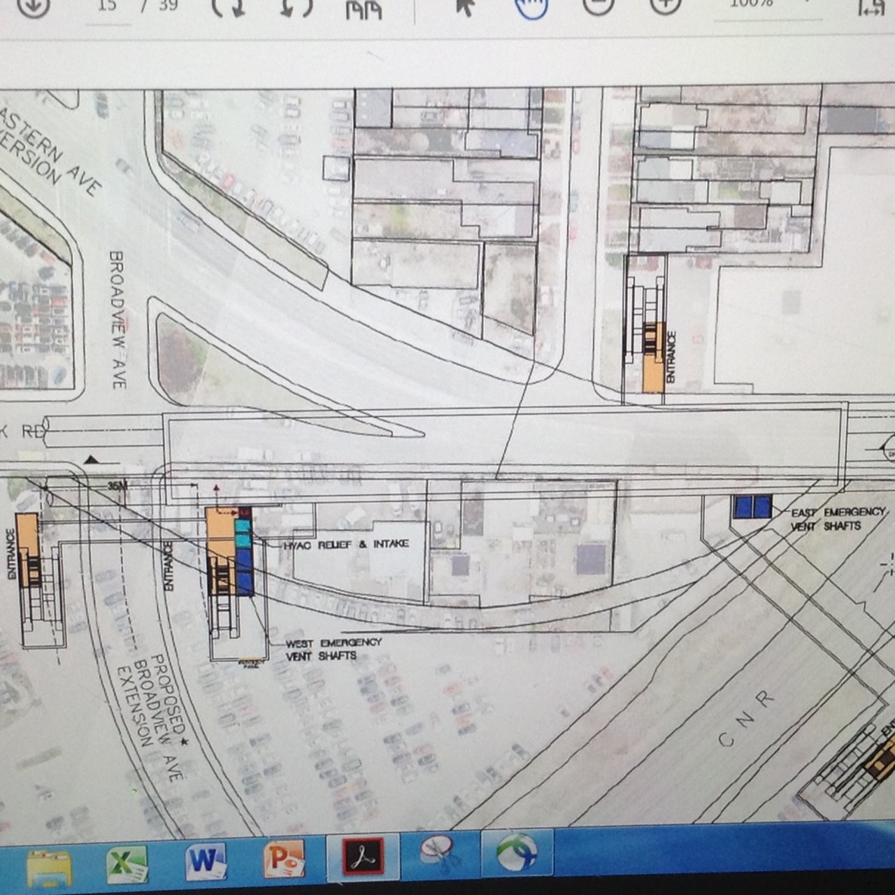

One just has to look at the plan views of the proposed station, focusing on where the platforms are located relative to the rail corridor:
Scenario 1: At-grade (elevated) with the rail corridor
Not feasible, due to the obvious conflict with the existing rail corridor. Btw, I see absolutely no chance of this line being interlined with the LSE corridor, which is the only way this scenario could ever resemble something that is feasible. Raise it over the rail corridor? Non-starter, again for obvious reasons, plus the platforms would have to be on a serious gradient.
Scenario 2: Lower to Eastern Avenue grade east of the DVP
We're now in conflict with the Broadview Avenue extension, not to mention the rail embankment, and Eastern Avenue when the line turns northward. Remember, the platforms have to be at a zero gradient and their eastern ends are at the rail corridor.
Scenario 3: Lower below Broadview Avenue profile east of the DVP
To clear the DVP and then to be sufficiently lower than the roadways and subsurface utilities on Eastern and Broadview, that's one heck of a roller coaster and our platforms will not be at a zero gradient. Plus, if you're now diving below grade for the station, why not just tunnel the river and the DVP?
Bottom line: this is another example of wasted time and money with only the consultants on poorly scoped, cost-plus assignments benefitting from it.
