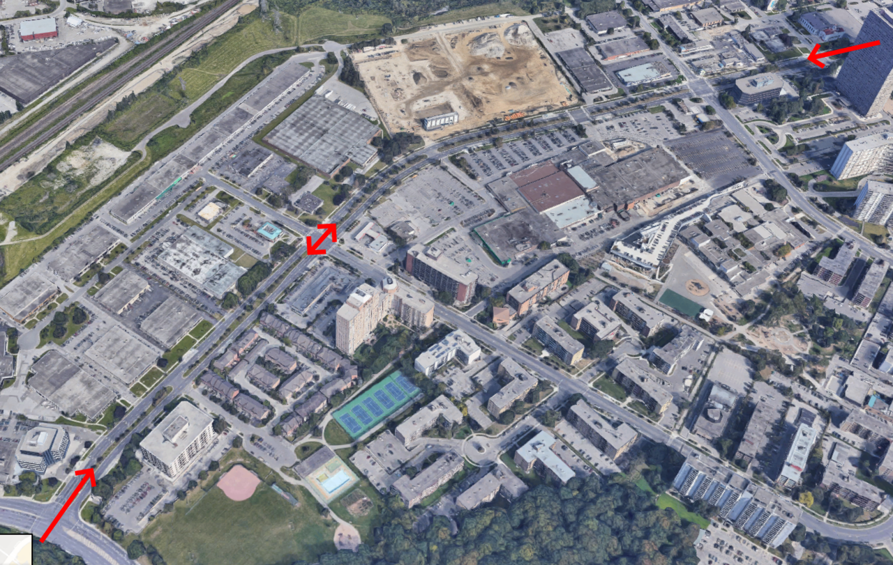

^ Since the City staff report mentions the Province is looking at the OL being elevated through Throncliffe Park, safe to assume they are eyeing the centre median for the support piers? (see arrows I've added in red)

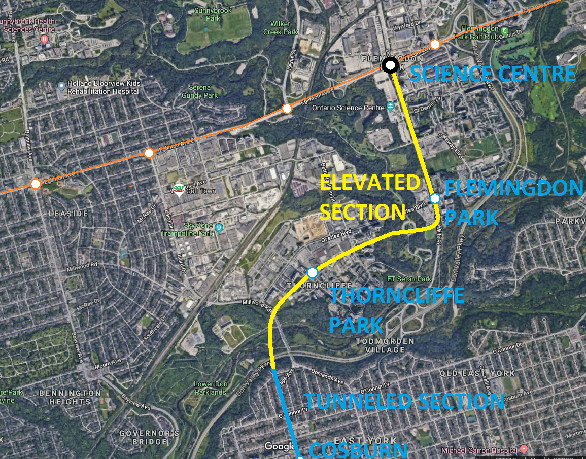

I did draw up an alternative aliment a couple month ago. It would be less disrupted to build the alignment further away from Overlea Blvd and closer to the residence of the area but it might be noisier. If a rubber tire technology is chosen, noise will be less of an issue.
Interesting routing but why not just give the two 81 branches separate route numbers? 81B retrains the current 81 designation and the 81A be called 181. They could also serve stops in oppose sides of the road. Then again why not just terminate the 25 here and the 925 won't go south of Eglinton. The 8 is going to be a busier route again to make up for the lost service on Broadview.

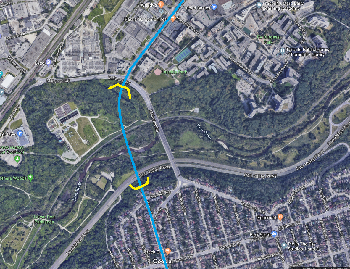

There is two questionable sections on Line 3 in this proposed map. (I'm not criticizing your map, just want to discuss about the alignment) The Millwood overpass cannot handle anymore weight so the alignment would have to be carried on a new crossing. I would place it to the west of the Millwood bridge. The second Don Valley crossing (over the west branch of Don River would likely be elevated to avoid the expensive cost of dropping 20m into the ground It would be expensive to build a launch shaft beside a high rise. I think Flemingdon Park Station should be at the intersection of Don Mills/Overlea Blvd. Spacing would be more balanced this way.
I propose the crossing be an elevated crossing matching up with Pape Ave and Overlea Blvd. They would have to but out a few houses to build the TBM launch shaft.
