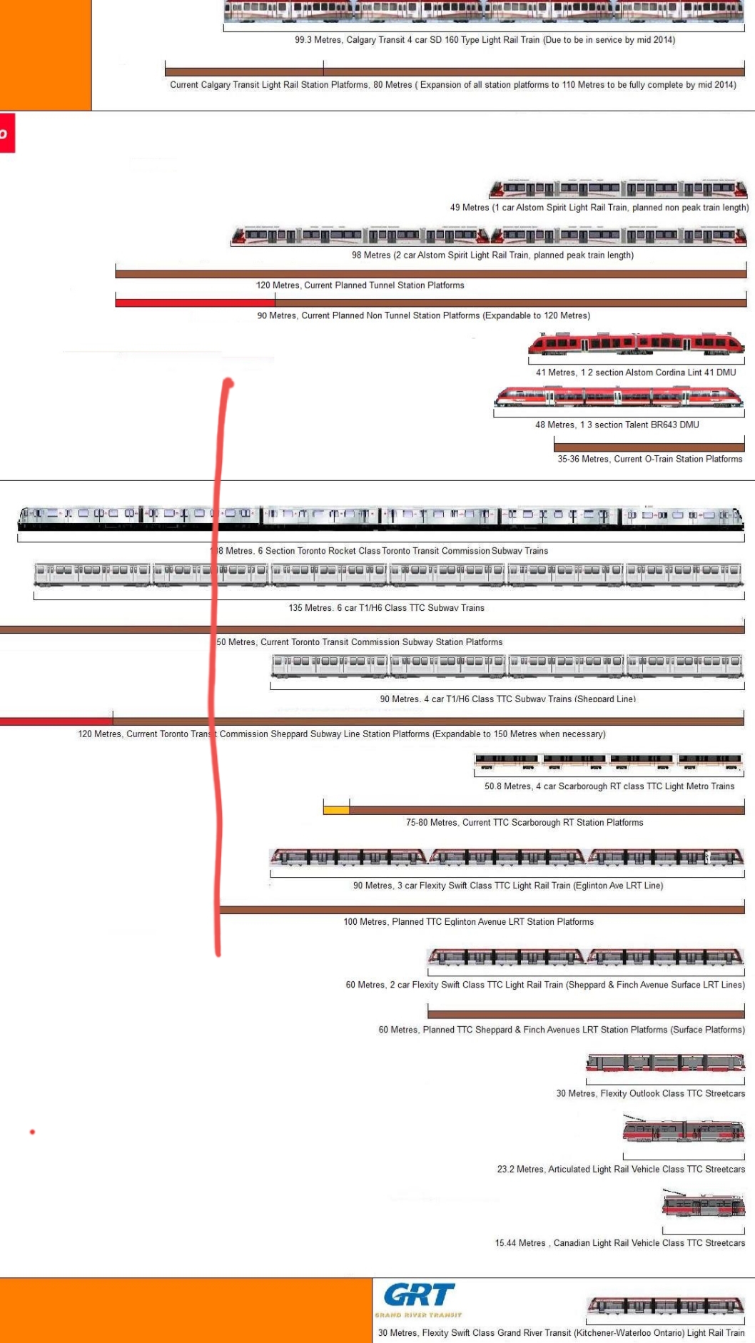

From the article: "According to the business case, Ontario Line vehicles would be up to 100 metres long, and carry up to 850 passengers. By comparison, the TTC’s newer model subways are 138 metres long, and can carry a maximum of about 1,460 people."
I'm big on visuals so here's where 100 metres is on this chart.
196346
