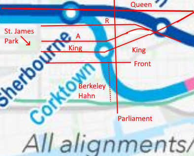

^ Interesting. I was about to ask why would they be drilling on Berkeley because I was under the impression it was going to curve to be under Parliament, but I then looked at the map more closely. Rough map I created below.
