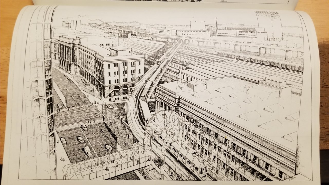

The plan studied several different options, including elevated and underground options of the recommended route (Pape Ave. to Eastern Ave. to railway corridor to Front St. to the intersection of Spadina Ave. and Front St.) Here's a plan showing a conceptual elevated alignment at Union Station. Yuck:
Ewww:

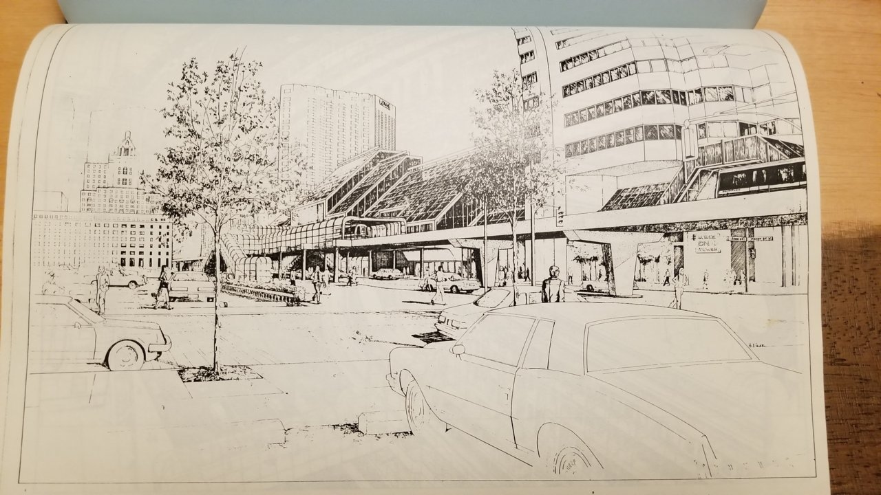

Conceptual elevated alignment near the convention centre. Ultimately, the study recommended the underground alignment because of the "unacceptable [...] visual impacts and reduction of pavement and sidewalks lengths":

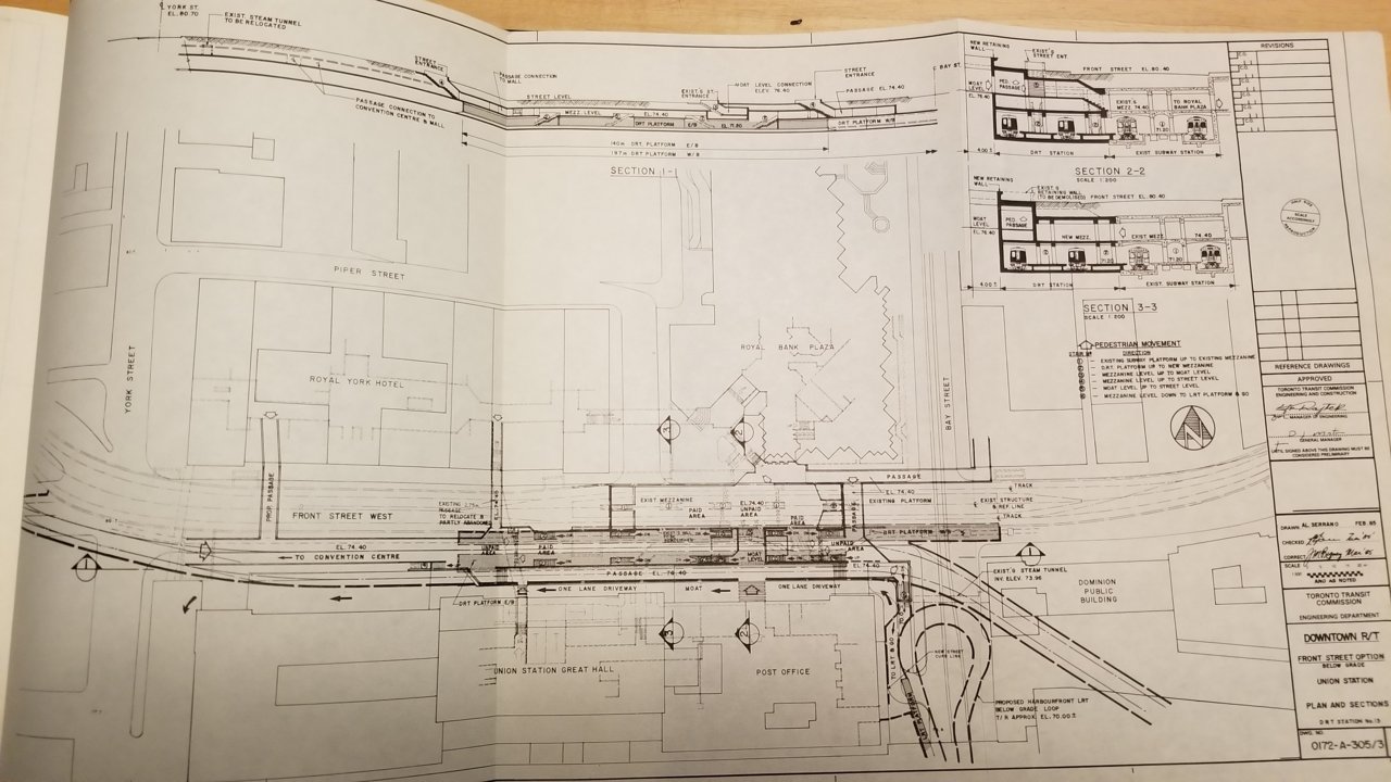

Conceptual underground alignment at Union Station:

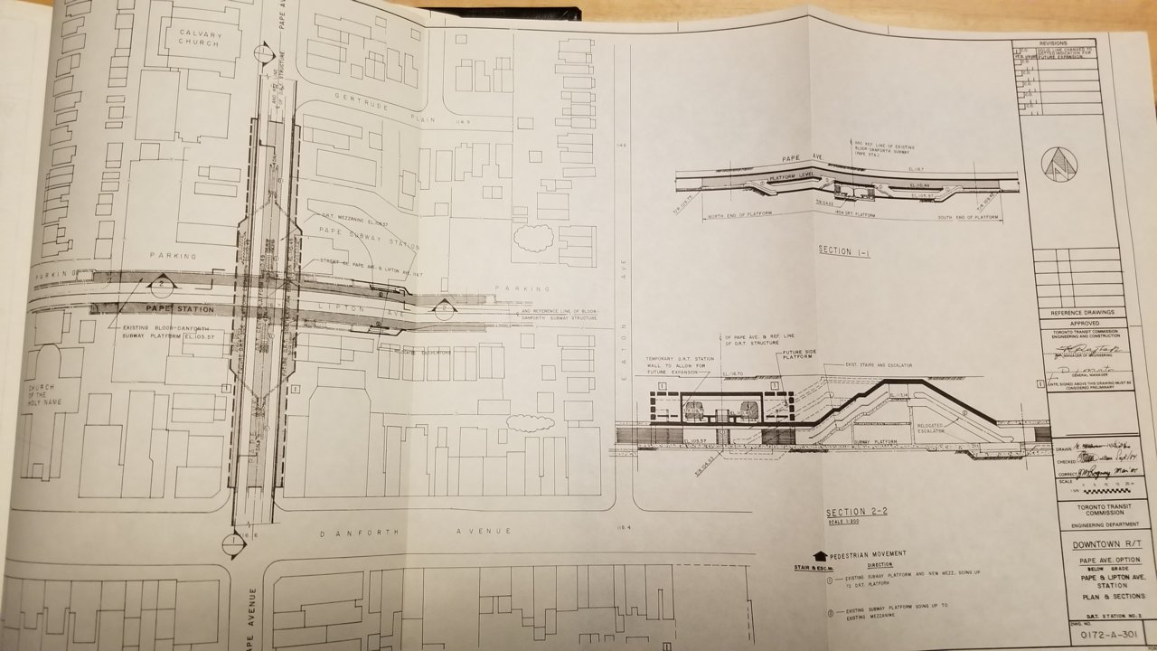

"Pape & Lipton Ave. Station" plans:

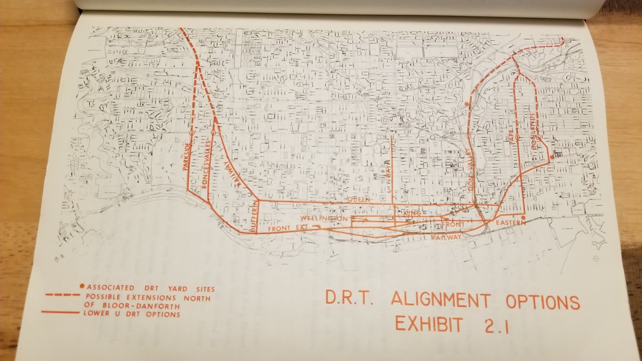

The study also analyzed potential routes. Interesting that a Bay St. route was examined. It was to be an underground extension of the Harbourfront streetcar (stops at King, Queen, Dundas, College, Wellesley, and Bloor), but was rejected because of the ineffectiveness in long-term relief of both the Bloor-Danforth and Yonge-University subway lines. The study notes that a subway on Bay St. was also considered in the study but difficulties connecting the tracks to the existing lines, and the lack of a yard if the subway was built with no connections to the existing subway meant that it was a non-starter.

That Union stations plan is horrifically bad. If they wanted to go elevated at Union why didn't they consdier putting the platform out back alongside the rest of the rail infrastructure?
Because then the connection to the existing subway station and the then-future LRT platform at Union would have been horrific.

Can you confirm the length of the underground platforms in these plans, @chinesehorse. The pic is a bit too low resolution to resolve those details

The cross-section of the proposed Pape-Lipton Avenue station suggests a platform length of 140 meters, as does the Union Station cross section.
