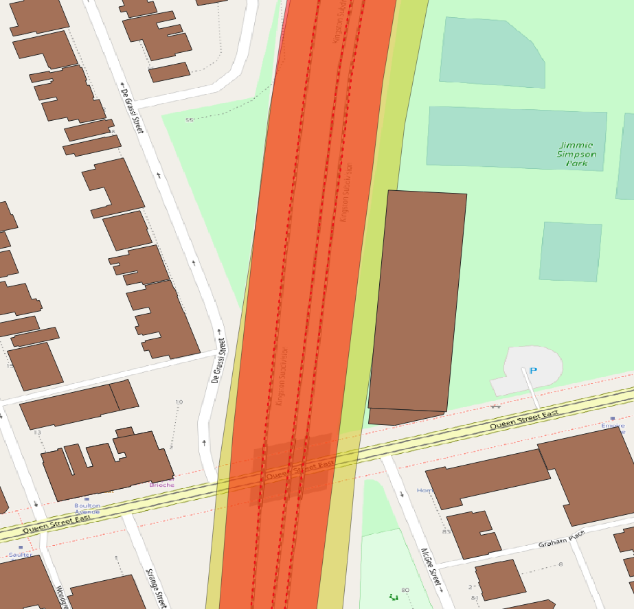

Already I can see a bit of an issue. Looks as though they are using the Toronto Centreline (TCL) dataset from OpenData Toronto.
Measuring the existing rail bed, it sits at about... 12-14m in width. If we assume that, as they claim, there will be a 11m addition on each side, that raises the total to say 36m. Using a 36m buffer on our TCL we can see, oh no! It's clearly impacting the Rec Center, meaning it must be demolished, no?
Well, if you look a little closer you can see I've also shown the actual rail tracks, from the National OpenData Catalogue, which differs slightly from the TCL file. the TCL appears to show the geometric centre of the allotted land for the rail corridor, and not the centre of the rail alignment.

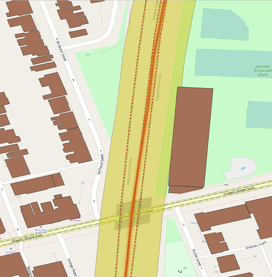

So I'll perform the same methods on our actual rail track, where the edge of the rail bed appears to be approx. 2.5m away from the rail centreline. Adding their proposed 11m buffer to this, we get the following image:

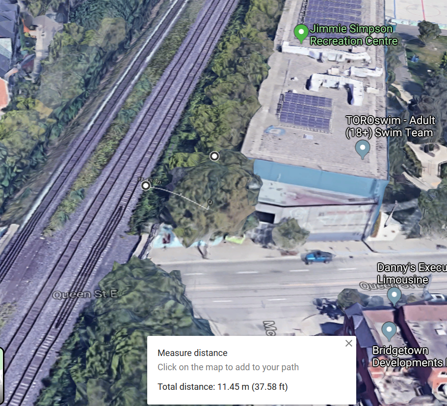

This is nearly identical to what we would expect from the rough measurements on Google Maps:
(Source: Google Maps)
Of course, this is highly dependent on the actual edge of the rail bed and the setback. I'll explore some different arrangements of that at a later date. For now, I am confident that they have not used the correct data set. Using the TCL dataset provides an inaccurate look at the future OL alignment as the track alignment will be based primarily on the existing rail line and not the centreline of the rail corridor's property.
This is only a preliminary finding. I'll be performing a more in depth analysis based on similar methods to this hopefully by Friday or Saturday this week. I'll take a look at the discrepancies and list the actual affected addresses and their land uses.
EDIT: Again, wanted to make it clear this is not necessarily saying that the Rec Centre is or is not impacted. Only that the methodology of the post is flawed.

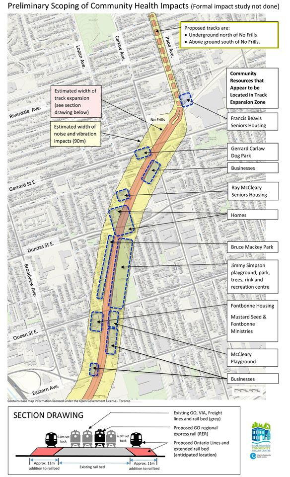

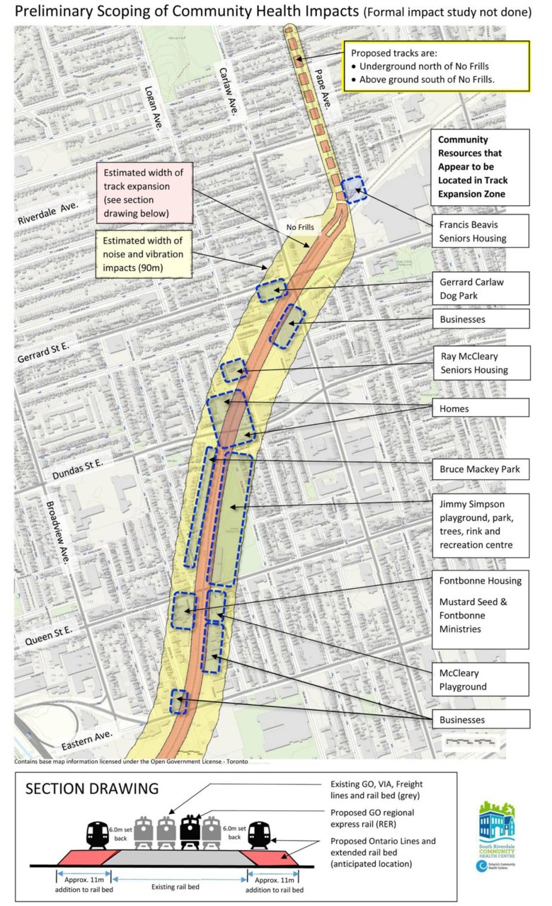

Latest post with a map by the local residents group.
The group says that Metrolinx says that this map is inaccurate. The spacing is not to scale on the cross section.
Thoughts?
