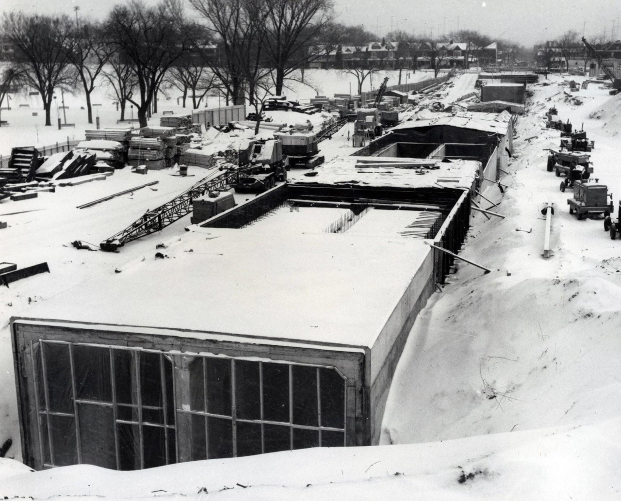

Line 2 cut and cover sections, as far as I am aware, are made from concrete sections. These are quite easy to see in the photo below:
(Source: A view of the construction of the BLOOR-DANFORTH subway through Christie Pits, Transit Toronto)

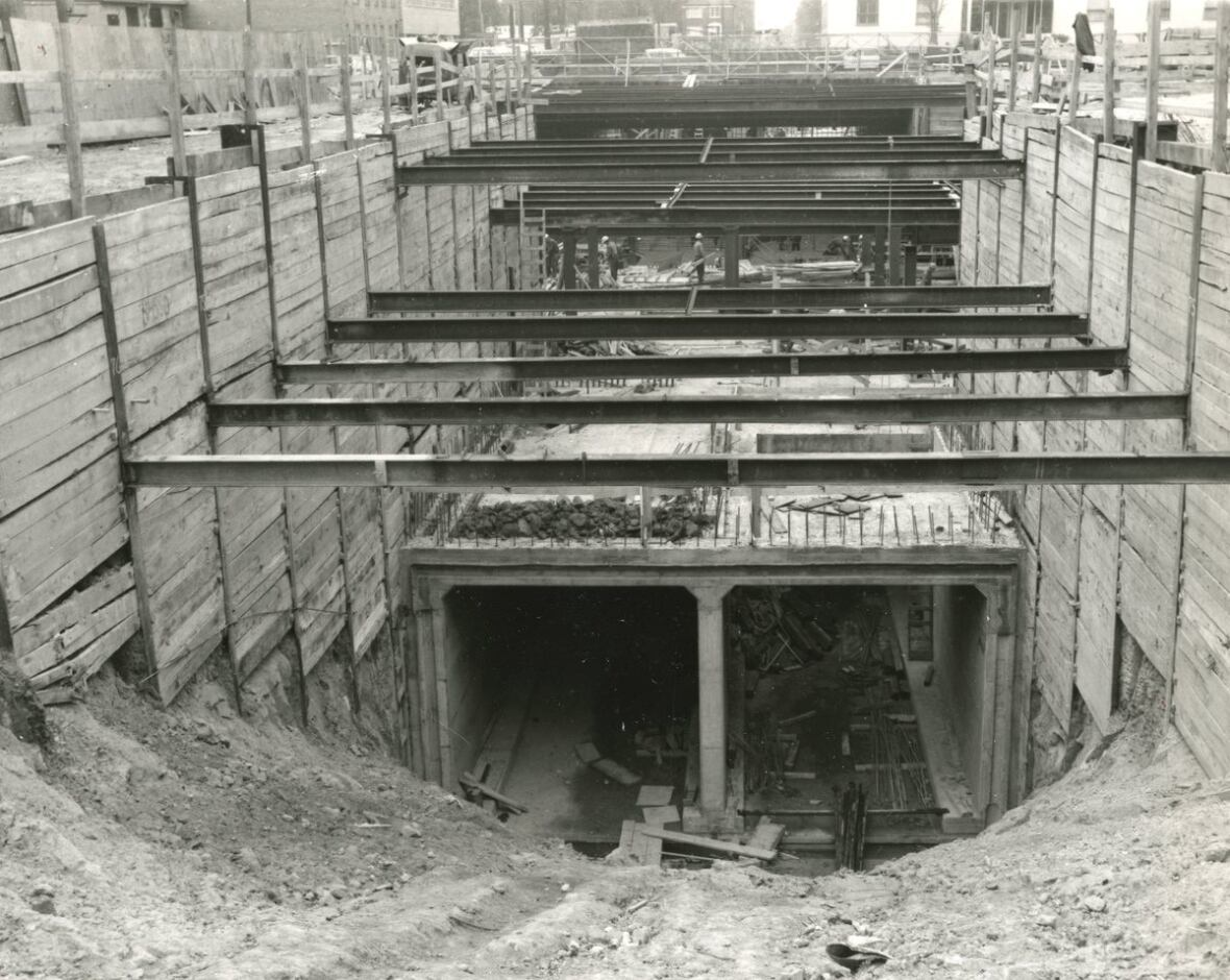

The way the concrete sections are assembled, there appears to be no interlock between each segment as shown below:
(Source: Happy birthday to the Bloor-Danforth subway, CBC News)

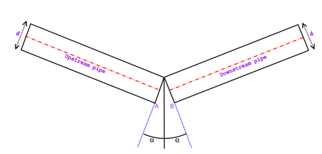

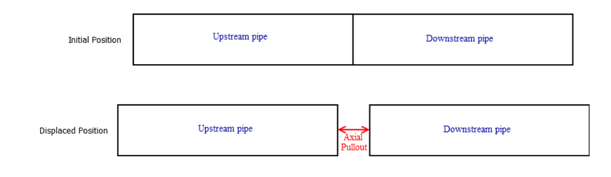

As there's no interlock between the segments, any differential displacement could cause substantial problems to the rail track. These are likely not operating like a stiff beam but instead a collection of segmented pipe. Segmented concrete pipe is quite sensitive to differential settlements. If there's excessive cant or twist in the rails, the line could be entirely shut down until the problem could be remediated.

EDIT: Just wanted to clarify, when I say no interlock, I realize there is a lip on each segment that connects to the next. What I mean by this is there is no tie in or dowel holding the segments together. the joint has zero tensile strength, making it very easy to shift from differential settlement. Examples of axial pullout and flexural pullout, both common issues in segmented pipe:
(Source: xDisp Help Guide, Oasys)

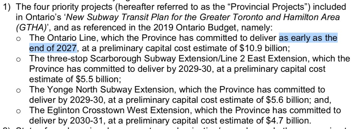

Looks like Sheppard is out of the question now.
It's always been 2027
"As Early As The End of"
Meaning their original estimates were clearly wishful thinking.
Meaning, that they have no intention on delivering it by then. Even if they had all the plans ready to go and started building tomorrow, I'd very much doubt they'd manage to build a subway through downtown in 7 years. The Eglinton Crosstown going through a far less dense, far less complex part of the city in a relatively straight line, started construction in 2011 and won't be finished on its (already delayed) deadline in 2021. At best, they'll have a plan that's shovel ready in 2 years and there's no way they build this in 5 years. Just not going to happen. If it gets built at all, we're looking at sometime in the 2030's.
