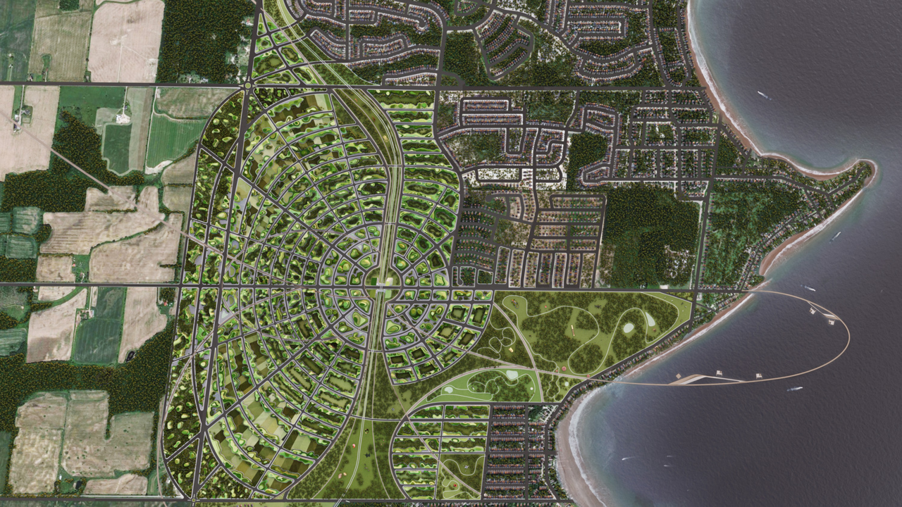

I've noticed no project pictures have been posted in this thread for posterity, only links to other pages that might go down in the future. So here are some from the Partisans webpage:

I guess it is worth calling out that the MZO only covers a 425m radius centred on the GO station, and the area beyond that, and much of what you see in the above renders, is purely conceptual. Just those innermost 3 circles. The rest will be covered by a secondary plan. The circular & radial road network is a particularly bad idea as conceived. You don't want people driving to that GO station!

I'm more concerned with how they lay the foundation for this community. I don't think having a high speed arterial running directly to the station through this community is a good idea. You can still provide car access, but maybe with a road that parallels the rail ROW (which is already a barrier anyway). Through traffic should be impossible or very inconvenient, to push it to the other two parallel concessions. I like the idea of ring roads to push the arterial roads to the perimeter of the community, enabling the area around the station to be walkable/livable, and not a highway.
