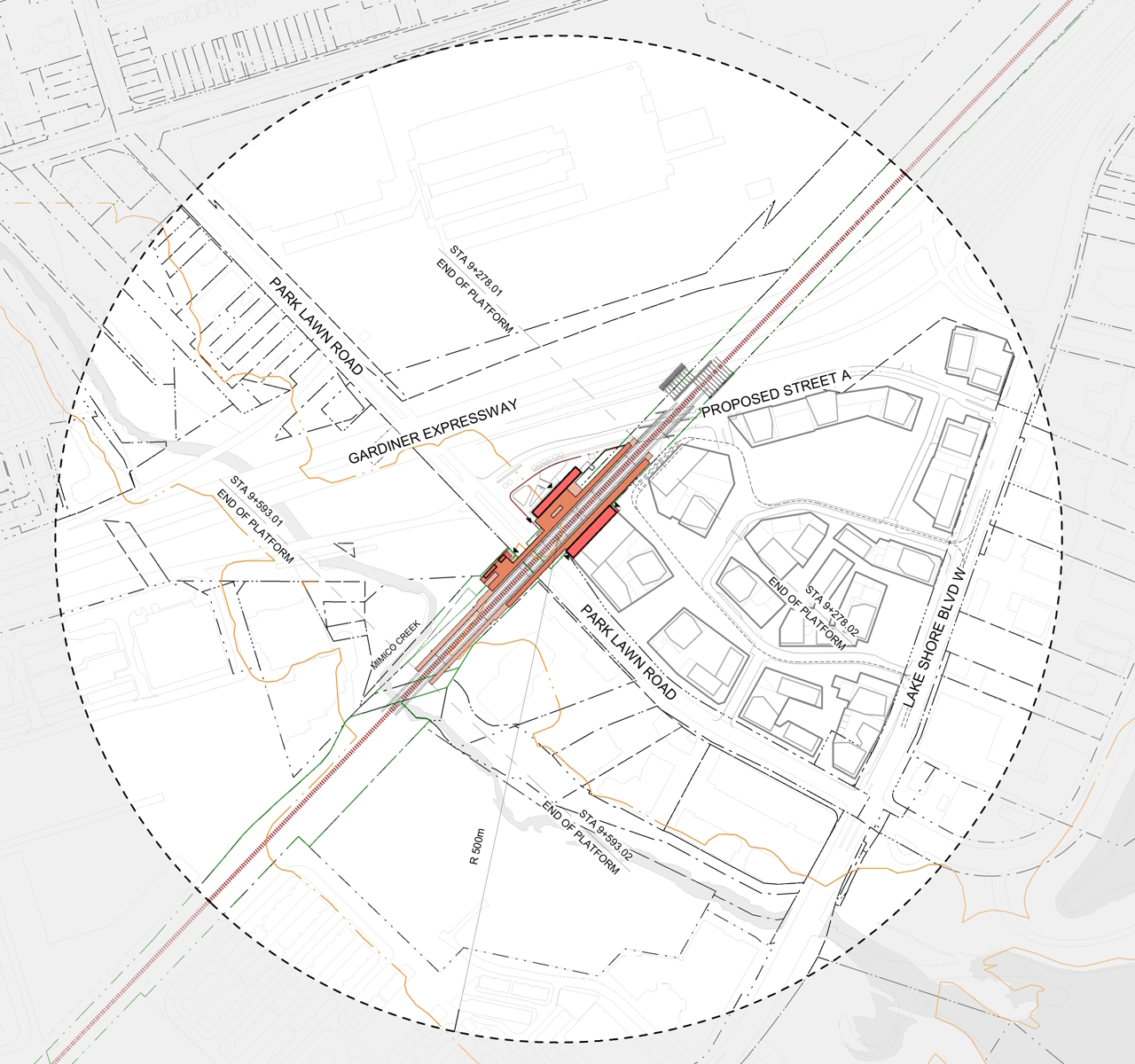

I don't have any insider knowledge about what these tracks will be used for but I'm interested that they're called out on the drawing.

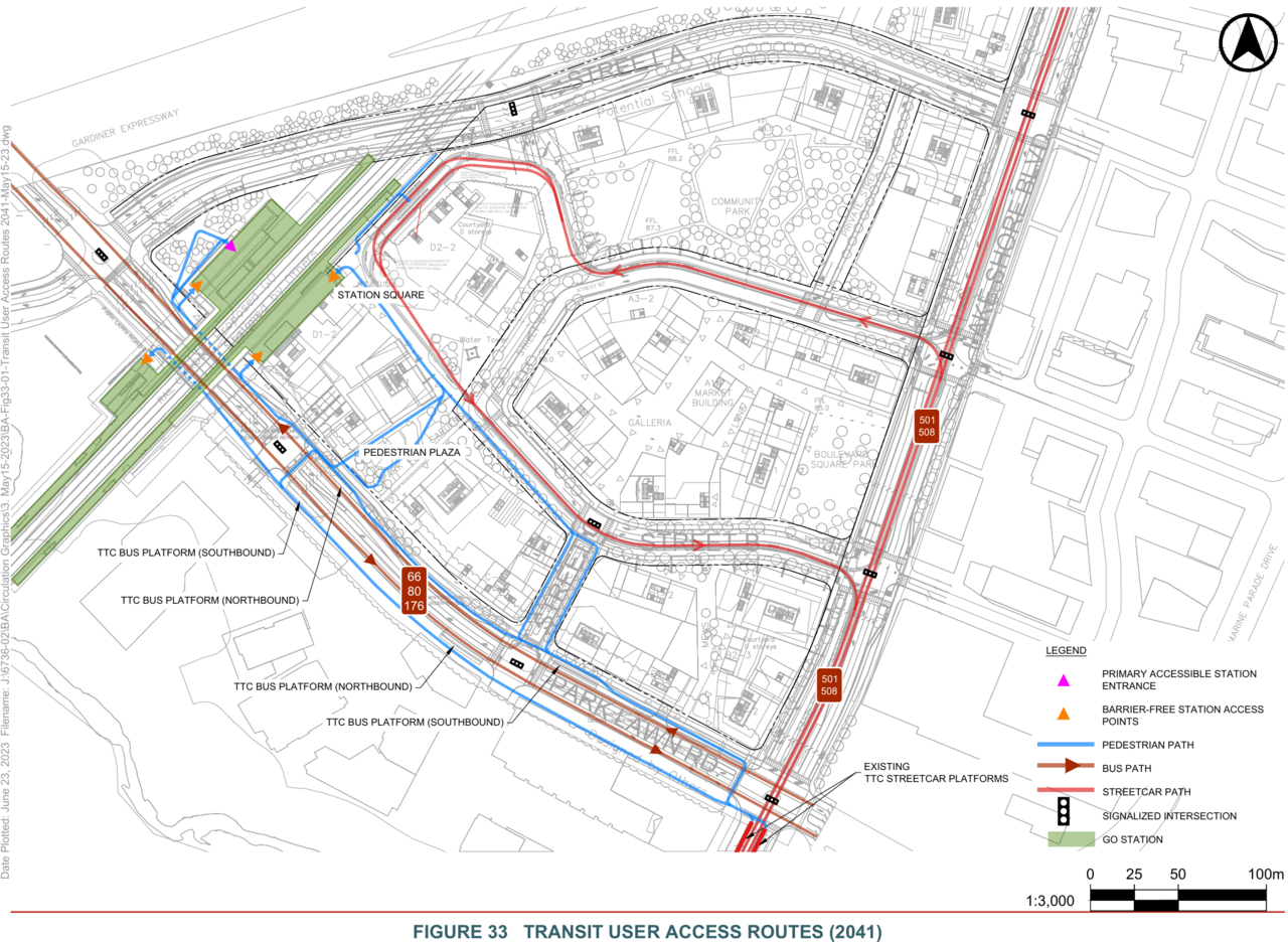

I'd say a rerouted 501 is less likely because the site plan for the Cristy development shows streetcar track leaving Lakeshore West and routing alongside the GO station's south entrance.

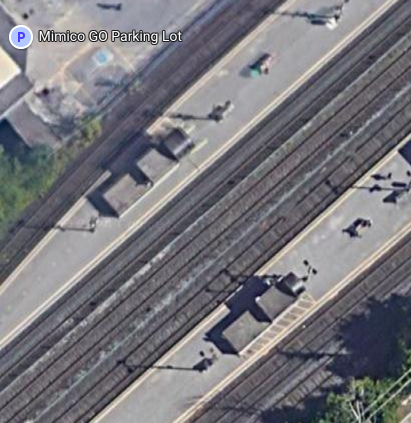

Looking at Mimico GO station (immediately west of Park Lawn) it has 6 tracks, with 4 platform faces, which could suggest these 6 tracks would be extended through Park Lawn GO in the future to provide tracks for managing entry/exit from Mimico Yard.
The platform face (PF) configuration is not the same as proposed at Park Lawn (PF-PF-T-PF-PF-T vs PF-PF-PF-T-T-PF) but that could be reconfigured I guess.

For the last 20 years, TTC has wanted to build a loop at the south-west corner of Parklawn and Lake Shore and were about to do it when the plan for Christy surface. TTC wanted to relocate the loop to meet the demand for the area as well to the west, when in fact it should be future to the west in the first place.
That loop looks DUMB. Point for potential TTC tracks.
Agreed, I could see that north platform shifted to the side of the corridor, but renders from the 327 Royal York Road entry suggest it was staying status quo. Were there any development plans published?

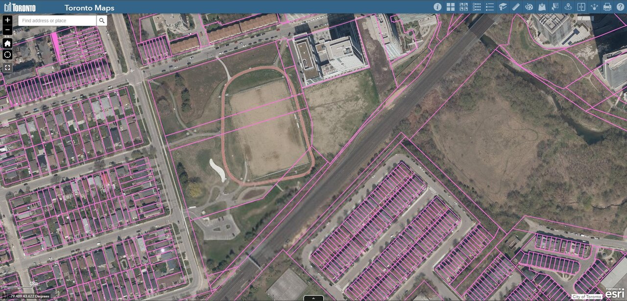

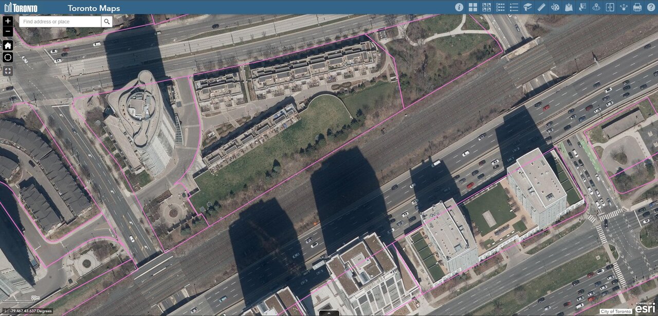

I don't see Humber River being a big problem, it looks pretty straightforward to extend the abutment. Mimico Creek may be a valid point though. I bombed through there on a walk in April 2023 and the berm on the south side is significant drop. The parcel fabric seems to show they would have enough room for it on the north side though.

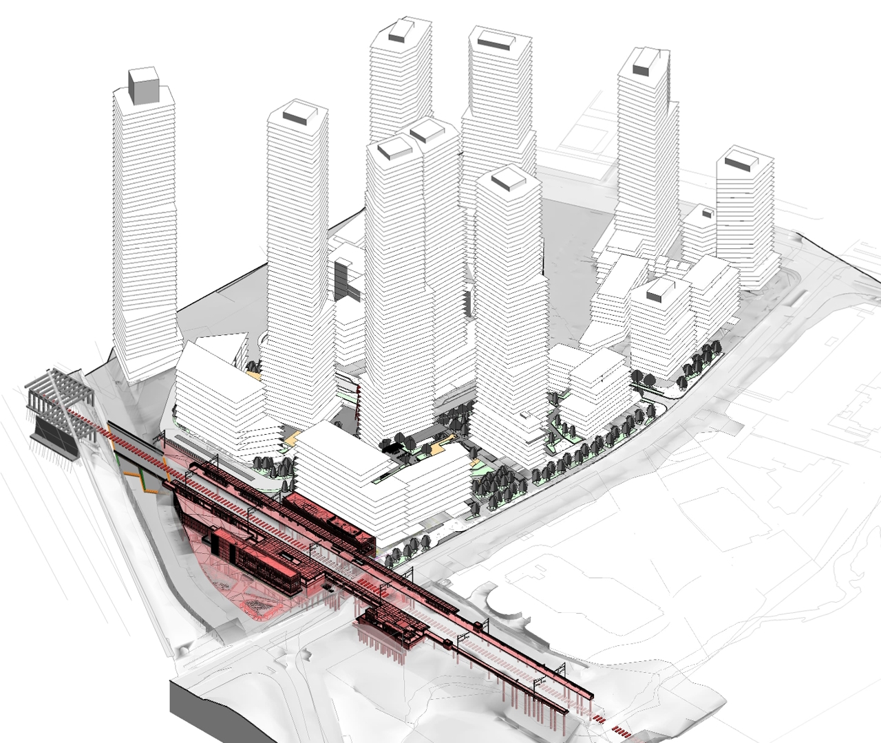

There's provision for 2 Future Tracks (with the North platform becoming an island) but I don' see any indication if these will be additional GO tracks or Ontario Line tracks.
GO's ultimate plans call for 6 tracks from Bathurst to Mimico, with the 5th track being a somewhat more short-term vision.
That design appears to complicate any option to run additional tracks thru the Gardiner underpass on the north side..... although the centre line of future tracks is shown, not much is done to rough in the necessary guideway.
