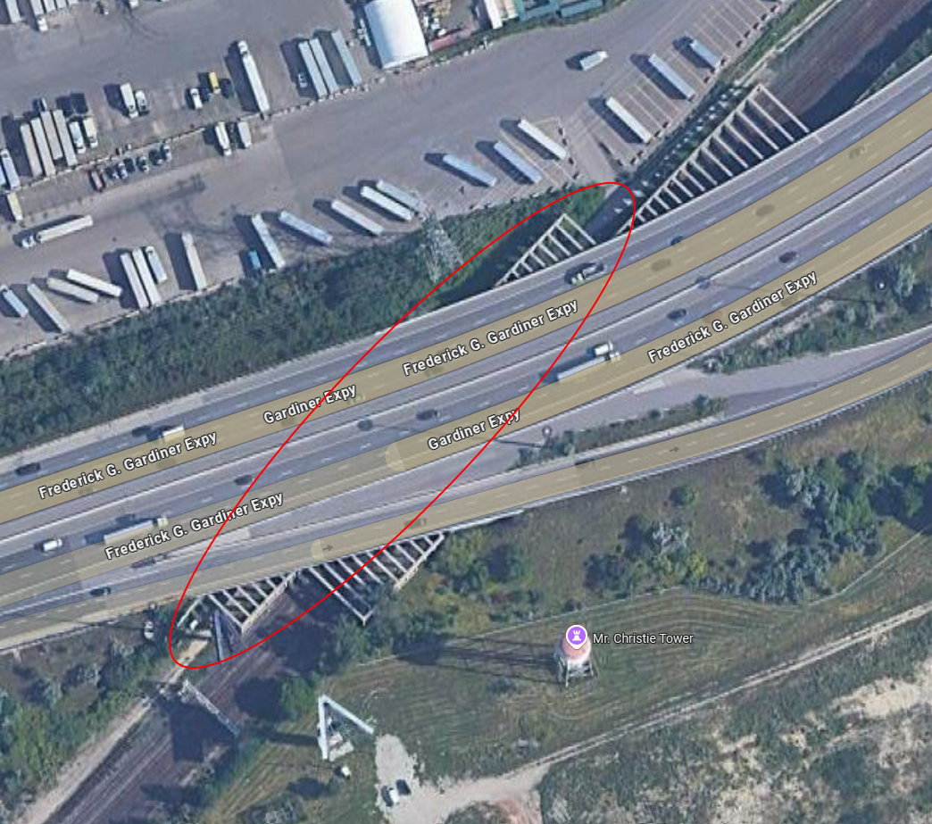

Do you mean this? How long ago was that built?
