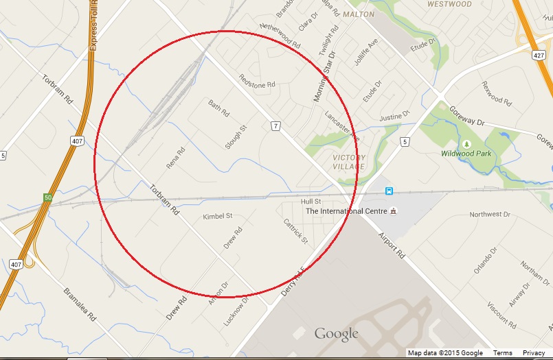

I think the area between Torbram Rd and Airport Rd circled in red would be the logical choice for an Person Rail Hub. It closest to the airport for an LINK connection, it has access to existing rail lines, especially if HSR is desired, since it would be unlikely new land for an new rail corridor would be purchased.
I don't understand the advantage of putting a rail terminal between Torbam Rd and Airport instead of just putting it at Malton ...
The area you circled would be farther for a LINK / People Mover connection than a station at Malton.
Malton is too small for an multi-rail station to handle GO, VIA and any HSR option. It's unlikely an new rail corridor will be built just for the Pearson Hub, they'll reuse existing rail corridors. Plus the fact that UPX is already serving traffic from the downtown to the airport, making any passenger traffic from Malton to Union nill.
The location I pointed out already links up with the Georgertown line, has an link with an existing rail corridor that runs parallel to the 407 going east, where new rail stations can be built and bring in passengers traffic from across the top of the city into the Pearson Hub, and it can be all linked to the airport via an dedicated elevated LRT/ICTS rail line than can run down the centre of Airtport Rd.
Everything that you said can be accomplished at Malton without any private expropriation of businesses between Torbram and Airport Road.
Malton is surrounded by parking lot. You could, quite literally, build whatever sized station that you wanted.
Malton already links up with the Georgetown corridor, as it is on the Georgetown corridor.
Given that you suggested a station between Torbram and Airport Road, your station has the same level of connection to the CN York Sub as a station at Malton would. Any theoretical trains that were to switch into your station (or Malton) would have to use the wye that is west of Torbram road to switch onto the Georgetown corridor. So really, that isn't an advantage at all.
Any LINK/ICTS rail line connecting your terminal to Pearson would be 1-2km longer than a rail terminal at Malton.
