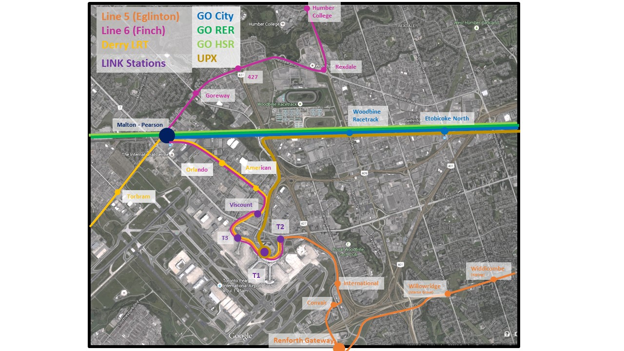

The recent posts in the last page is the most brilliant idea so far, and turns LINK into an LRT loop shared by Eglinton West LRTs and Finch West LRTs. The Finch West LRT would connect all Pearson terminals and main parking to a GO station which can also double as the VIA/HSR stop. But this is a resident led suggestion.
I almost forgot I had done that loop. The main reason I thought of it was that with the next Pier, they're going to have to extend LINK anyway, which will require a shutdown. So why not change the technology.
If you wanted to avoid the loop, you could change it to something like this.

In that map (as in real life) what purpose does that Woodbine station serve?

Actually, the loop allows LINK to continue running while LRT is under construction!
You could run LINK between Terminals 1 & 3 (or whatever future terminal configuration), while building the LRT in the opposite half of the loop.
Once finished, you'd shut down the original LINK and start running the LRT-based LINK. It would go around the opposite half of the loop while the original Terminal 1-3 LINK is replaced with LRT-based LINK.
A loop allows partial shutdown of the loop, by having vehicles go back-and-fourth instead.
You can also even have Pearson-specific LRT vehicles that stays on the loop, making it also immune to accidents/interruptions on either Finch or Crosstown. You could have a siding with extra Pearson-specific LRVs, ready to slot when Crosstown/Finch frequencies are insufficient. A good CBTC signalling system allows 2-minute headways, increasing block-slotting flexibility.
The loop is a big advantage this way, in disruption-proofing the line.

Big thumbs up to JCAM for that post. There's quite a few airports that offer free rail transit within their area...it makes you wonder how many other bog-obvious concepts we're missing? That loop could also be used for other LRT spurs.
...The loop is a big advantage this way, in disruption-proofing the line.
The Loop is an advantage in many ways, not least a break (possibly emergency) in the loop at some point still allows evacuation and access from both ends. The Loop also offers flexibility for access from another LRT leg (Miss. possibly/probably) that just won't be available to road vehicles with that degree of access.
This is one of the most original and progressive ideas in transit for Toronto region that I've seen for a while. And very low cost on the relative scale of things. With this and The Missing Link, many other ideas become so much easier, affordable and believable.
Thanks for that! So here would be the consensus best option? (p.s. GO City is SmartTrack, T2 could also have a surface bus terminal)
