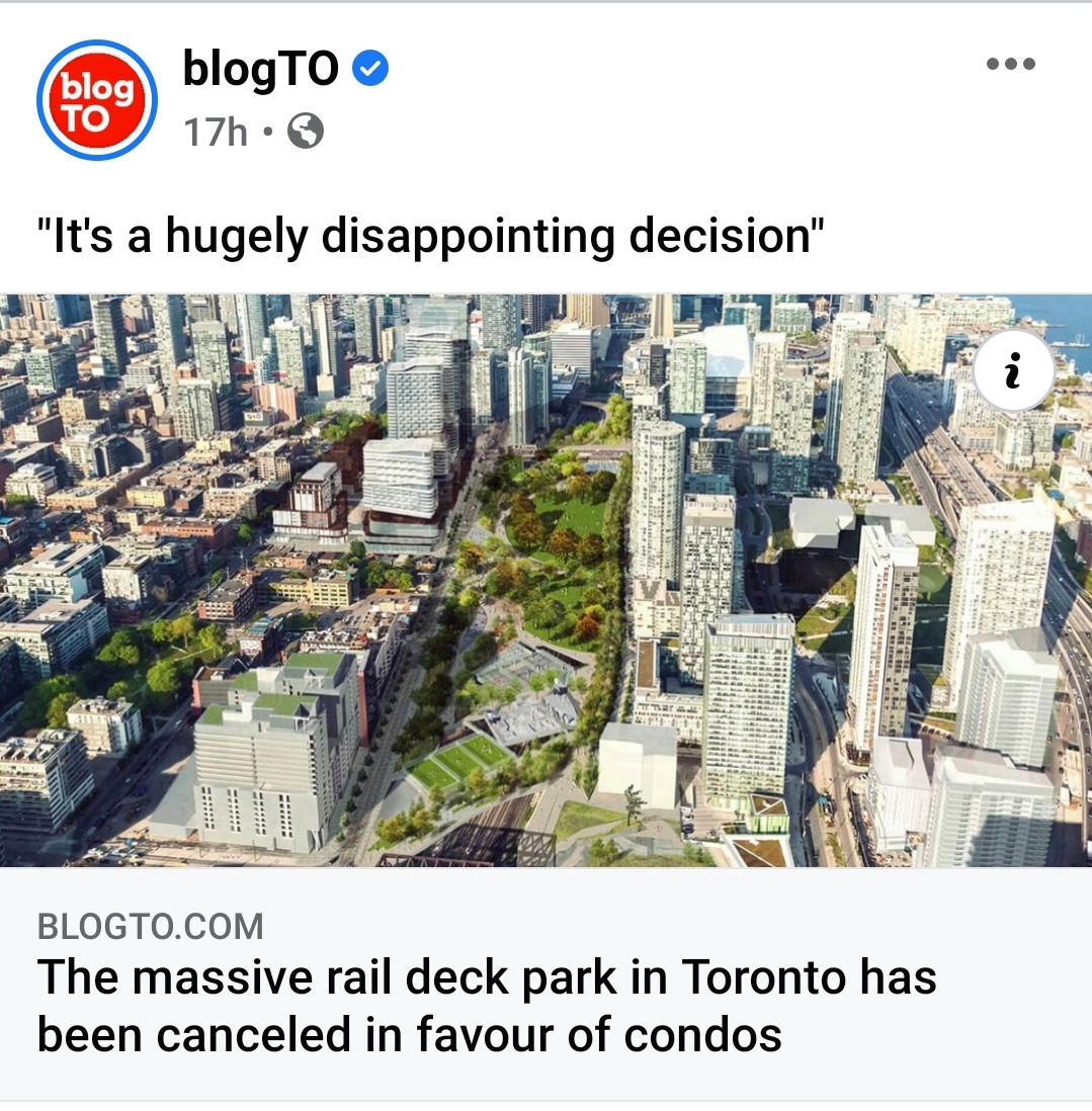

blogTO on the topic. 😀
BlogTO, always the dumbest takes. Sure is a lot of park in that picture (but, again, this is how the City has mis-represented things, as if these guys aren't including any park in their proposal. No one was ever putting high-rises over the rail tracks)!

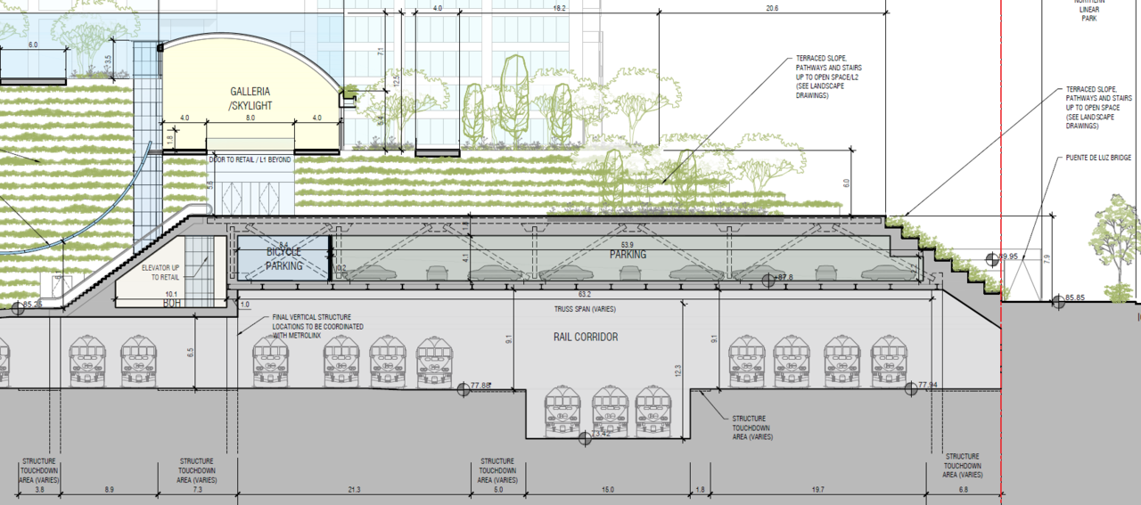

You're right in everything you say, but I was actually thinking that the park doesn't have to be so elevated above grade level if the parking level was removed.
I am probably missing something crucial engineering-wise, however.
It's been a couple of years since this was all fresh but I think you're right. For starters, I believe CN has requirements of how high off the tracks they have to be. The "cliff" they're creating along Front is the downside to that but at least as far as I recall, the parking is something they're able to do because of that; it's not that they raised the height to fit in the parking.
The idea is that the trusses to span the tracks will be high enough that between their lower extent (which has to clear the future electrical service over the tracks) and their upper extent (on which the deck can rest), there will be enough space to create a servicing and parking level. The space will be there anyway, and the buildings will have to be serviced, and as others have pointed out, zero parking for 2,500 units is not really possible yet, so… use that space between the trusses for parking.
42
This is exactly what I was trying to say earlier :)
you can see it in the cross-section below but, as said above, they're not really making space for parking so much as they are putting it within otherwise dead space in the support structure. Pretty clever, really...
