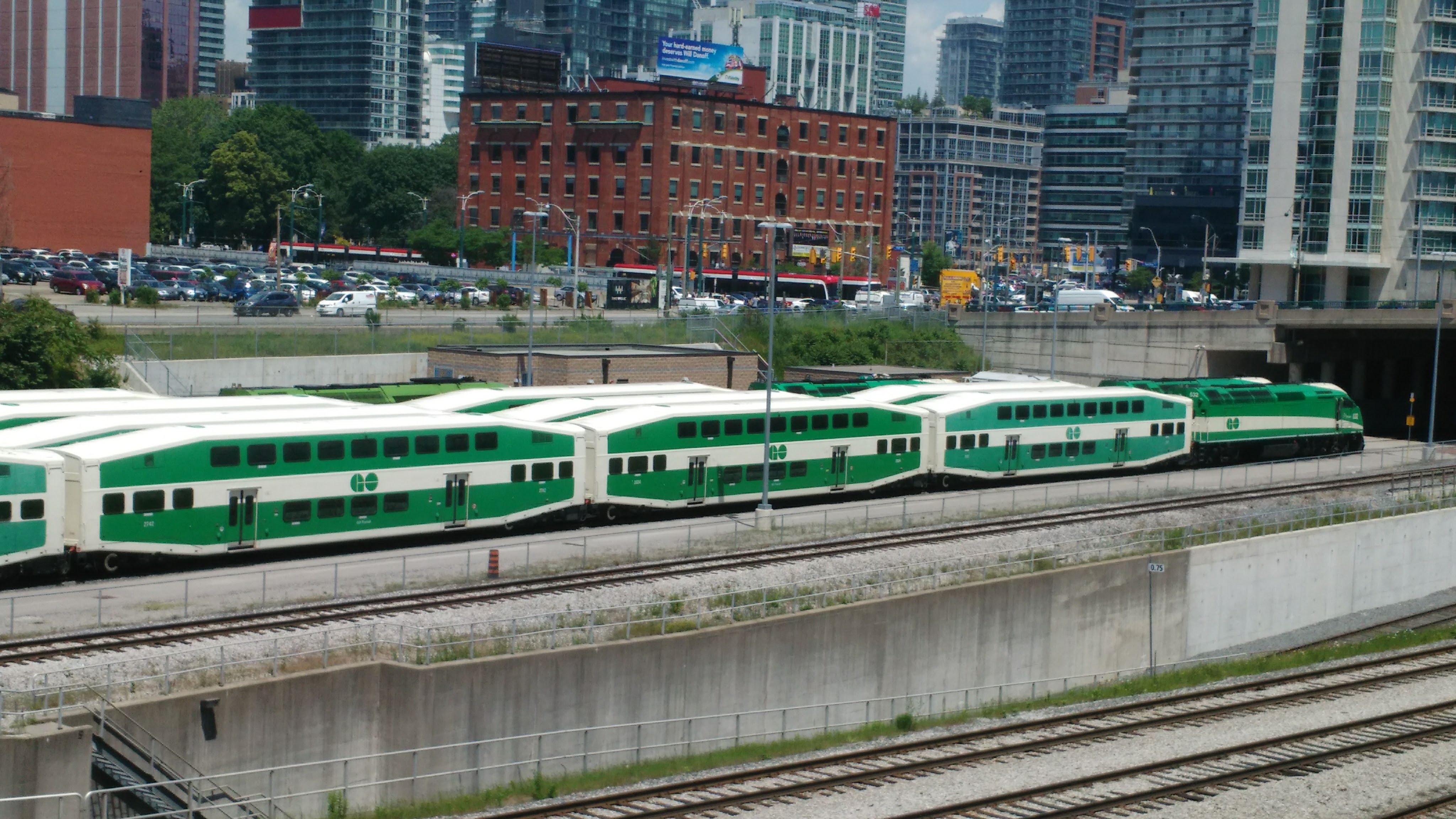

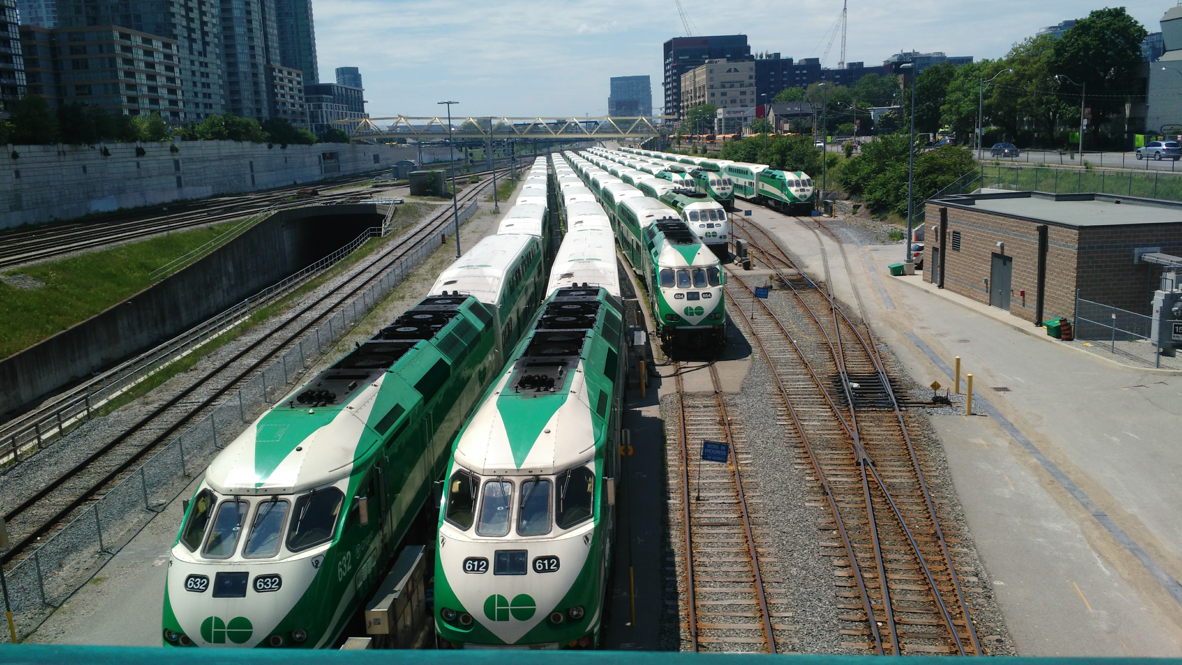

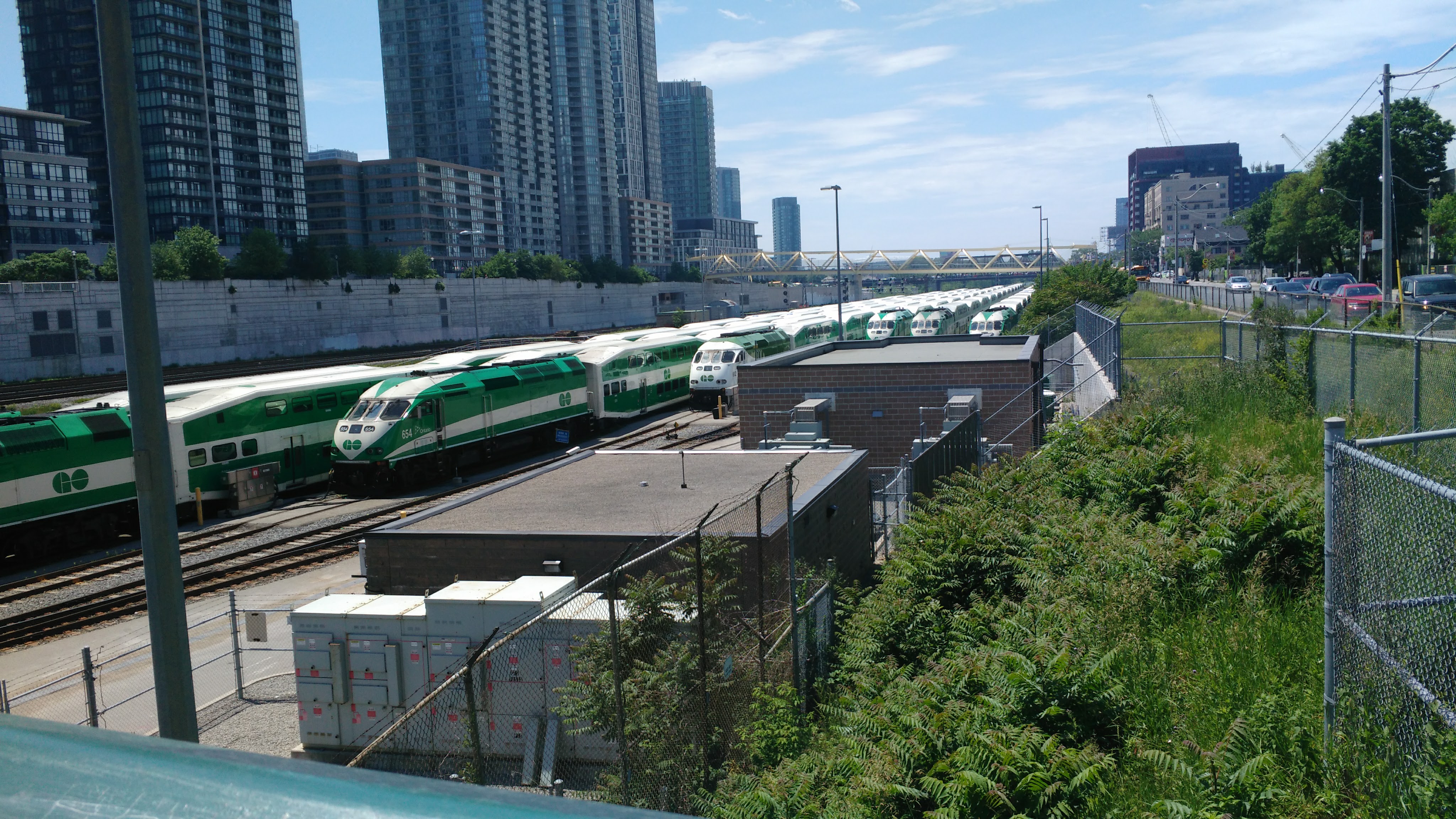

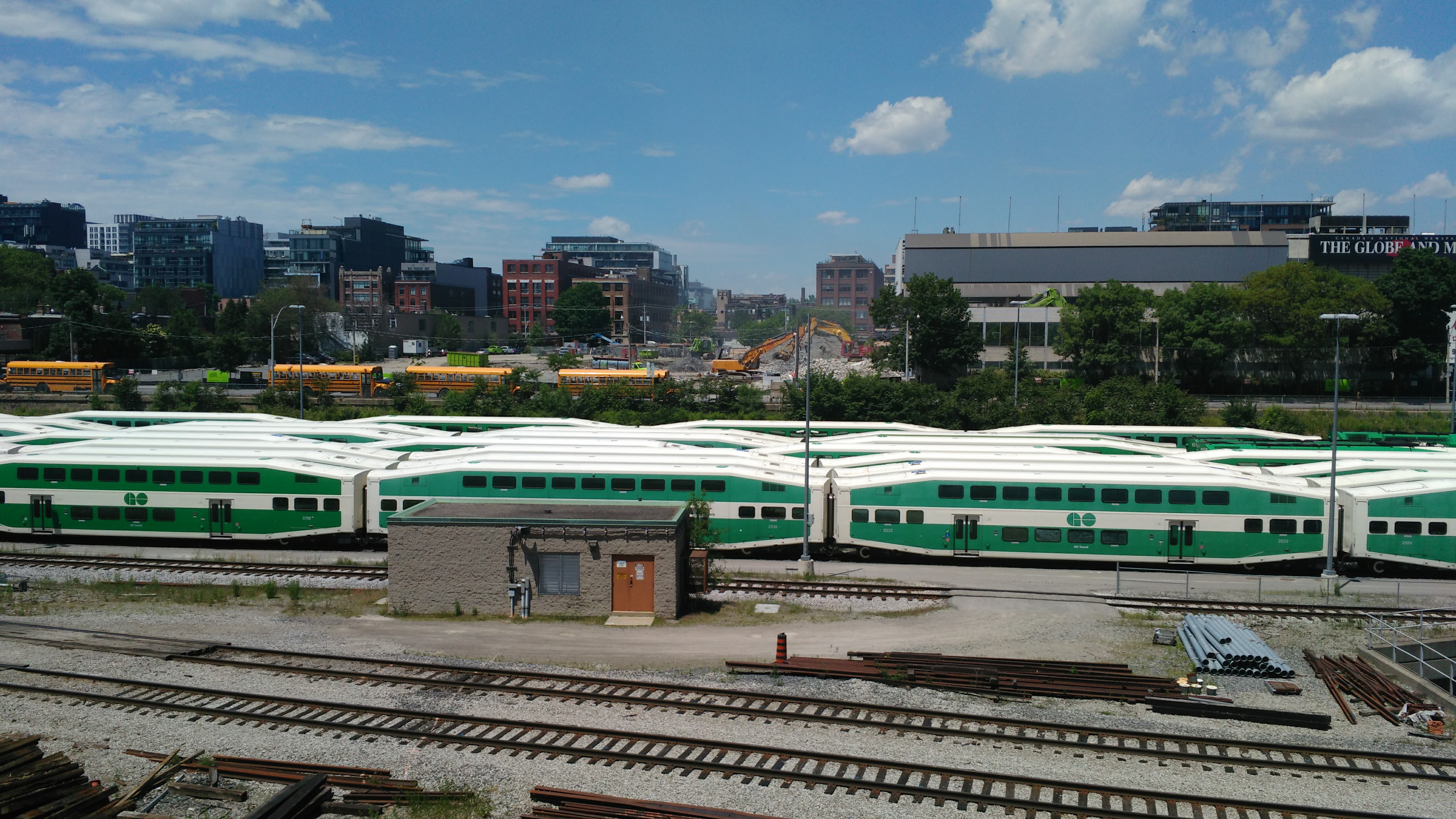

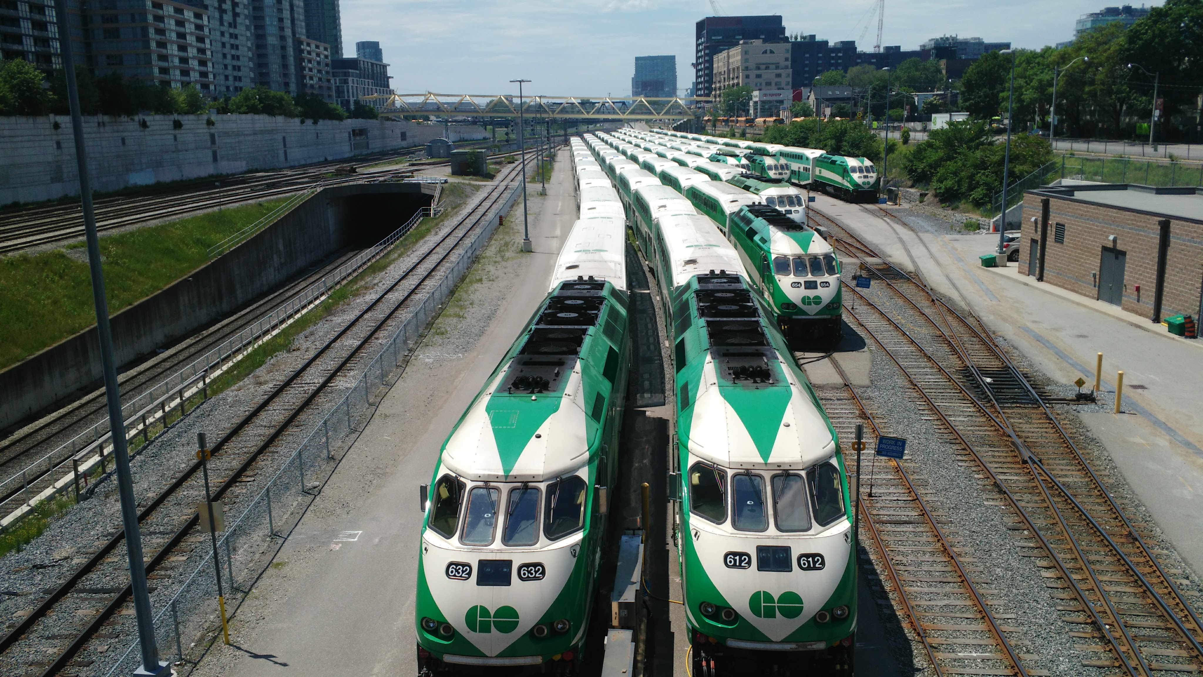

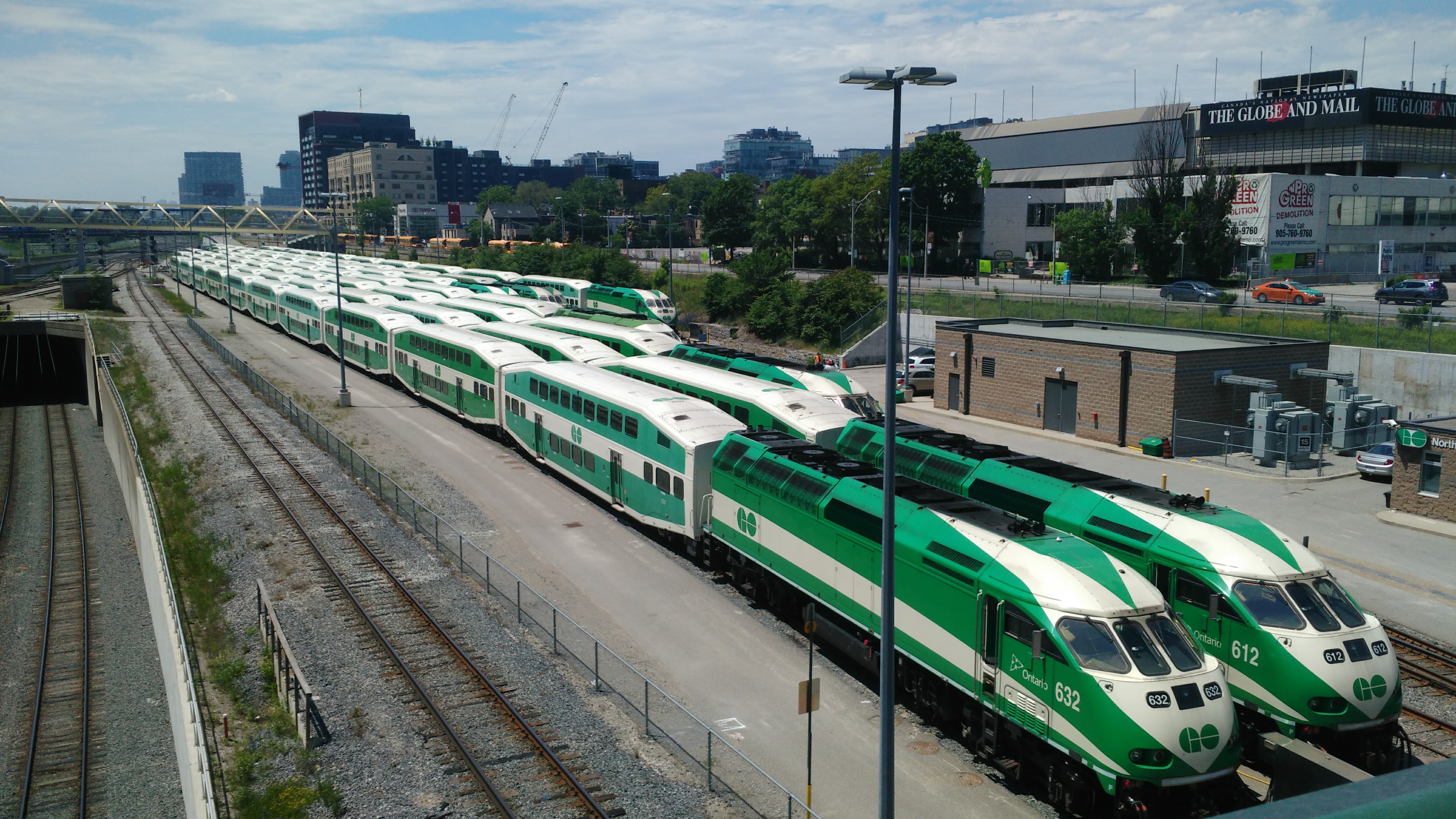

took a few photos of the corridor today (below). As far as building over the tracks, would they be able to put concrete pillars between the existing tracks of the Bathurst yard, or need to bridge 4-6 tracks? It looks tight. Also if they can use fuel cell locomotives, will this reduce the needed space above the tracks, making it easier to lower the park development? I know people were upset when they learned that the yellow ped bridge had to be so high, but I don't know if it was because of signal visibility or future RER needs.
View attachment 112041 View attachment 112042 View attachment 112043 View attachment 112044 View attachment 112045 View attachment 112046 View attachment 112047 View attachment 112048 View attachment 112049 View attachment 112050 View attachment 112051
Great pics -- and if you think that's tight, check out the rail yards that phase 2 of the Hudson Yards redevelopment will be decking over:
The American Railway Engineering and Maintenance‐of‐Way Association (AREMA) recommended clearance is about 7 metres, however, this does not accommodate the clearance required for CN/CP double-stacked freight. This pushes the minimum envelope to 8.something (my memory is failing me this morning). Even on Metrolinx-owned ROWs, this is applied. It makes sense for where local limited freight service is offered, but beyond that I didn't understand why. Perhaps it was a condition of sale.
That's why the Puente de Luz is so high. I can also tell you that there are a number of bridges that do not meet this height, and may require reconstruction for electrification. Details will likely emerge with the electrification TPAP.
