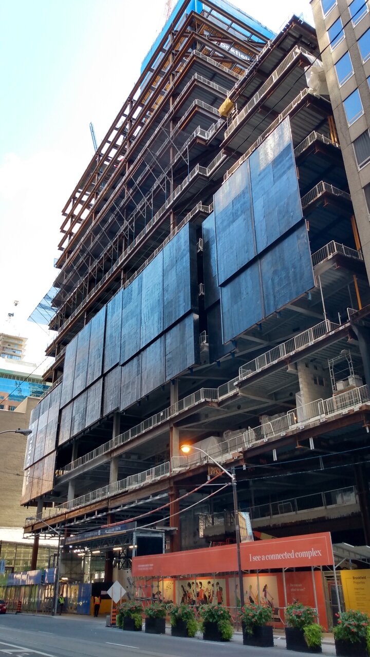

There has to be some discussion somewhere on why this project uses a core, while the taller 16 York didn't. Despite both being at 32 floors and for commercial usage. Maybe, I am missing something...
I never even thought of that. Must be the way Brookfield wanted the tower built or to keep it in line with the other two phases.

I never even though of that. Must be the way Brookfield wanted the tower built or to keep it in line with the other two phases.
Well...the problem with the "force of habbit" theory, is that they still can create the same building if they went full Roman with it like it was done for 16 York. The core process always looks more expensive to me. While I suspect it's much stronger, it's obvious that 16 York didn't need it. Making this unnecessary procedure from where I armchair sit. And as other readers pointed out below my OP on this, the building itself is nothing really special. So unless Scotia Bank is planning to move in a nuclear reactor to power their mainframe system, I can't think of any obvious reason why the devs would of gone with this method, outside of your guess.
Are you referring to the climbing core system that's in use here?
I believe I am. Correct me if I am wrong on that though.
The differing approaches to formwork can be seen in these 2 explainers
Thank you for posting those, but it appears I am not being very clear with my question...
...the inquirey is why this project is using an evelator core with a steel/iron based frame work eventually being built around it that we saw with CIBC Square, as opposed to 16 York that just used straight concrete floor plates all the way up, despite both projects being of similar floor counts and of eventual usage? I hope this makes sense.
Because they preferred steel over concrete for various financial and timing reasons.
Welp...I have notice to speed of which this is being erected. Perhaps it's the timing is the essence thing then.
Thanks for pointing out that consideration. /bows
