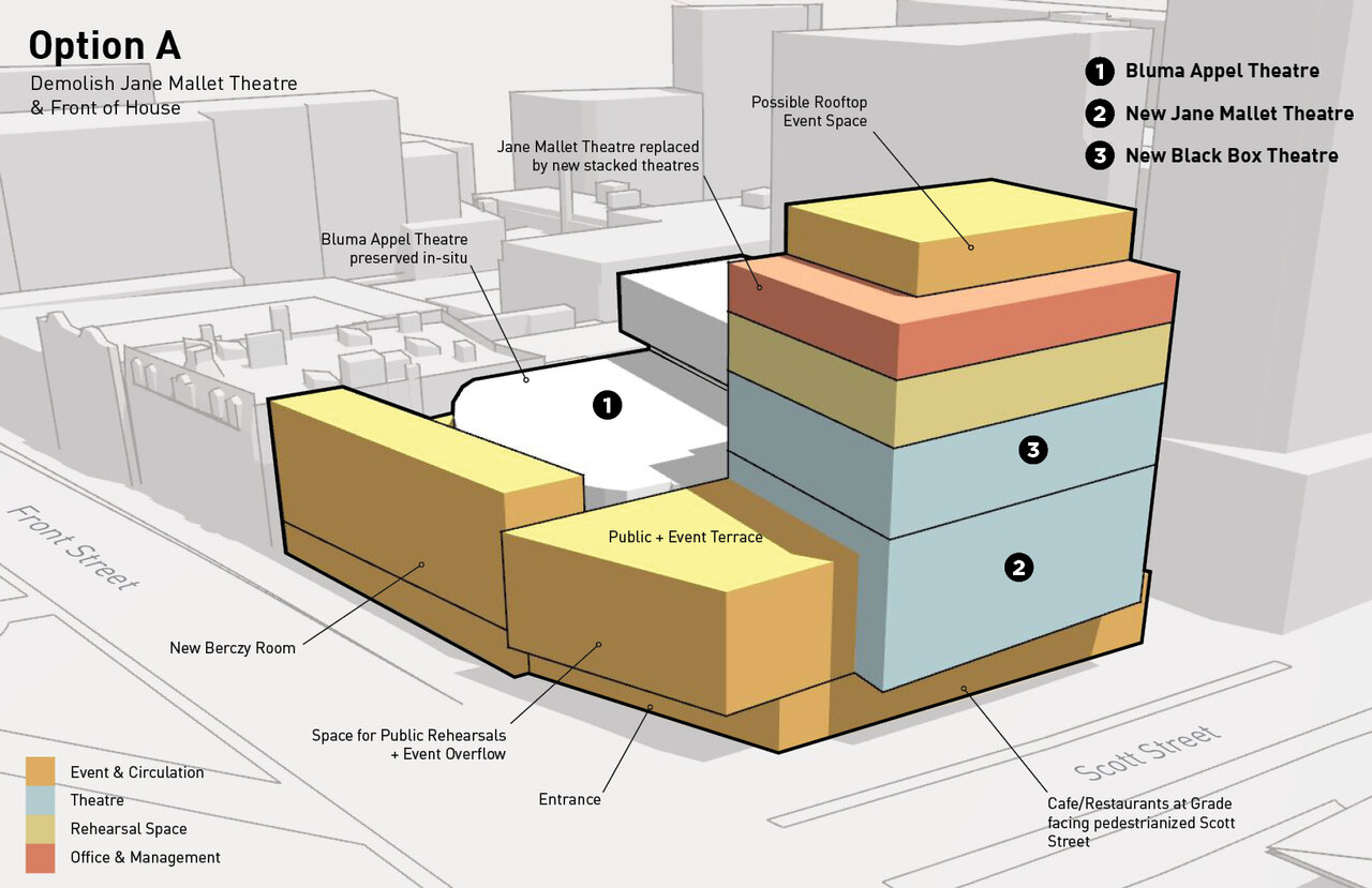

As an addendum, here are some quick massing studies done on a very rough Sketchup site plan, assembled in an afternoon to demonstrate some alternative proposals that aim to seek a middle ground. There are perhaps some real arguments to be made about not unnecessarily demolishing buildings, and as argued elsewhere, the performance spaces are perhaps the raison d'être of the building, and most valuable elements of the site. However, the current desires to preserve as much of the existing structure as possible (despite compromising the original design in the process) have perhaps clouded certain judgments and precluded some more liberating opportunities.
Style-wise, the back sides are the most interesting brutalist elements of the building, while the public front of house is of little architectural significance inside and out. As such, there should be no qualms about expunging the existing street-facing structures, but any elements that remain should be respected for what they are.
Ultimately, it has been historically noted that site constraints was what really hobbled the original building from the start and as construction is limited over the existing theatres- short of a total reconstruction- and to metaphorically cut the Gordian Knot, I believe that either demolishing the Jane Mallet Theatre or buying the building next door are the ways out of this spatial dilemma.
Option A:
The Jane Mallet Theatre and the existing front of house are demolished and rebuilt as part of an integrated development. Office, black box theatre, and rehearsal space are incorporated as part of a new stacked structure, with a new front of house facing Front Street & the O'Keefe Centre. This preserves around 50-60% of the existing structure.
Ultimately, the massing is pushed as far south as possible to reduce its impact on Berczy Park, with the brutalist elements of the Bluma Appel Theatre preserved in-situ in memory of the '67 Centennial, but not perpetuated. The Front Street frontage is raised to the height of the surrounding buildings, with an open terrace for urban spectating, and could even open onto the black box theatre for outdoor performances.

Option A:
Ultimately, the massing is pushed as far south as possible reduce its impact on Berczy Park, with the brutalist elements of the Bluma Appel Theatre preserved in-situ in memory of the '67 Centennial, but not perpetuated. The Front Street frontage is raised to the height of the surrounding buildings, with an open terrace for urban spectating.

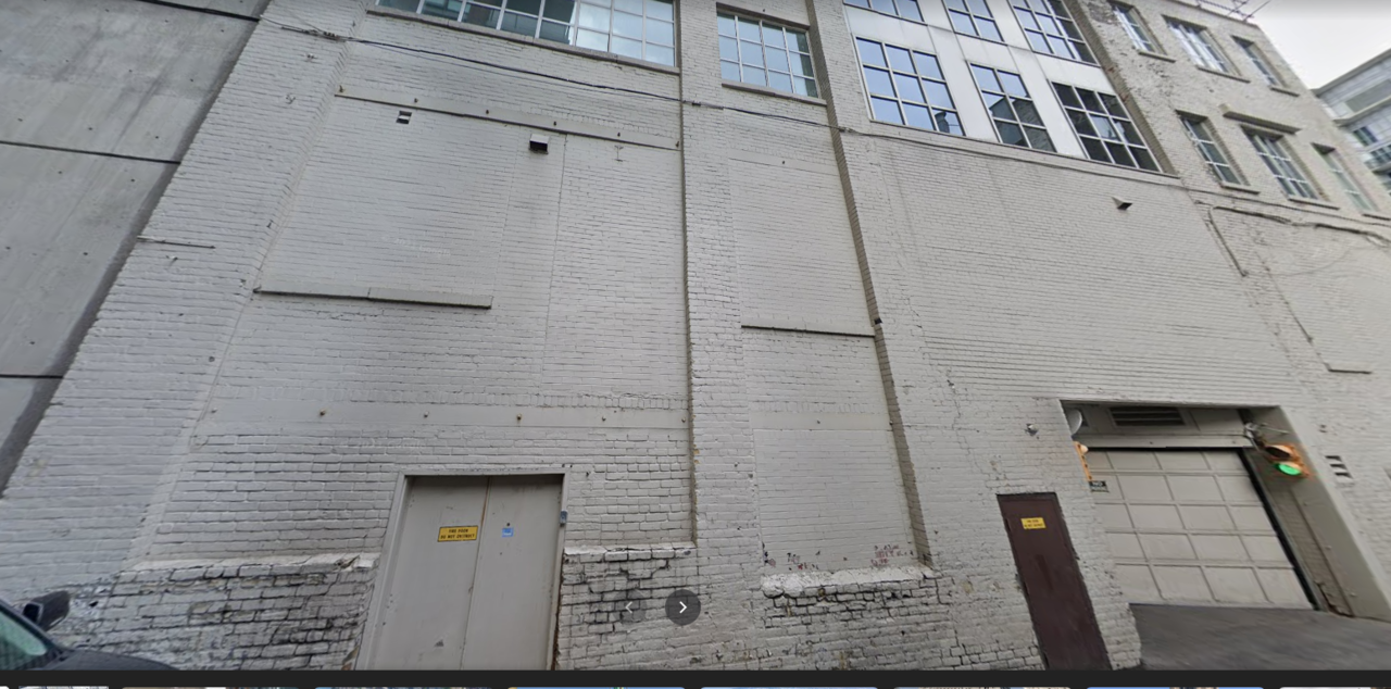

TY for those @jje1000
In your 'B' option are you proposing to maintain the entire heritage portion of the Beardmore, in its entirety?
Also, in respect of same, you note a mid 80s extension to same.
I was looking at Scott Lane......is all of this from the 80s?
In your 'B' option are you proposing to maintain the entire heritage portion of the Beardmore?
Yes, that's the portion that I believe is expendable. The upper portions appear to have been heavily altered in the 80s-90s, while the bottom portion seems to be a later extension of the original structure, and is of little architectural note. Of course, if the texture is still desired, the original brick walls can be retained, like in the Distillery District.

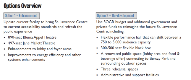

The SLCA previously explored 1 Option of minor upgrades and another of a full demolition and rebuild. What my proposal and even your massing studies show is that there is certainly a middle-ground option in between minor updates and a full demolition worth exploring at these early stages. -- So why not?
