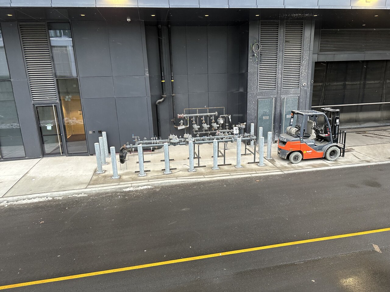

I guess this natural gas meter station is not temporary or in the interim they installed proper bollard protection. Not much room to navigate the sidewalk. They did taper the sidewalk so mobility devices can put a wheel on the road to pass. I’m guessing the designers weren’t on the same page with Enbridge for space allocation. Something like RBC on Harbour between York and Bay would have been nice. Could they elevate this, add some catwalks for service and add a wall?
This road might be back-of-house today but it will see a lot more pedestrian traffic when the Loblaws property is developed and more vehicle traffic when Harbour/Lake Shore/Downes rework is completed.

That does not seem to allow for a properly accessible sidewalk. 🤔

No, it does not.......... the requirement is for 2.1M of width unencumbered. No chance the above meets that standard.

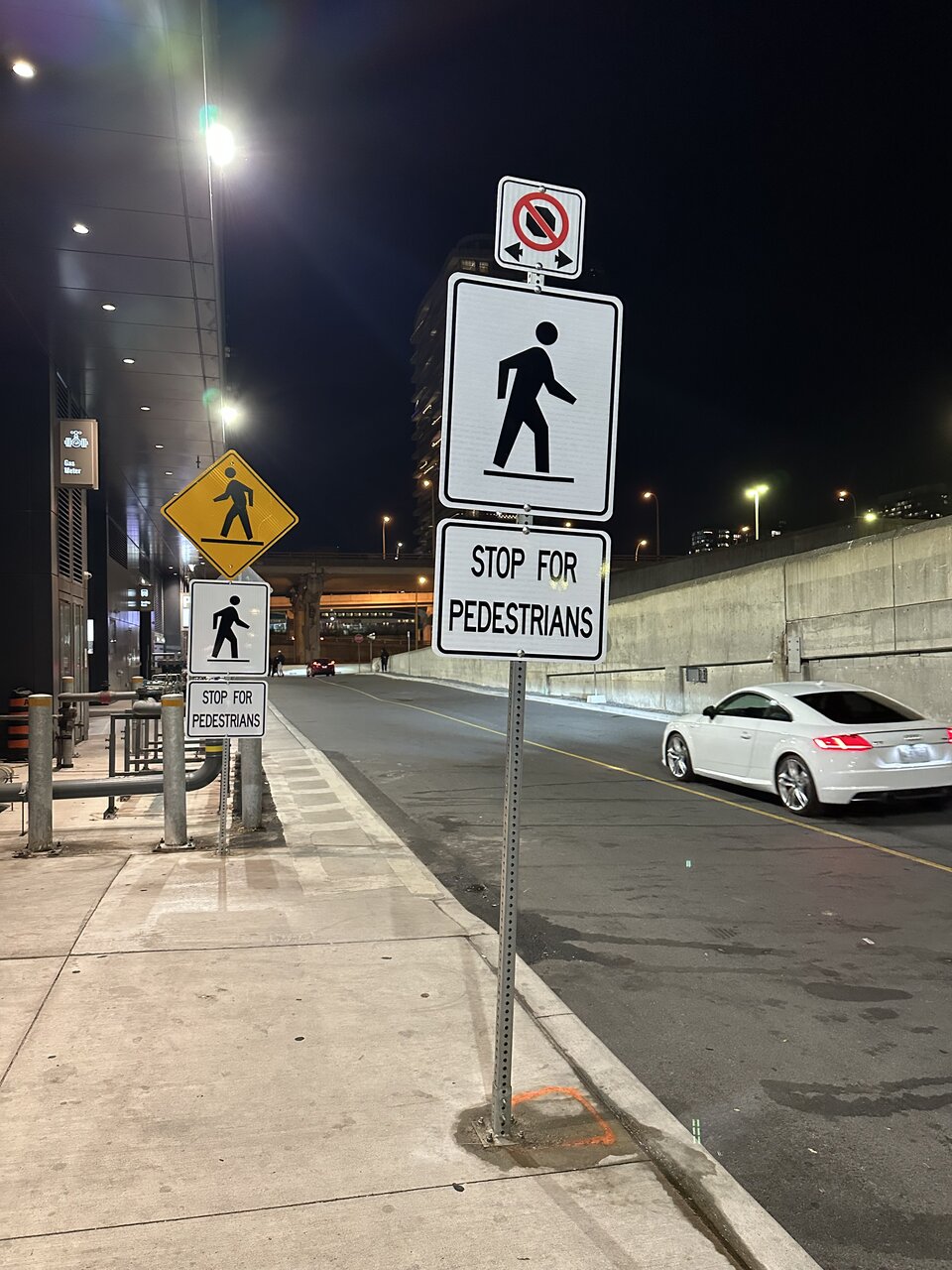

A new type of crosswalk. The lawyers must be involved in the due diligence. I’m sure others in the building have probably complained too.

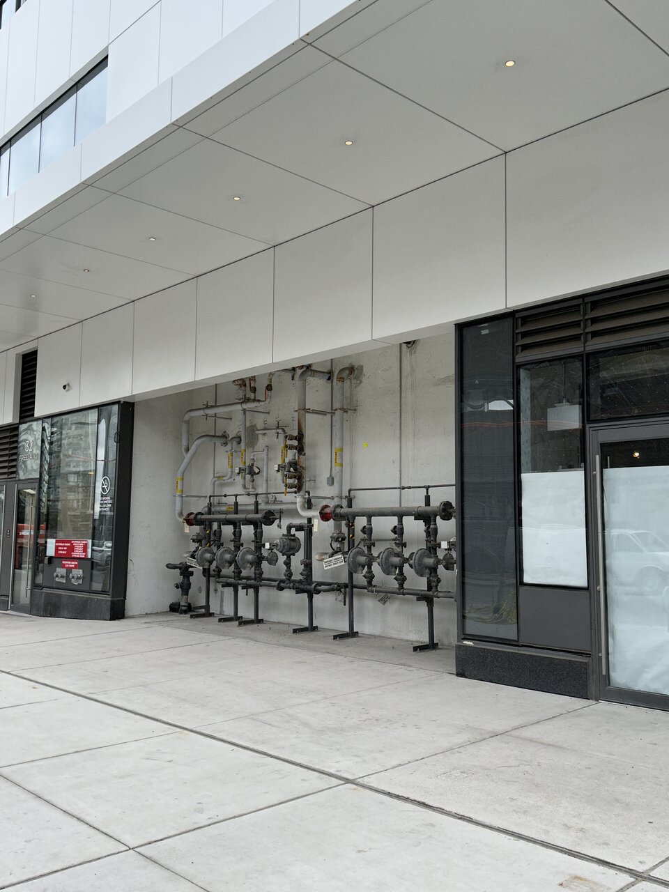

This is what Pinnacle’s gas train looks like at the first smaller building at One Yonge.
Oct 2023
Vs Sugar Wharf Jan 2023

Yes this is bizarre. Even if the street will be widened and moved a bit further east when/if Loblaws is demolished it is VERY odd and certainly not up to Code.

“This street is currently under private ownership. Ultimately, the street will be rendered to the City when the neighbouring site at Loblaws is redeveloped. That will allow for the sidewalks and road area to be increased according to the precinct plan for the area. There is no timeframe on that redevelopment.
Enbridge did not accept the inset that has been prepared by the developer within the building for this infrastructure.
Our office is engaging Enbridge and the developer to determine what the solution looks like.”

We’ll see what happens during the first big snow fall. I guess this will get some extra attention.
