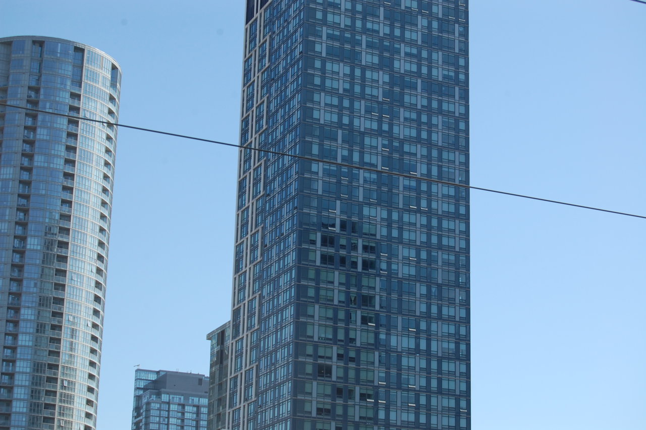

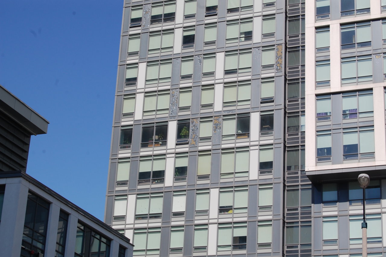

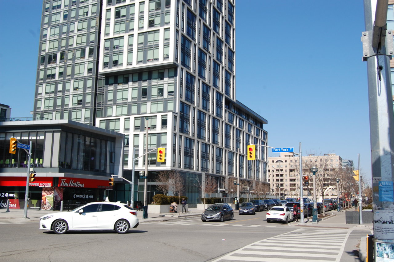

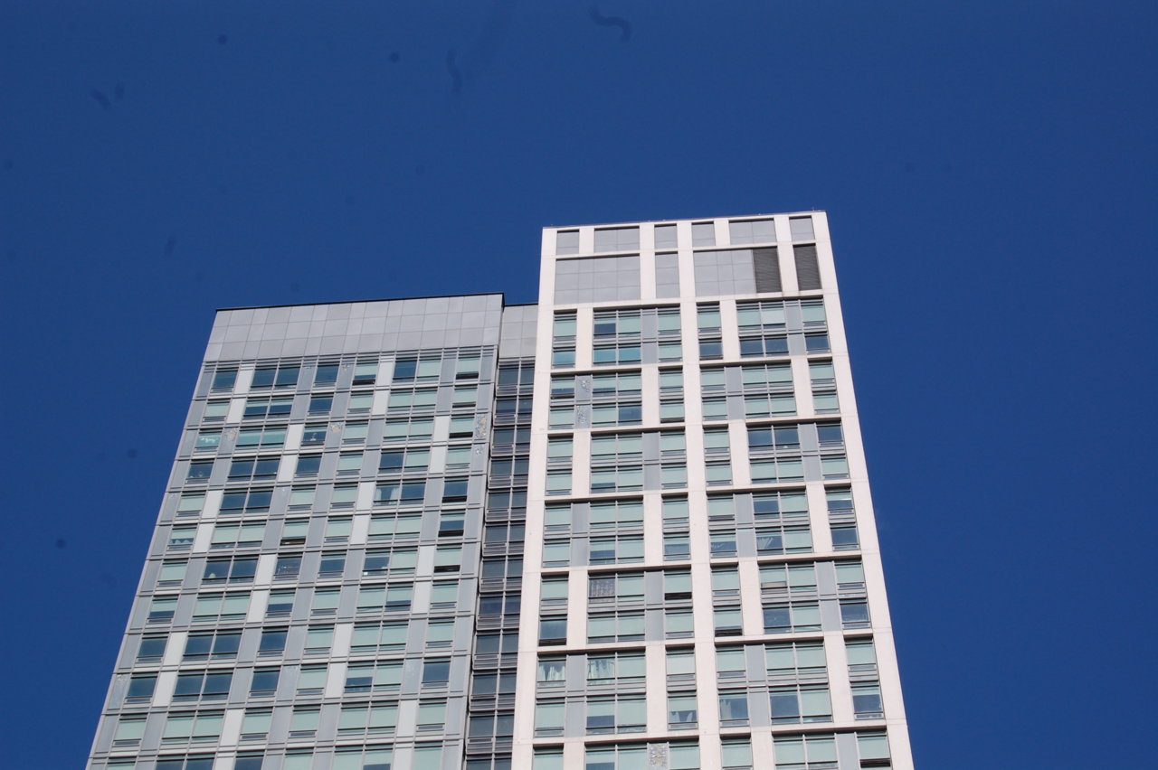

Hm. Looks like elevators are not the only problem here. When I was walking through CityPlace on Sunday I was taking a look at this tower and noticed something kind of concerning - the spandrel, specifically the grey spandrel, is failing at an alarming rate. Can't really see it in this broad picture, but take a look at some zoomed-in shots below:
Holy crap that’s bad. Hopefully whichever window wall company / supplier responsible for those panels didn’t use them on many other projects around town or we’re in trouble.
Yikes. You have to think we're going to be seeing A LOT of this all over the city the next few decades.
