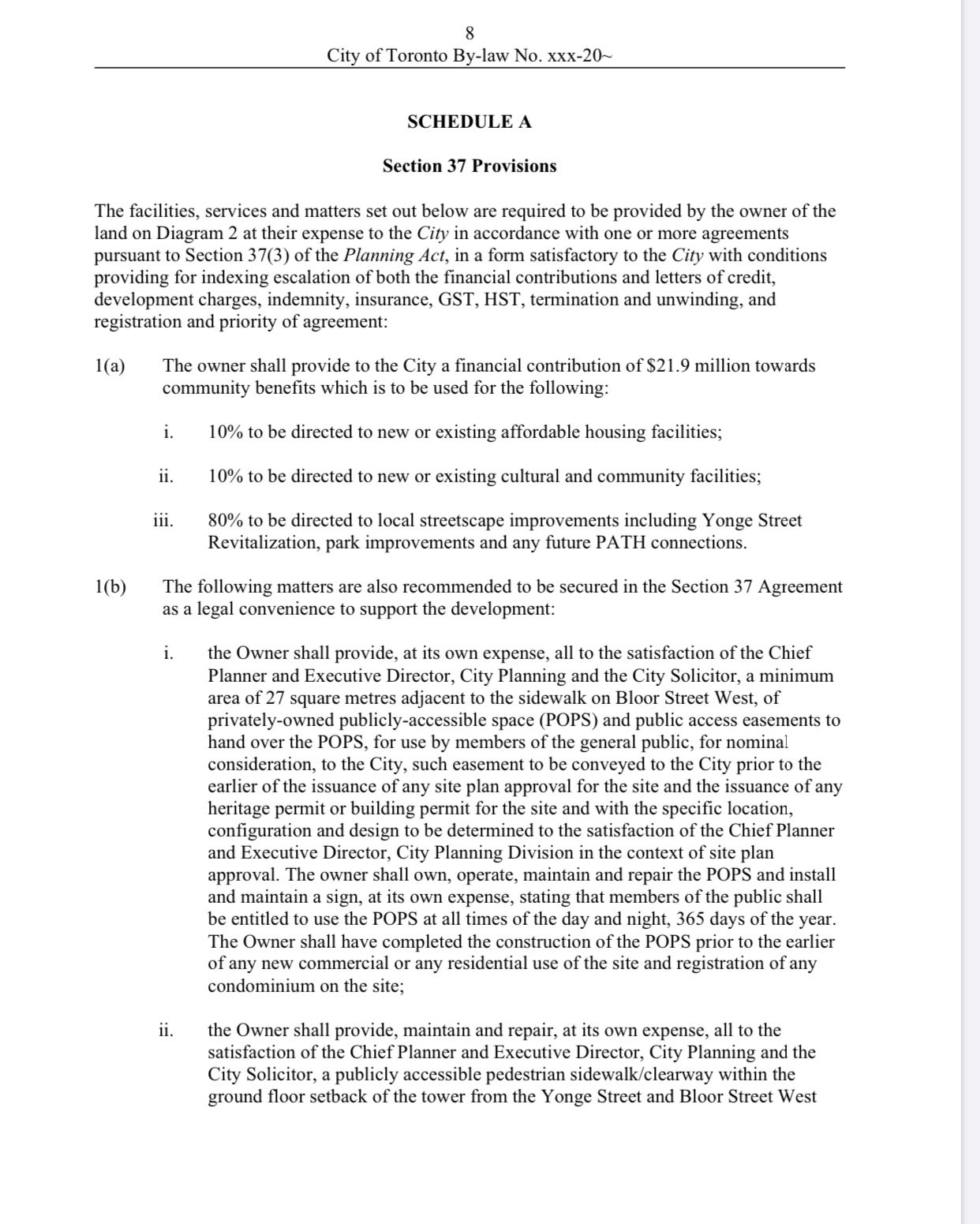

Here’s the breakdown and the other draft S. 37 conditions, as shown in the draft ZBLA submitted by the applicant, in the Nov. 2019 zoning resubmission.
I was also looking at the draft zoning diagrams. This building is absolutely shrink-wrapped.
Thanks for posting. Who comes up with the $21.9M figure? Seems excessive.
The determination of these payments is made by City Staff and the local Councillor - some Councillors are better at negotiating them than others and some developers ask for more variations than others so expect to pay more.
For some positive info; at the time that councillor would have been KWT. And it’s completely fair. Give back to the community you’re in when you add traffic, take away sunlight and make 3-5 years a noise and pedestrian nightmare. Section 37 is one of the best things the city’s done, IMO.

There is no formula. In fact under the law there cannot be a formula. The City has guidance but not hard rules. It is negotiated site by site, councillor by councillor, applicant by applicant.
True, but some Councillors certainly have an informal formula to detrrmibe the ask.

Of course, many s37 funds are actually assigned to building or improving affordable housing! In this case 10%.
