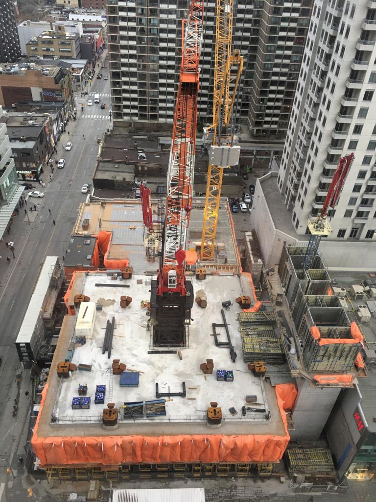

Found something to substantiate my last point regarding the extra 2 hanger sections in the older renders. But they do have 12 floors and not 9 floors like the new proposal. This is from the diagram on Skyscraperpage by @Koops65. The design was changed shortly after that to what we have currently. The height of the older, taller design is around 341m vs the current 308.6m.
