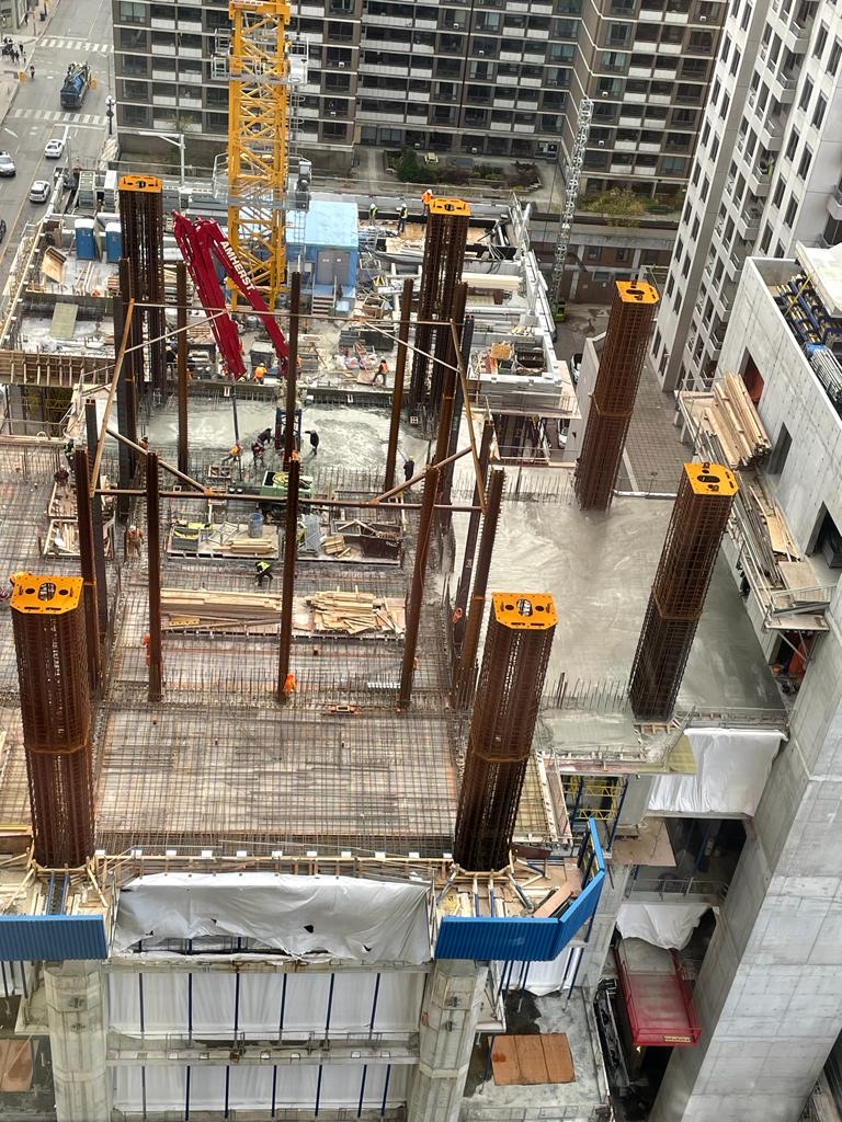

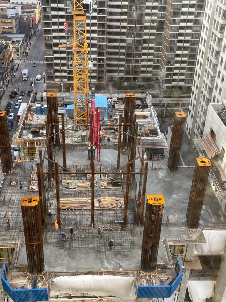

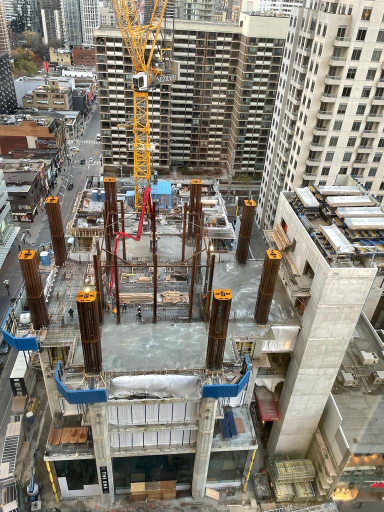

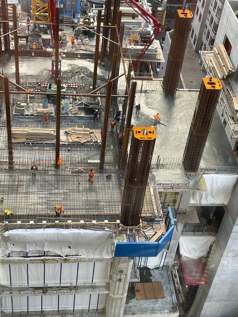

If you look at the corner of the slab just above the post you can see the imbedded bracket attachment pieces on all the corners that the diagonal supports will attach. If you look at post 10,917 and look at the second photo you will also see the imbedded attachment brackets on the columns where the diagonal brackets will attach.
The missing corners of the slabs will be poured after the diagonal brackets are installed, you can also see on the photos that the edge of the concrete is keyed on every floor.

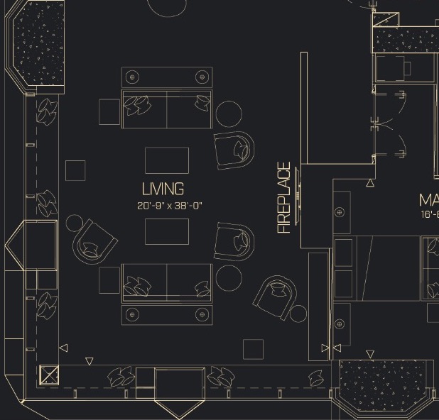

Actually, there are columns on the corners that tie in with the hanger supports. Here is a snippet from the architectural drawings of Level 7:
At this level, the hanger supports are around halfway between the super-columns and the corners, but as you can see, there is a small corner support column on all four corners (marked in blue) that provides the vertical support to the upper floors that is transferred to the hanger supports.

Checked a bunch of corner unit floor plans (including penthouses) and all also show a small corner support column (inset from exterior glazing) which suggests there's been a bit of hyperbole about the exoskeleton yielding interior "glass to glass" corner views... unlike this rendering, glass might meet glass on the outside, but it certainly seems there will actually be a vertical column gracing the corner of the suites (so I want my downpayment back).
I stand corrected...thank you. I did remember not seeing them in the render, but didn't do my due diligence in checking the plans.
