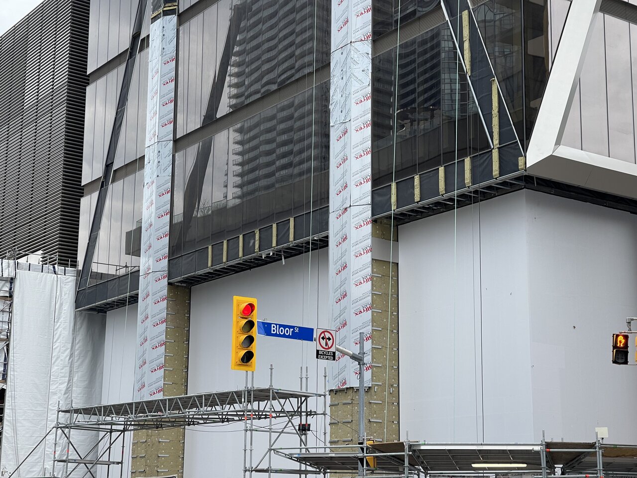

Strangely, the spotlights don't seem to be installed yet... I'm curious if that's something that will come later or if they've been nixed? in the UT Article this photo is from it sounded like they were a pre-fixed element.

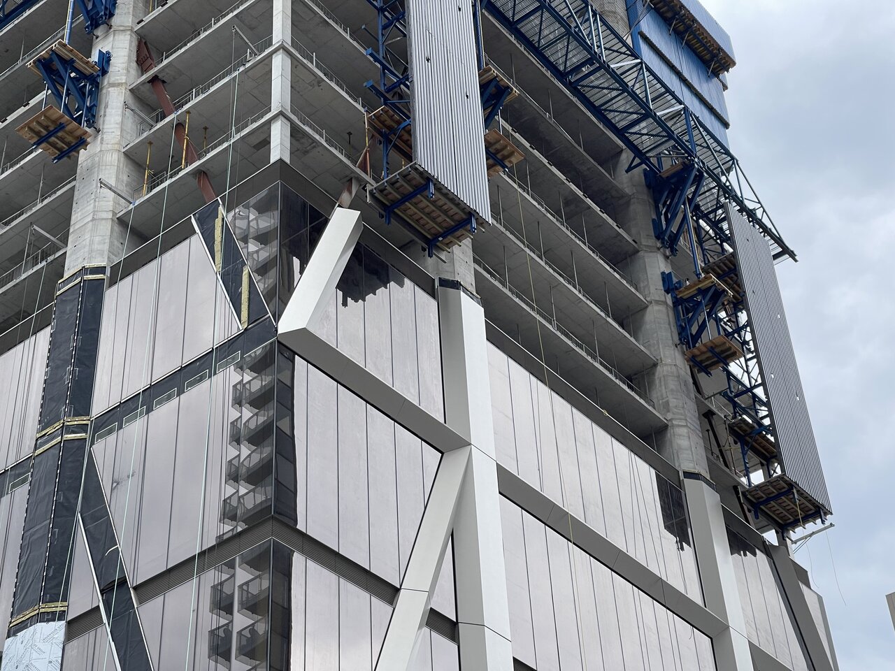

Can someone kindly explain what the blue bridge like structures are for that they have attached to what looks like two sides of the building so far? Apologies if I missed this post if it was already made.
I will wager they have been nixed...as not only are the lights don't appear to be coming with cladding, there seems to be no place made so they could be attached at a later point. Unless they're planning affixing and lining up each manually, too which would be a real pain in the keister to do I'd imagine...
...as for the reasons, The City is may taken an issue with the scheme, or the developer may have decided it's too flashy and not needed, or it was proven too difficult to install or the combination thereof. I wouldn't say cheapening out, as no other expense is being sparred here from what I am seeing so far. But yeah, it's not looking promising for the lights, for good or bad...unless I've missed something here.

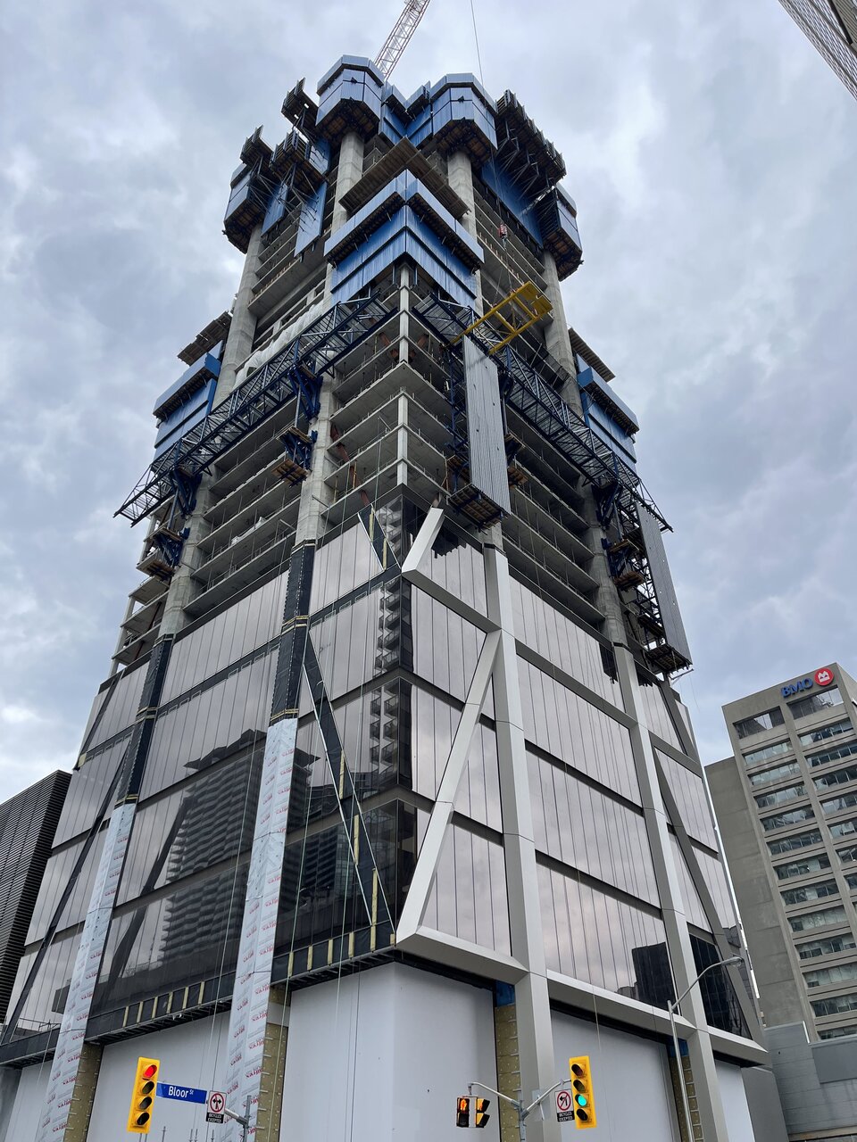

I believe that blue bridge like structure is the climbing form to install the cladding.
It's supposed to go up and they install the curtain wall and the super column and hangar sections on the lower levels as they climb.
My understanding is that because they want to open the retail section ahead of time, they can't be lifting the cladding from the ground level. This system allows them to work on multiple floors at the same time, with the cladding being brought from the inside through the elevator.
I'm by no means knowledgeable in this matter, so please someone correct me if I'm wrong.
Also possible that buyers objected to the lighting scheme. Or maybe it will start above the hotel floors. Who knows.
Thank you very much! Such a fascinating piece of engineering.
