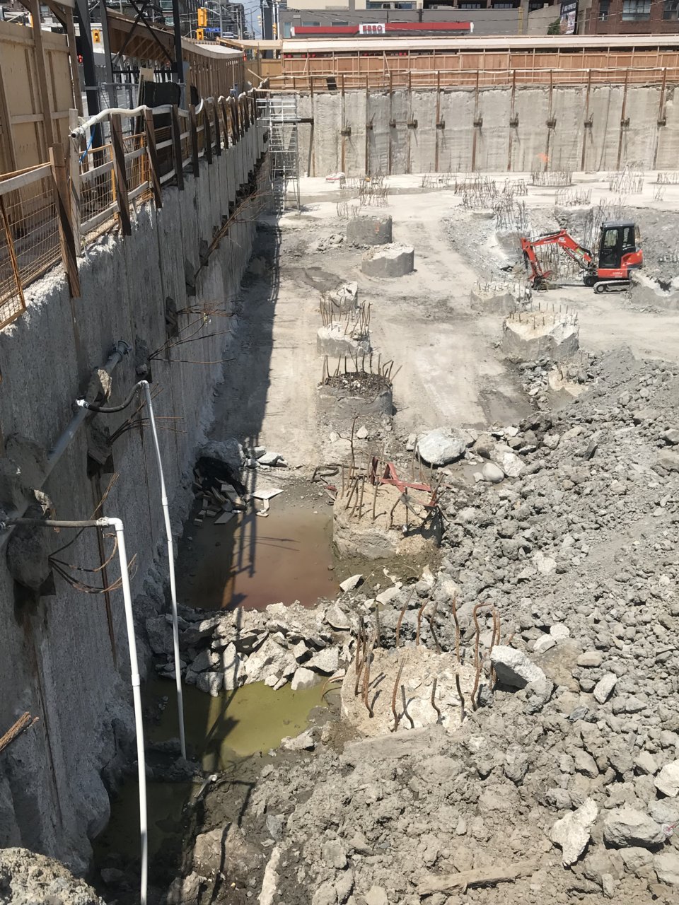

I would say by the looks of this at this very moment the project will be completed for early 2021 maybe May-June
why would you say 3-4 years ? Most of the ground digging looks about complete ...
Initial appearances from evandyk's photo above may be a bit deceiving - much of what appears to be the excavated area in the southern portion of the site is actually still at street level - it is the hoarding that makes it appear to be below grade. So a lot more excavation still to be done.

If you look at the most recent pics it does show that the excavation is well below ground level, also after speaking to a few developers they advised me that once the initial excavation is complete the towers will move along much after. He did say there may be very little down throughout the winter months however 1 1/2 year does seem realistic.

As you can see from my photos, I live right above the site, and have never noticed any consistent bad smell.
