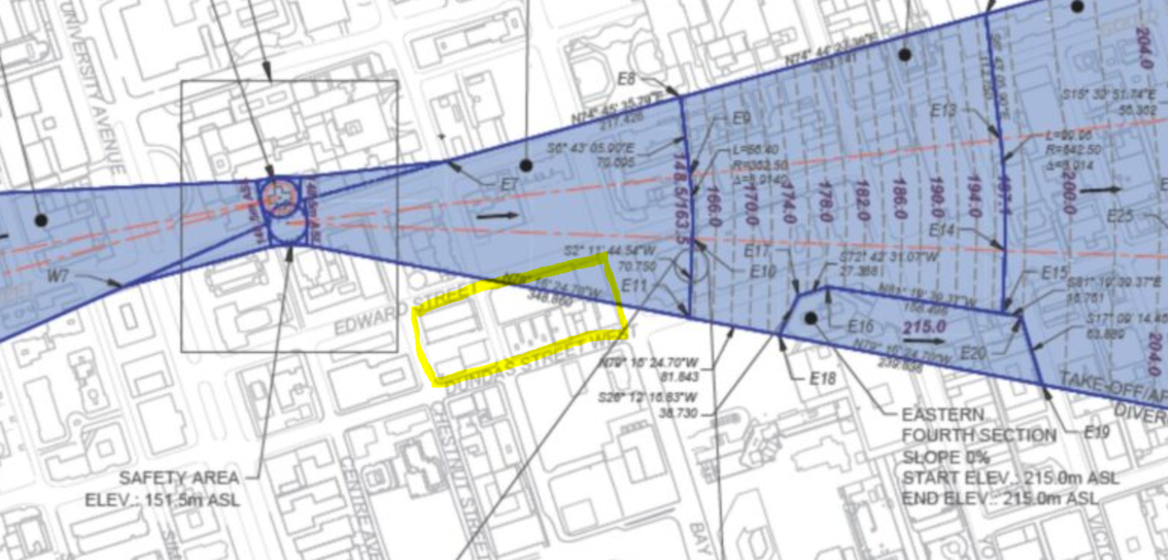

Yes, this impacts the site, and many more sites throughout downtown which need to reduce height now.
It’s my understanding that there was an incident with a helicopter at one of the hospitals that triggered the need for these changes, so it’s all for good reason.
OK, any idea on what the new HEIGHT-LIMIT on that corner is now in M or Storeys..? Thx!
It looks like the new, expanded MZO flight-paths now appear to place a serious height restriction on the BAY street parcel, directly over the old Coach Terminal...???
Can someone with a more expert eye please confirm if my "BLUE cone is now a problem" assumption is correct..??? Thx!

@TwinHuey is best placed to identify what elevation limit would apply in this section.
In terms of the site overall, obviously @Tuscani01 has identified that this is an impact, but my cautious read is that there is enough footprint left, even while not touching the Bay-side heritage to do something workable here. It just wouldn't be the same as it was previously conceived of, which likely means a delay.......
It would also be a highly irregular shape. Which UT'ers would love.....but has impacts on build costs.
Looks like it may be around 50 metres. As @Northern Light pointed out, it likely just means moving around the massing. It’s a big enough site to play around with.
Does this impact any building already approved and under construction that has not yet reached an offending height?
So far, my read is that the most conspicuous impact is on the 483 Bay proposal, which would be toast in its current form. (St. Mike's Western Approach)
So 522 University, but not The United BLDG as an example?
If 522 were under the path at its current height / articulation, yes, it would be affected. As United Bldg has a permit and is under construction, it would not.

Sorry @Northern Light, I wish I could provide some insight but my experience / knowledge is dated. All I recall is that Transport Canada required H1 heliports to have approach / departure corridors at an 8° slope extending out 625m from the helideck. No idea about the corridor width requirements.
I know this may sound a bit far fetched, but if HSC moves the heliport to the roof top of the proposed new tower, it would add approximately 17 storeys of allowable height under the approach / departure corridors.
I'd be curious to see what the approach / departure corridors look like with the helideck on the western edge of the new tower.
I would hope that slightly changing the angle of the corridors to the new tower would not result in restrictive zoning for additional properties nor would it be an issue from a flight operations perspective. Both would need to be confirmed.
