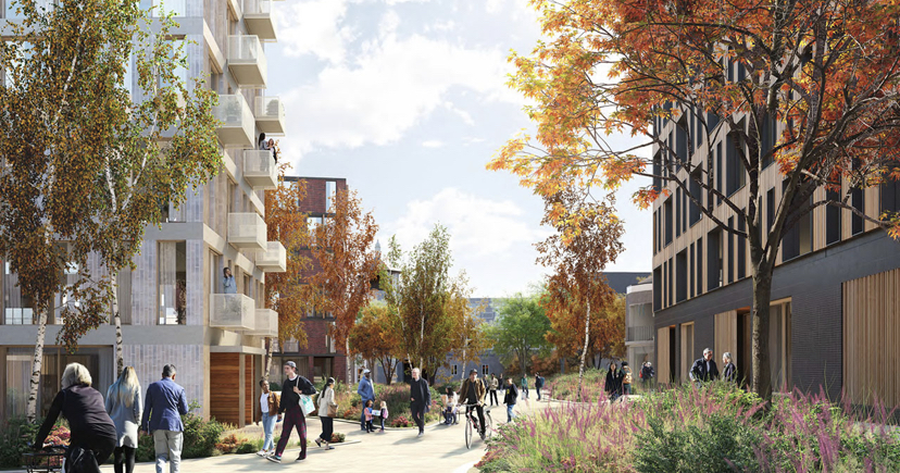

This project got shredded by the design review panel, who brought the same sort of checklist approach that @Northern Light is bringing here. (Does it animate Bayview?)
It’s too bad. The proposal’s semi-public spaces are better than any Toronto has produced in the last generation. Sometimes if specific good things are against the rules, you have to ask whether the rules are any good.
It’s too bad. The original proposal’s semi public spaces would have been better than any Toronto has produced in the last generation. Sometimes if specific good things are against the rules, you have to ask whether the rules are any good.
View attachment 376474View attachment 376473
I don't disagree that some rules are meant to be bent; or re-thought entirely.
But your posting here does not make a persuasive case.
Can I start with all the fictional trees here that wouldn't do well in the situation imagined.
I am reasonably expert on that subject; You're not likely to get that performance out of Birch in that layout.
Lets add, where's the winter image with no greenery at all?
There are lots of issues here.
I think you're taken by something of a fantasy that isn't achievable in this location.
I'm also amused by dozens of people walking where there are no shops, nowhere to go, on private property, that won't be inviting to those who live off-site.

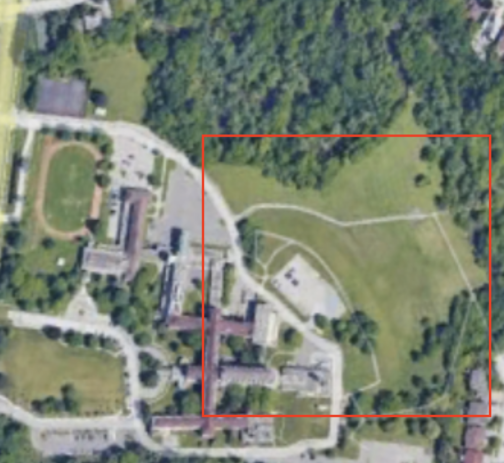

Thank you very much for the information and I appreciate you showing the topography. Now I have a more complete understanding of this site.
You're quite welcome.
I'm referring to this area.
Right, so that area is grass now, because it's privately owned.
Were it transferred to public agencies (likely the TRCA) there would almost certainly be a directive to naturalize it and forest it, in accordance w/policy.
If it remains private, then it will likely stay as it is; but it will also be private.
Edit to add, it occurs to me that others may not be clear on what is or is not 'ravine' in a legalistic policy discussion.
The TRCA has a definition which the City also uses; which is 'Stable top of bank/slope'.
What the this means in practice is that the ravine, policy-wise, is everything up to the very top of the hill. (it actually varies slightly, but there's some complex formula involved and that's the closest easy explanation I can manage)
Then, the TRCA requires a 10M buffer (33 ft) from the stable top of bank. This is both to protect from erosion, but also to allow an easy to walk path in nature for wildlife (they like walking on flat ground too).
Worth saying, in the Oak Ridges Moraine, the requirement is for a 30M buffer (100ft), which is what the TRCA wanted in the City but decided was impractical.
