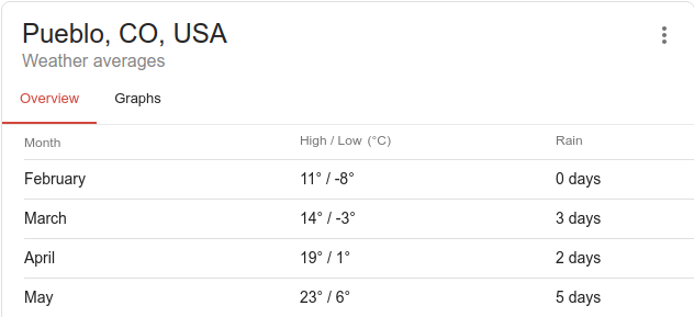

As I said. Not winter tested. Pueblo barely gets below freezing...

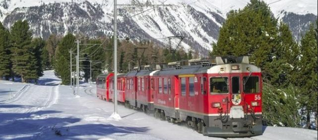

There's more, I'll detail later. Sweden and Norway run EMUs across their shared border *north of the arctic circle*! And have done for years.
lol...some day, we might find ways of doing this...
https://www.scandinavianrail.com/scenicrail/sweden/arctic-circle-train
Travel by rail around Sweden, face glued to the window, on some of Europe’s most spectacular rail journeys. You can do it on a first class ticket, or on a second-class ticket on most trains. But there is nothing second-class about the scenery though – on most routes the natural surroundings are off-the-scale seeworthy: how about speeding across the Arctic tundra under the midnight sun, or stopping off for nature walks and berry-picking on the Inlandsbana service? Couchettes in second-class are available on many routes, for instance legendary bucket-list favourite the Stockholm-Kiruna-Narvik (Norway) line.
https://rivensflowsinbeauty.com/sweden-by-rail/
